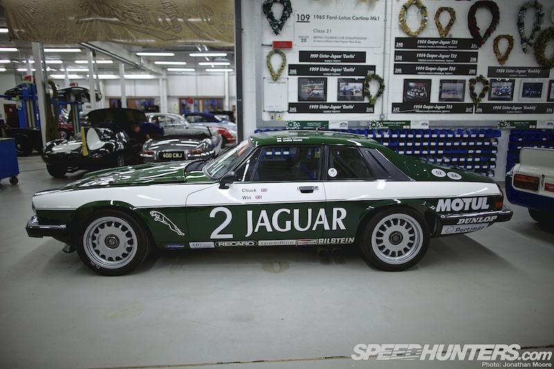

This one is owned by (and was built at TWR by) the crew chief of TWR's global ops of the time, who was in charge of the on-track operations of the XJS when they raced in the '80s.  I often catch up with him when I pop down to my folks' place, he's got some fascinating tales.
Here he is, on the right, when they came over and conquered Bathurst.
His XJR-S is a thing of beauty, and was the only one built to full-fat spec. Excluding some of the bonkers Lister creations, it's probably the ultimately spec'd XJS you will ever find.... certainly I reckon it's the most desirable factory XJS I've ever come across.

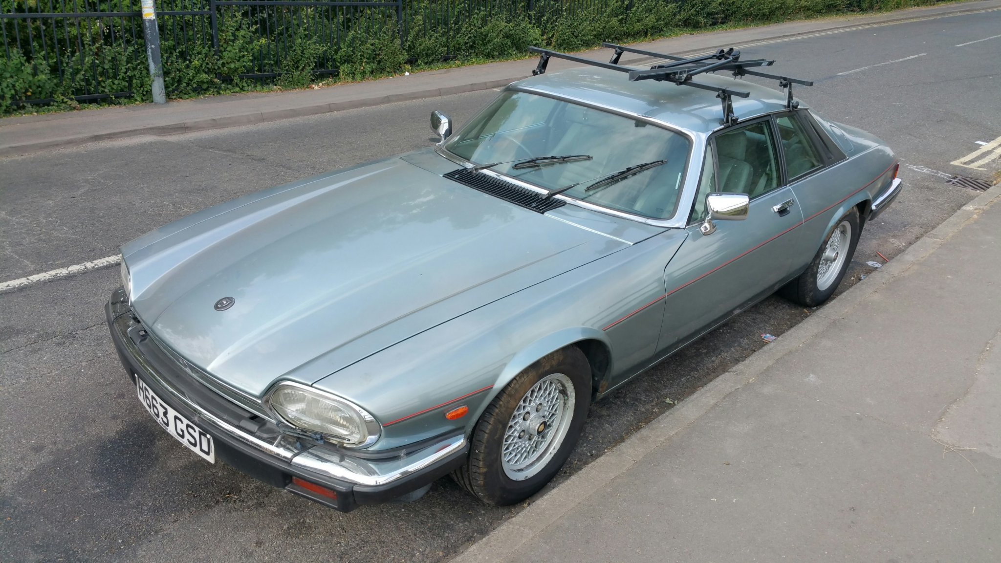

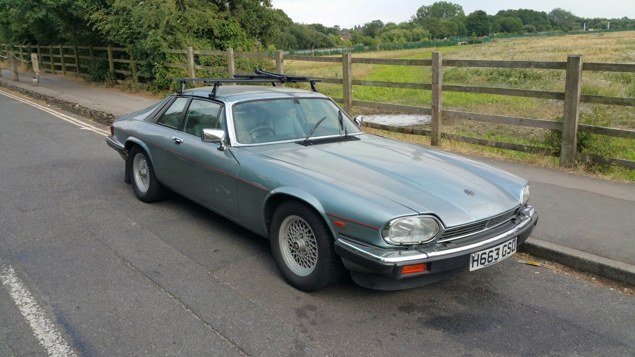

Looks like that car has the common problem of being British the windscreen wipers not parking, which I need to fix on my car at some point.
According to the XJ-S Barry Bible, by the time my car was made, both types of Lucas motor had been abandoned in favour of Electrolux. The wiper switch was still Lucas though, and because my wipers park in intermittent mode only, the switch is to blame. Barry Bible saves so much time. Thanks Barry! :study:
