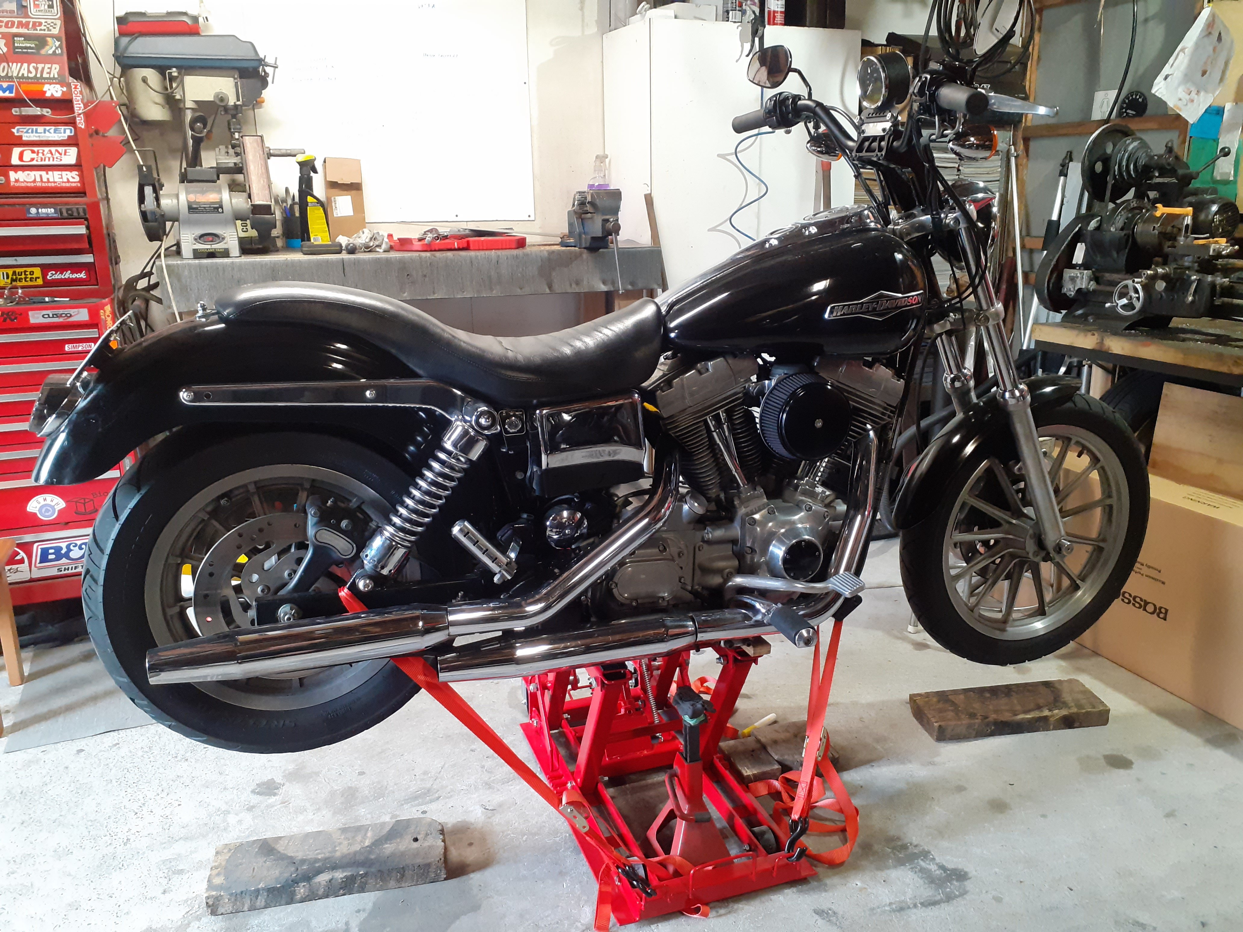

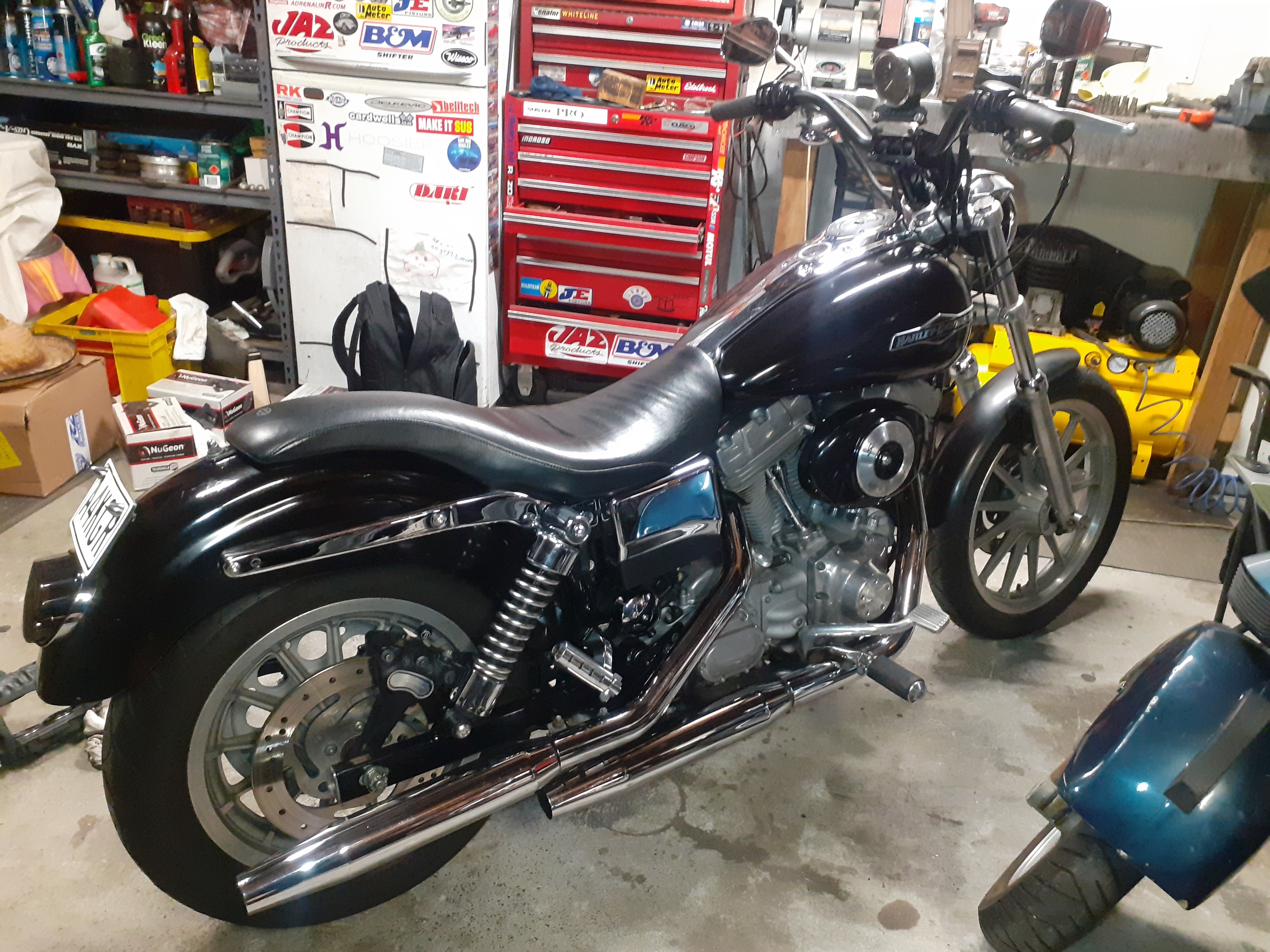

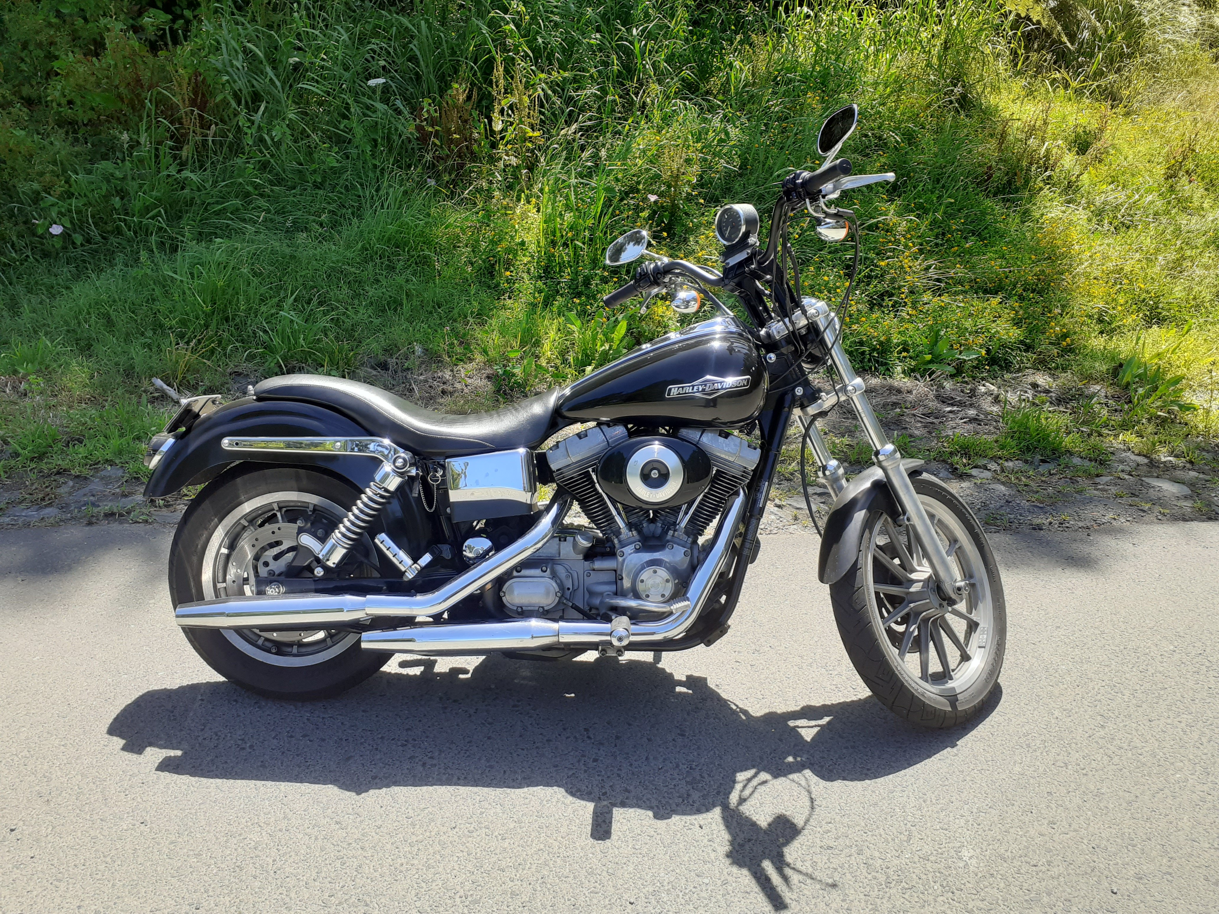

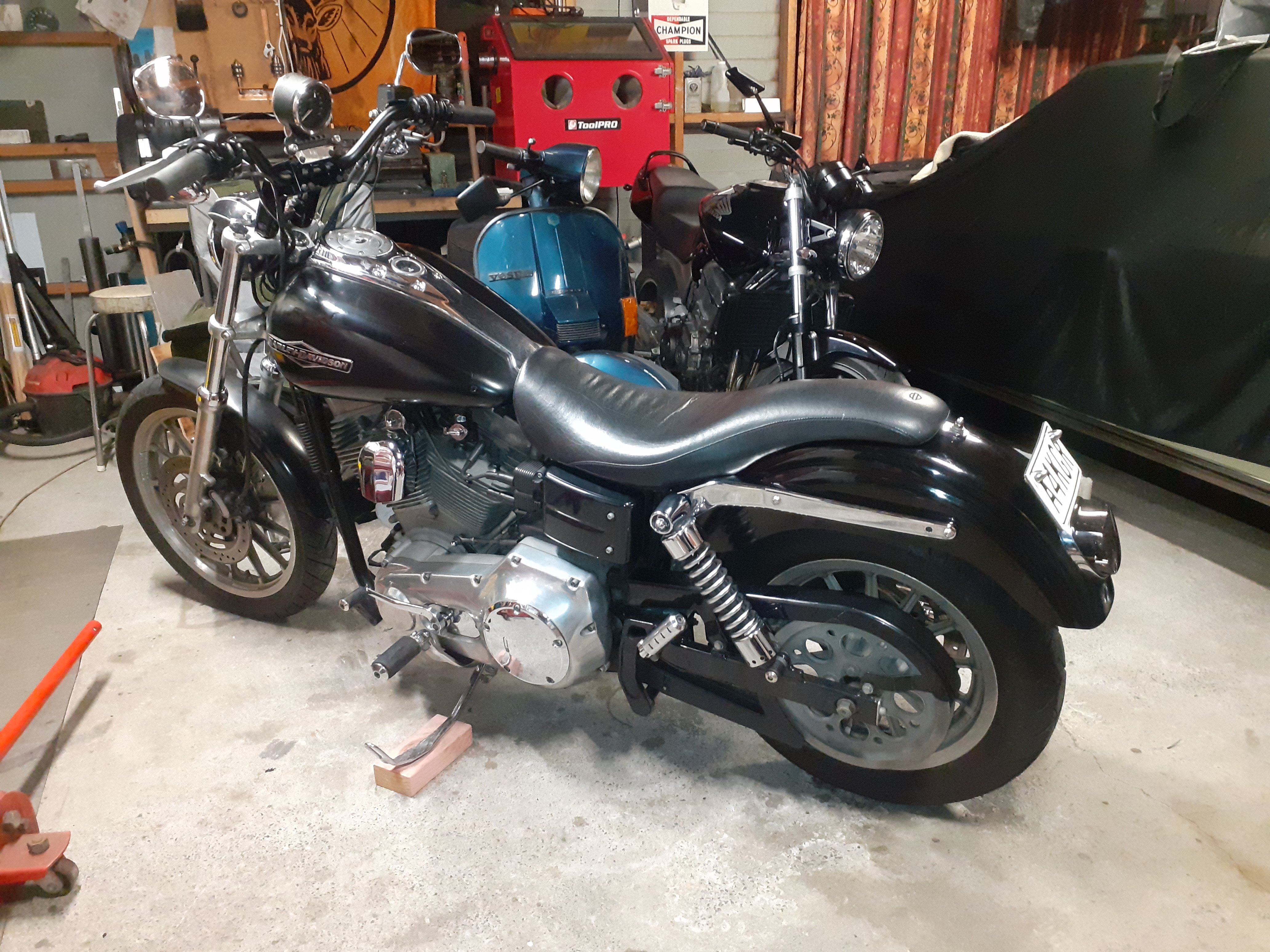

Popular Post cletus Posted December 26, 2024 Author Popular Post Posted December 26, 2024 Next side project 04 HD FXD 1450cc, 5 speed, carb. 30something thousand miles It's a bit of a 20 footer , the paint is fucked but I figure it's not a huge deal to get that sorted on a bike. Needs a lot of little tidy ups, it's a bit grubby, gear shift linkage is loose, speedo mount is a bit dumb Seems to run OK, I've only ridden it a short distance but it seems to be a bit slow, doesn't stop great, handles a bit wierd, and build quality not great compared to a honda so is exactly what I was expecting Is all stock apart from aftermarket bars and risers and an led tail light , and it seems loud ish so maybe the mufflers have had a mufflectomy It's very big and heavy compared to what I'm used to, but the good thing about that is it is a more suitable size for me 19 1 Quote

Popular Post cletus Posted December 27, 2024 Author Popular Post Posted December 27, 2024 Spent a few hours hooning around on it today on some roads I enjoy on my other bike. The handling is actually a lot better than I was expecting. It's a lot of fun on windy roads it doesn't do anything bad apart from the pegs and side stand hit the ground on tight corners, so you have to enter a bit slower, if you come in a bit hot and the pegs start grinding you're kind of fucked because you can't lean any more This dyna series of bike is known for something called the "dyna wobble" , this is because the swing arm is mounted to the gear box and motor assembly, which is rubber mounted to the frame, so the rear wheel can kind of move around a bit, this is usually when the mounts are a bit chooched. Makes for interesting mid corner handling. This one does not do any wierd stuff so the mounts must be good ish The lack of hp doesn't seem to matter, it has bundles of torque and it goes good enough to get yourself into mischief so I'm not too worried about that Brakes, are not super awesome but are probably good enough, it's a bit odd getting used to how much rear brake you can/have to use One other positive, it seems a bit easier on my back, the amount of spine ouchies was less than on the honda, I wonder if a bit of extra bike weight helps with that? In all, I like it more now after spending a bit of time riding it 20 1 Quote

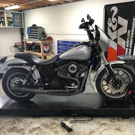

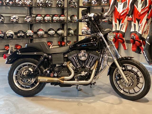

Popular Post cletus Posted December 28, 2024 Author Popular Post Posted December 28, 2024 Paint, not sure on colour yet Some cosmetic tidy ups , frame and engine paint It's got a fiberglass front guard so I'll find a factory steel one Small headlight fairing and possibly chin spoiler 2-1 pipe Step up type seat Possibly twin disc front and some engine mods This kind of thing 9 1 Quote

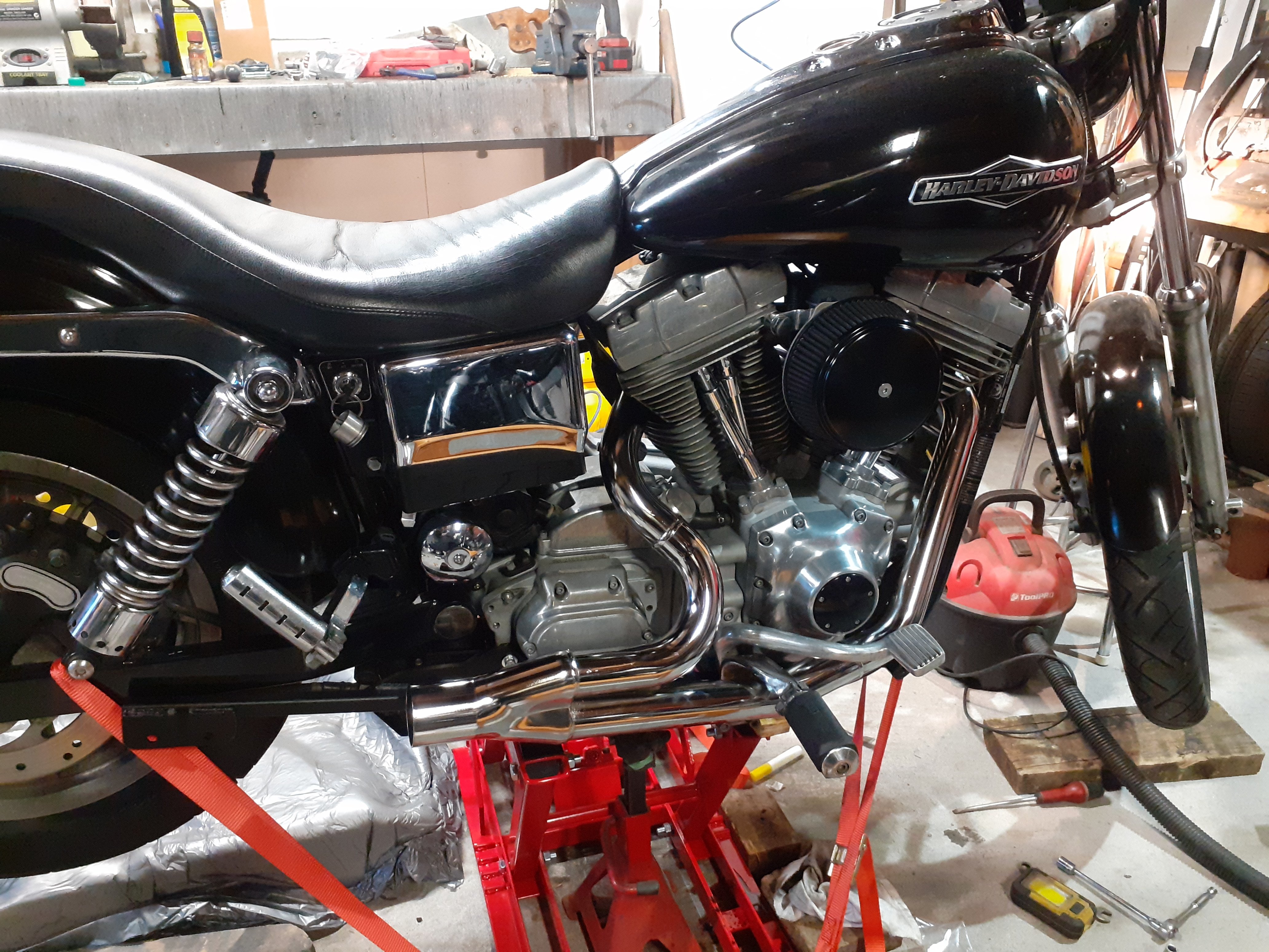

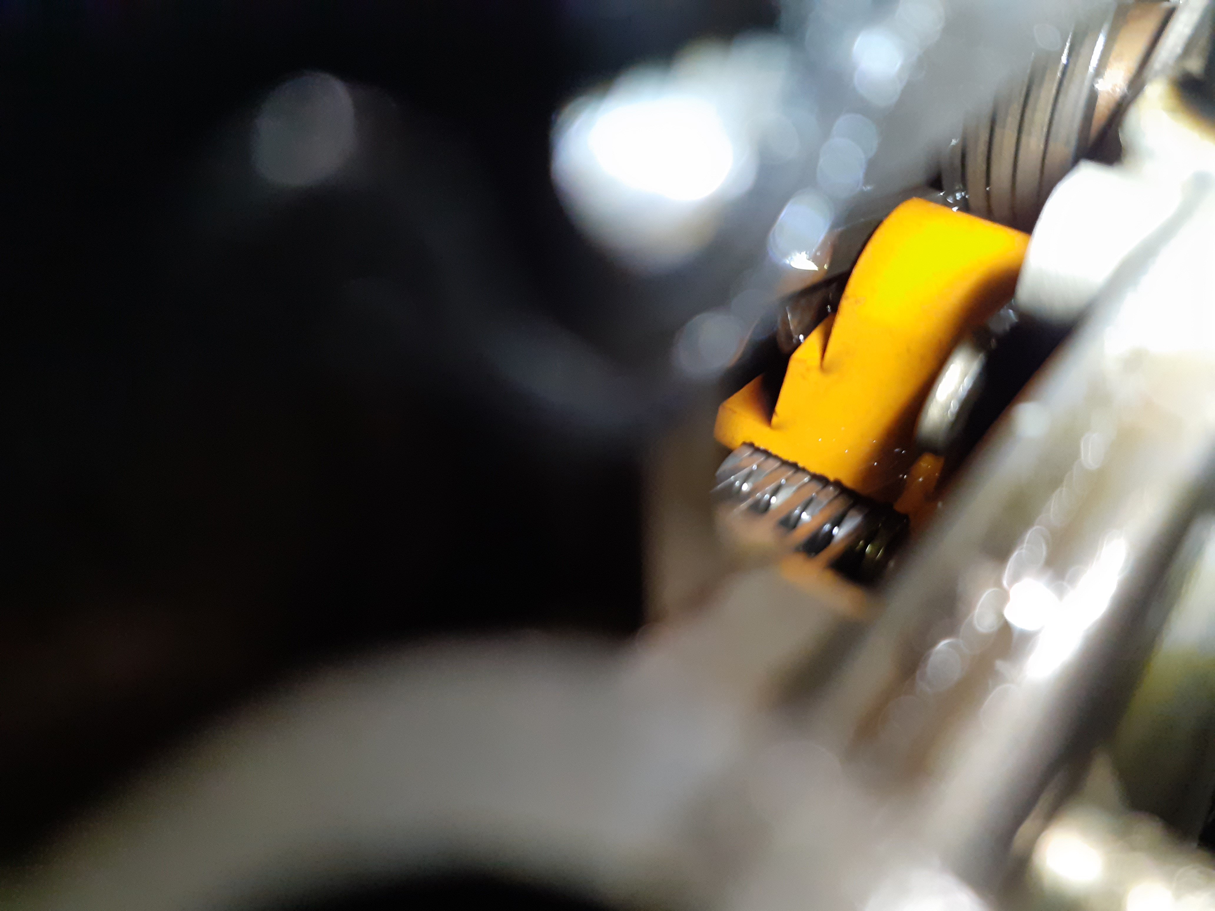

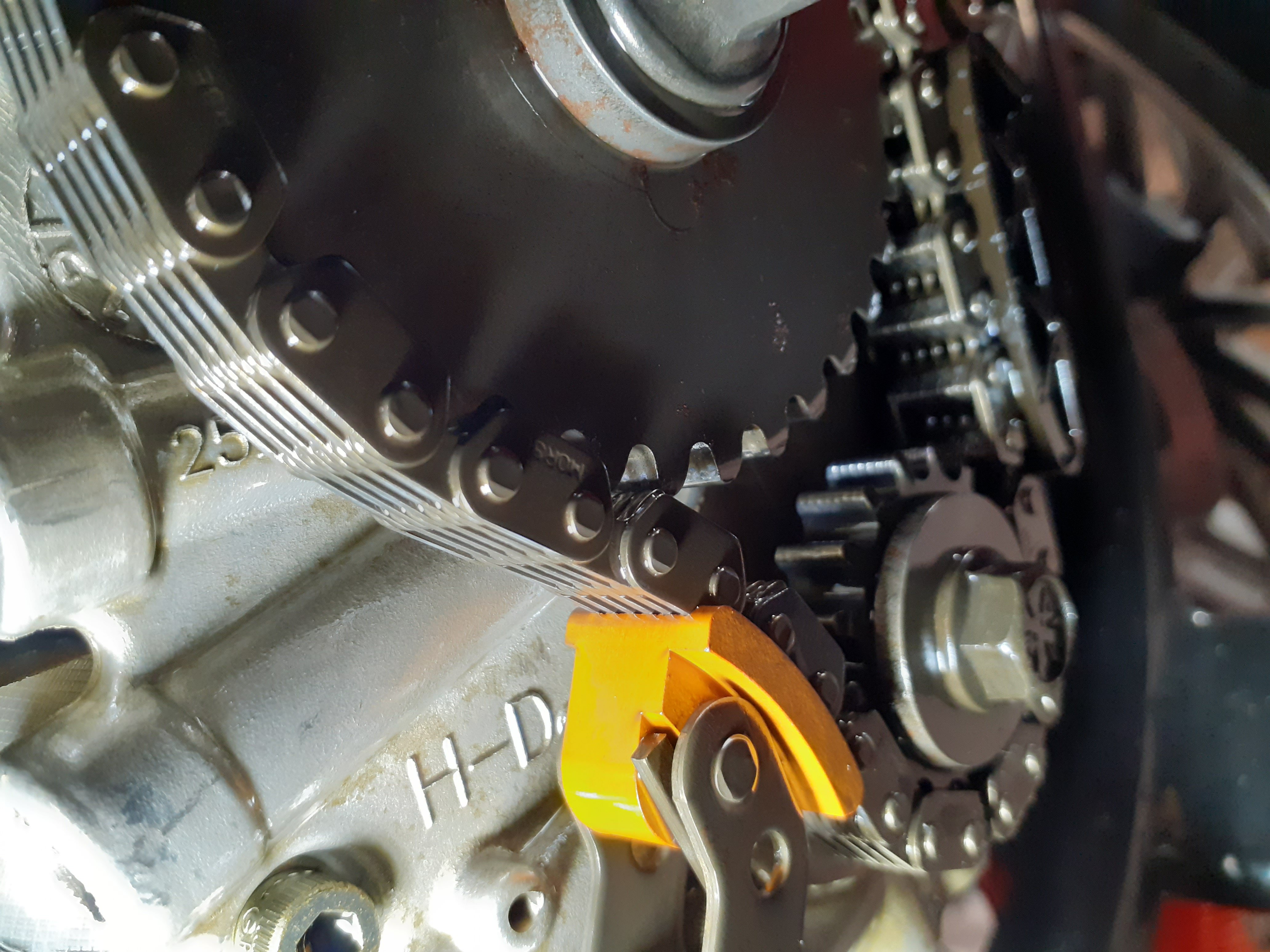

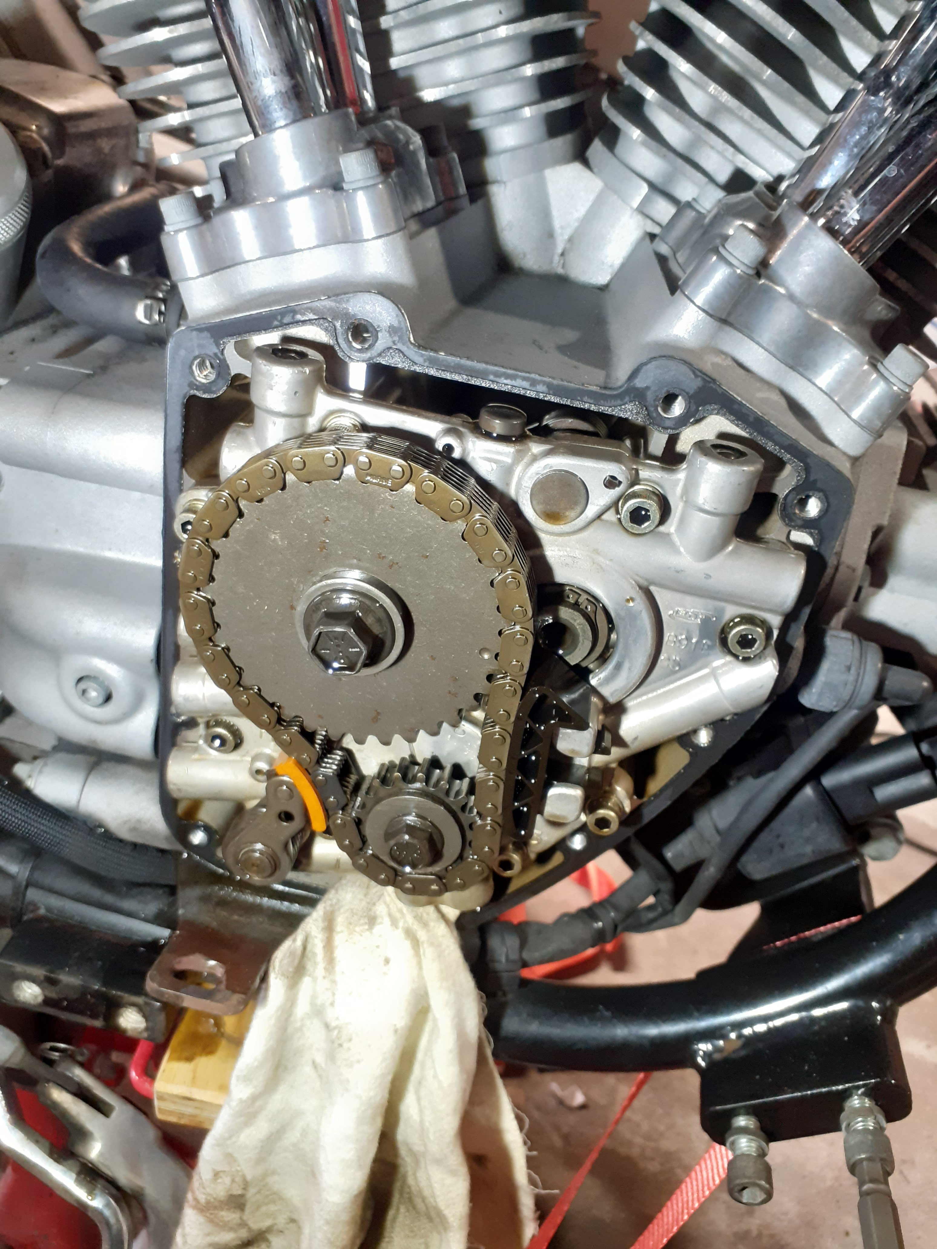

cletus Posted January 19, 2025 Author Posted January 19, 2025 Time to release more potato noises, got a new zorst pipe While the exhaust was off I thought I'd better check the weak point on these engines, which is the cam chain tensioners, they often wear out at very low mileage, they are plastic and have quite stiff springs. There's one that's easy to get to and another that's a bit more work, pushrods, rockers, lifters and cams all have to come out When they fail they break up and go in the oil pump and carnage ensues Easy to check, just take stuff off, cam cover off, look These are worn enough to need replacement so I'll do that soon, that would be an opportunity to do cams at the same time , and there's a few options on upgraded tensioner systems etc depending how many dollars you want to spend, there's a kit to convert to later model twin cam style hydraulic tensioners Anyway, bolted the exhaust on, I guess if it was a v rod I'd be finished here Put the muffler on and started it, goodness me it's a bit rowdy, looks like they put the louvers in the muffler the wrong way around to make it noisy, I'll see what it's like but I'll probably make a more quiet insert Also the heat shield doesn't fit at the front , there's not enough room between the front pipe and the frame , might need a trim, or a spacer under the front engine mount might do it 8 Quote
