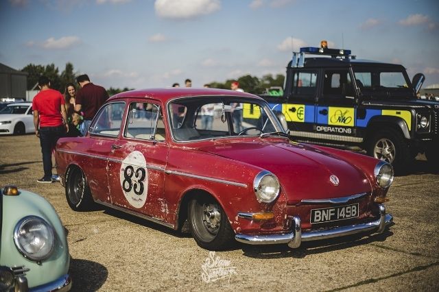

Anyway, I stumbled across this the other day I gotta say, I friggin love it!
the battle scarred old paint, the wide rims and white lettered tyres, that "i mean bidness"stance, to cool.
Like it just came off the track after a awesome battle with these guys.
Historic_Motor_Racing_News_02pop.jpg?ito
So the idea of a old school street racer is where I'm at now, a imagined past that never happened where my car was a midnight highway stormer, kicking ass and taking scalps and pinks. icon_lol.gif icon_lol.gif

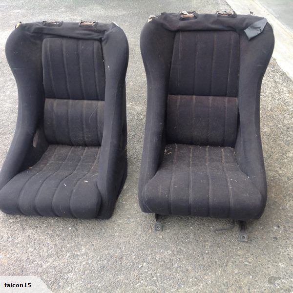

Enough nonsense! I've always wanted to have real bucket seats in this thing, low fixed back buckets, like cobra make, but at 4-5 hundy each I wasn't going to worry about it any time soon. a couple weeks back I noticed these for sale on TM, and cheap.
but my stupid brain forgot about them/don't really need them anyway, then I got a fixed price offer from the seller, guess no one else wanted them, okay I'll take them!
One problem, they're in wellington, or rather Kapiti. No problem I'm pretty sure there is a veedubnut in kapiti, hope they are close by! Turns out the seller is pretty much one of KombiZombi's neighbours! so they are now safely tucked up in his shed till I think of a way to get them north. icon_cool.gif icon_biggrin.gif
Look pretty old school racer to me!
