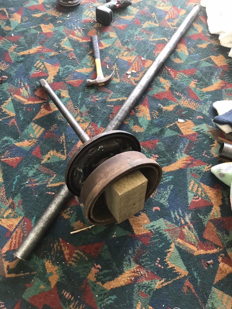

30DegreesRetarded Posted April 25, 2023 Author Posted April 25, 2023 I had no issues with that axle collar when I collected from Denham. Drove it from Palmy all the way to Blenheim no probs. It was awesome, but it just made a shit annoying noise that I wanted gone. It was only when a purchased a new 260c bearing kit from TradeMe and replaced the axle from another Datsun that my troubles started. I talked with Denham and a heap of other dudes from the Datsun club but at the end of the day, I’m no mechanic just a hobbyist. This was the homemade way I pressed on collar. Heat it up in the oven 180degrees and drove it home with the steel tube. I tried to upload finish pic but file size won’t let me. I talked to another Datsun/prince owner that had an issues with bearing supply and telling their supplier (Auckland Bearings) they were too big. They were smart enough to send to an engineer friend before installing. At the end of the day. I prob should have had it machine pressed by someone in the know. .. so it’s off to CM Coombes to machine a new axle and instal. Quote

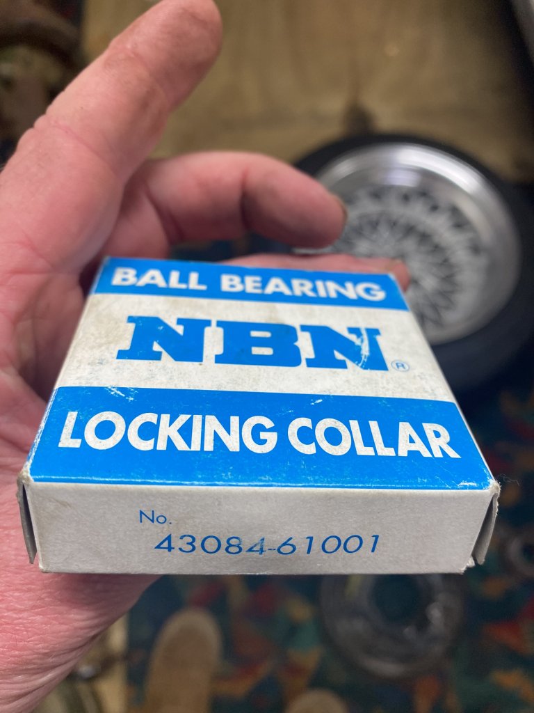

30DegreesRetarded Posted April 26, 2023 Author Posted April 26, 2023 (edited) Legend, just ordered a locking collar now from Adayama. Picture of part number was perfect thanks. ”edit” turns out it’s the same part number as the collar i used. Will still send to engineers with axle. Atleast they will have something to conspire/use if it is correct Edited April 26, 2023 by 30DegreesRetarded Added to comments Quote
