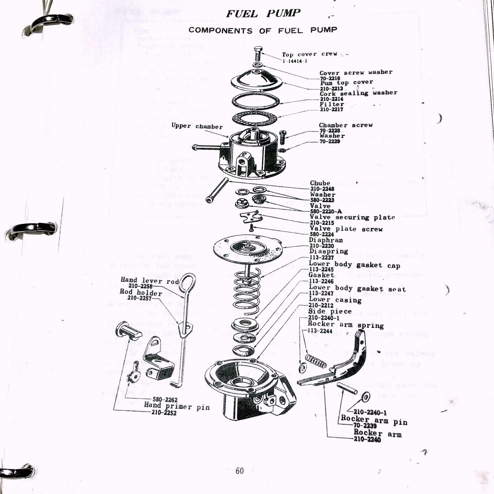

MARTS-PL310 824 Posted July 17, 2020 Author Report Share Posted July 17, 2020 Another diversion from rust repair was had. Rebuilt the 310 Datsun Bluebird fuel pump. A quick job that provides the satisfaction of finishing something in one go. Found a repair kit in oz several years ago and just hung onto it. Replacement pumps are a bit scarce and I didn't much like running it with a noisy electric. Anyway, it's good to go now, at least until the ethanol laced fuel ruins it again. The 310 Bluebird FSM is quite handy. There are several interesting pages dedicated just to the fuel pump. This is one. Learned a few new words. Chube, Diaspring, Pum. ; ) Discussion: https://oldschool.co.nz/index.php?/topic/60267-marts-pl310-61-datsun-bluebird-sedan/ Build:https://oldschool.co.nz/index.php?/topic/60264-marts-pl310-61-datsun-bluebird-sedan/ 1 Quote Link to post Share on other sites
