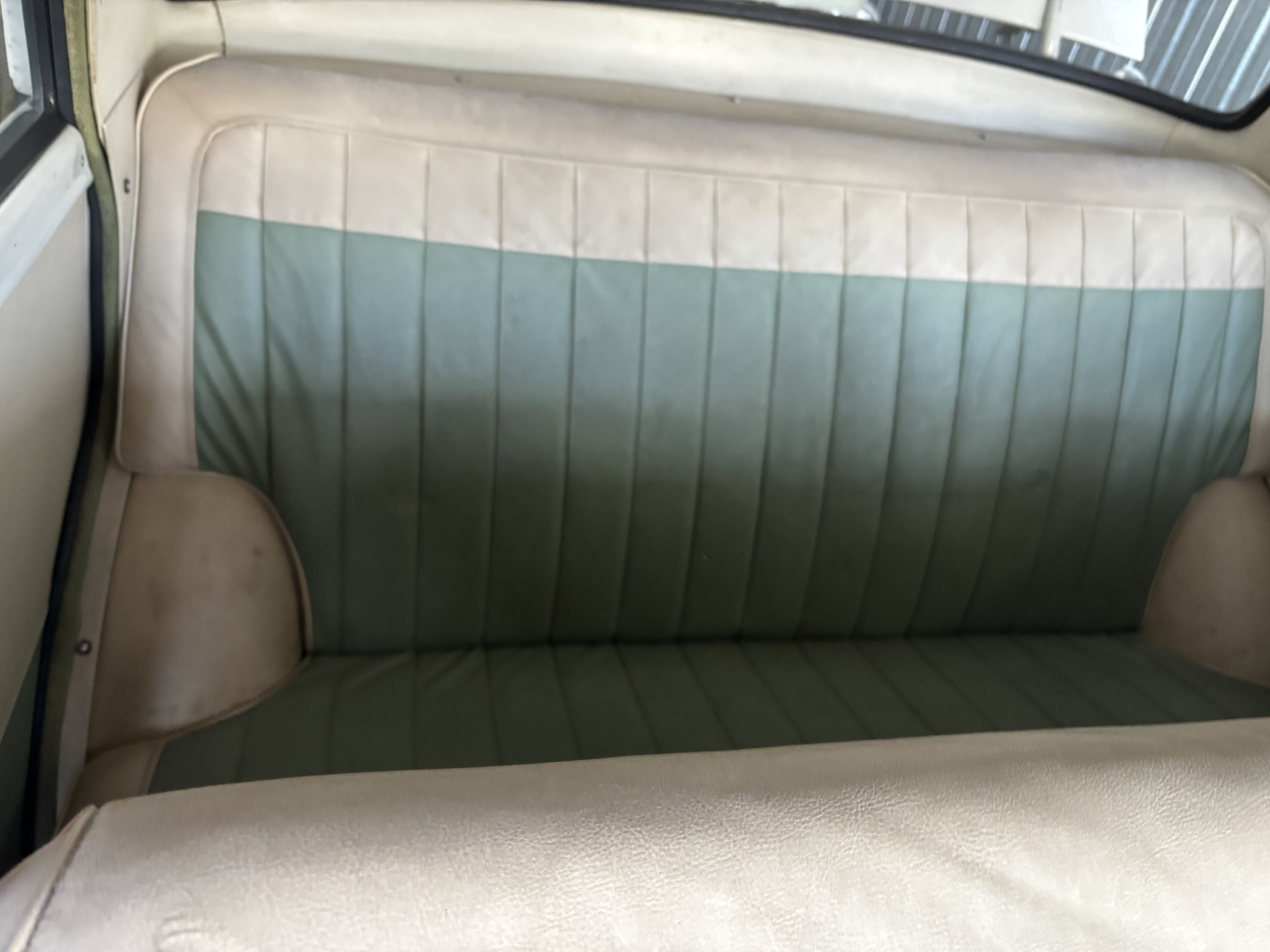

Discussion here and pic of rear seat https://oldschool.co.nz/index.php?/topic/91418-mrt1trd-‘62-bluebird/ -

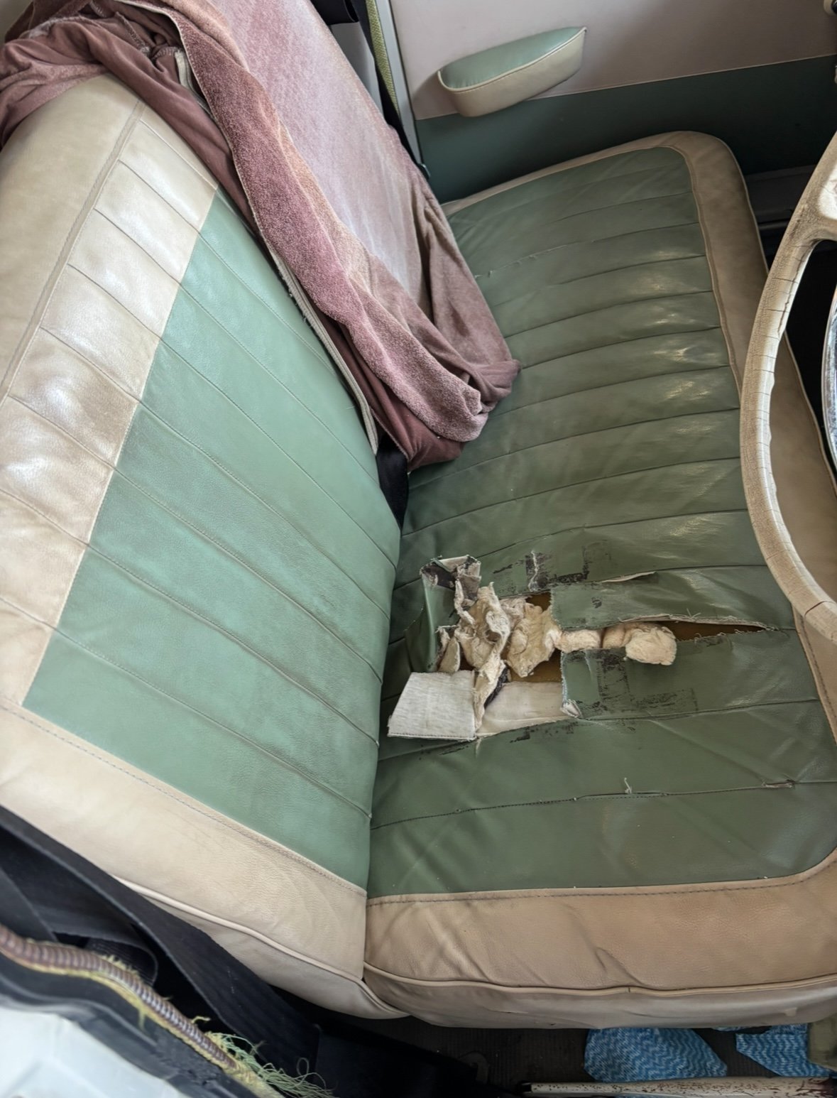

The front seat base needs some repair, it’s not missing any vinyl so I think it’s possible to do a internal patch to hold it together if matching colours are not available, or does anyone have suggestions? -

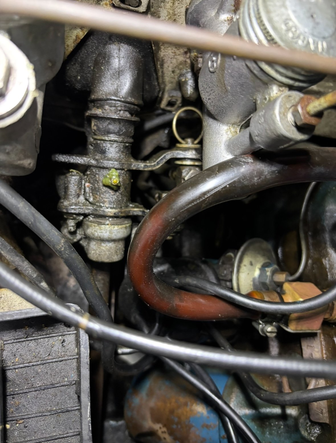

So then Looked into the gear shifting issue first was the play in the shift rods, the joints had a lot of play on the 1st - rev rod, so I replaced the bushings and washers, the split pins was half the problem, being soft so best I had lying around was some key rings. this improved the selection but still had play inside the box, so I was able to select 2nd while driving if I’m slow and almost grind reverse that is -
