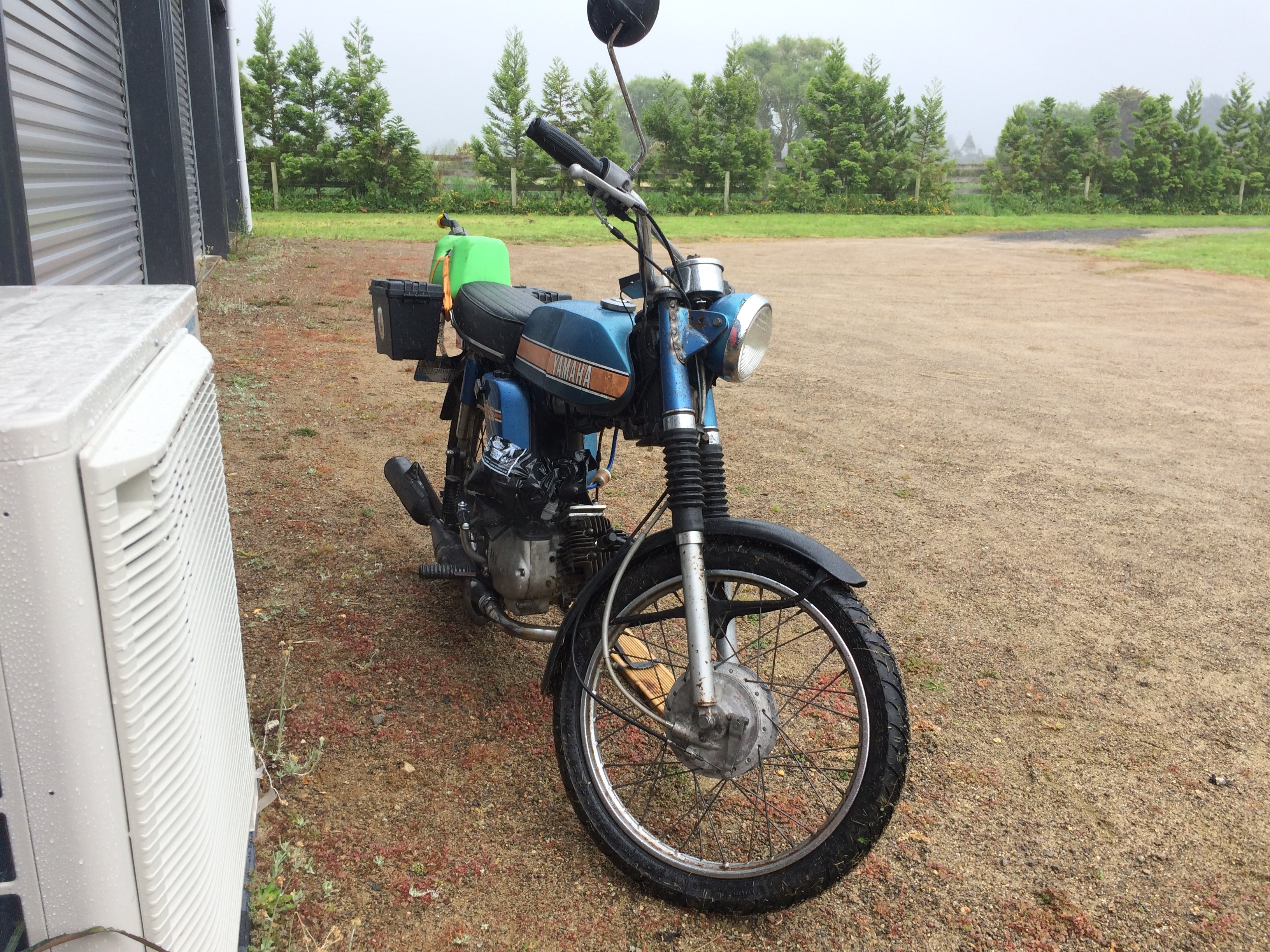

Truenotch Posted December 1, 2018 Author Posted December 1, 2018 I got some nice new SS stickers for the side covers: but I can’t bring myself to to remove the war paint from the east cape: 5 1 Quote
Truenotch Posted December 17, 2018 Author Posted December 17, 2018 I still haven't cleaned this thing since the East Cape mission... Maybe that will happen this weekend? I got a special delivery from @Raizer today: a set of bars from a Vmoto Milan. They're about the height that I want and are quite narrow, which suits the FS1 reasonably well. I threw them on and took off the guards to see if I liked the look: I like the bars, but am definitely not sold on the no guards look... Especially in the rear. It would need to be a shitload lower and have a low seat to look right IMO. Put the rear guard back on and took a few other pics: And a couple of sneaky shots with the next 2 wheeled project... 8 Quote
