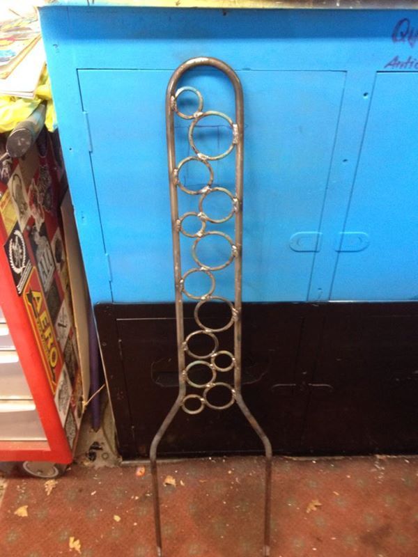

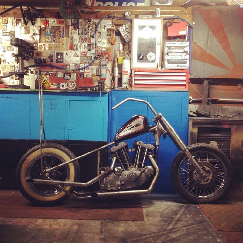

Popular Post Chris.QCR Posted April 13, 2015 Author Popular Post Report Share Posted April 13, 2015 Got Engine back in on friday with help from Josh. Also started making Headlight mount and doing some crazy stuff on the Sissy bar 12 Quote Link to comment Share on other sites More sharing options...

oldnrusty Posted April 13, 2015 Report Share Posted April 13, 2015 Looking sweet man! Are you gonna run the exhausts parallel to each other? or are they in there finally resting place? Quote Link to comment Share on other sites More sharing options...

Poo Posted April 13, 2015 Report Share Posted April 13, 2015 how bout the sissy bar. any chance to get it to lean back further. Possibly match the same angle as the rear cylinder? Looking sweet. 1 Quote Link to comment Share on other sites More sharing options...
Chris.QCR Posted April 13, 2015 Author Report Share Posted April 13, 2015 Yeah I'm gonna lean it back a bit more . Wanna a lot of the angles to match each other 3 Quote Link to comment Share on other sites More sharing options...
Popular Post Steelies Posted April 13, 2015 Popular Post Report Share Posted April 13, 2015 yeah nice. i'm gona put this out there early in the piece.. dick of bubbles. 10 Quote Link to comment Share on other sites More sharing options...

bathcollector Posted April 13, 2015 Report Share Posted April 13, 2015 Looks good. A question though, in the pic with the engine out, the bottom hard tail tubes look like they bend down at the join to the front frame tubes . Just an optical illusion from where they splay out perhaps ?? Quote Link to comment Share on other sites More sharing options...

Chris.QCR Posted April 13, 2015 Author Report Share Posted April 13, 2015 It's optical Bath collector and it's fucked with me everytime I look at it haha . 2 Quote Link to comment Share on other sites More sharing options...
bathcollector Posted April 13, 2015 Report Share Posted April 13, 2015 As you were then. I think my kids thought I was having a stroke or something, leaning down trying to eyeball the lines, haha. Quote Link to comment Share on other sites More sharing options...

63Ragtop Posted April 13, 2015 Report Share Posted April 13, 2015 Looking good Mr loser, sissy bars will make some sweet bubble trails once you suss out where to mount the soap mixture. 1 Quote Link to comment Share on other sites More sharing options...
