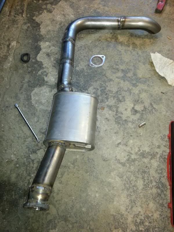

So I tested my new 3" on the weekend and it's fucking loud! I enjoyed it, but will probably need to add another muffler before the next round at Pukekohe.
After a quick squiz, there should be room after the bend for another muffler the same as the front one.
Between the 90° and the weld by the dumpy tip here:

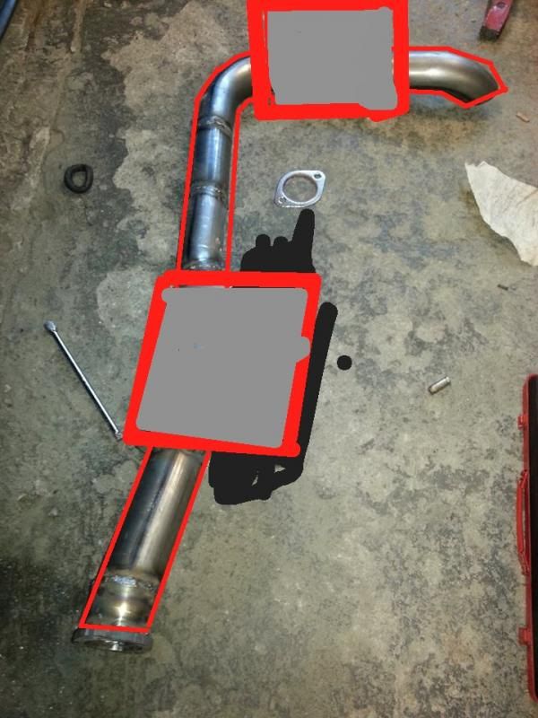

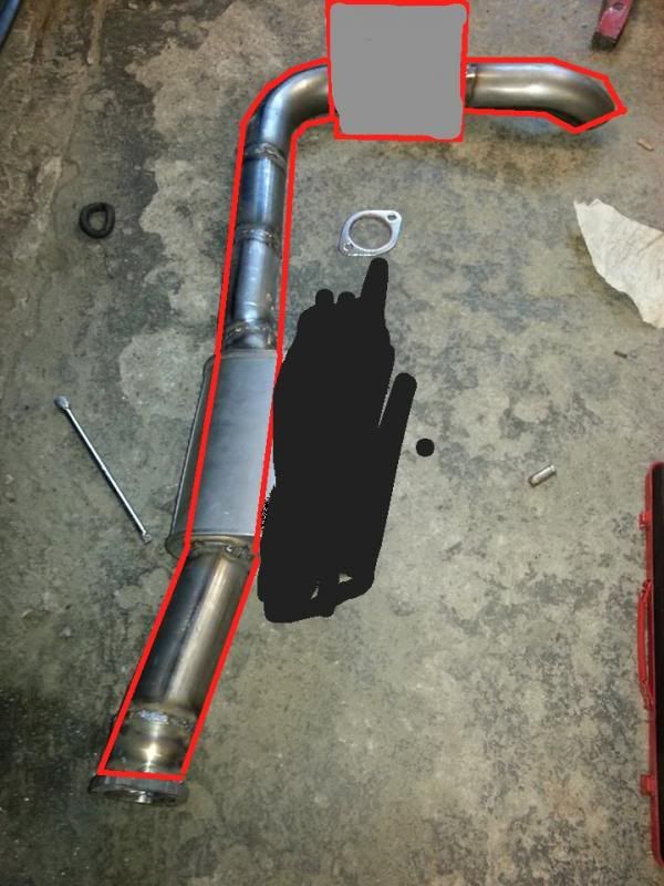

I'm thinking about just moving that muffler to after the 90° instead of adding another one...
Like this:
can you bang a reso in place of current one, then put current one in new location?   should  sound better and a bit quieter

I can. Or I could possibly fit another one of those mufflers in there - should be better than a reso?
what are those mufflers? are they straight though(edit: like the one you posted on page 2?)  or some kinda baffled type?  if straight though, yeh why not!     i was thinking something like this.  straight through glass pack. perforated not louvered.   i just happend to build an exhaust for mates car this weekend, with one + a rear muffer, but engine is junk, so couldn't test it out!
Yeah, the muffler is a straight through glasspack (the one I posted on an earlier page). Does sound follow flow at all? Because the chamber would be on the outside of the corner in that setup, so might be more effective than if it was mounted straight?
