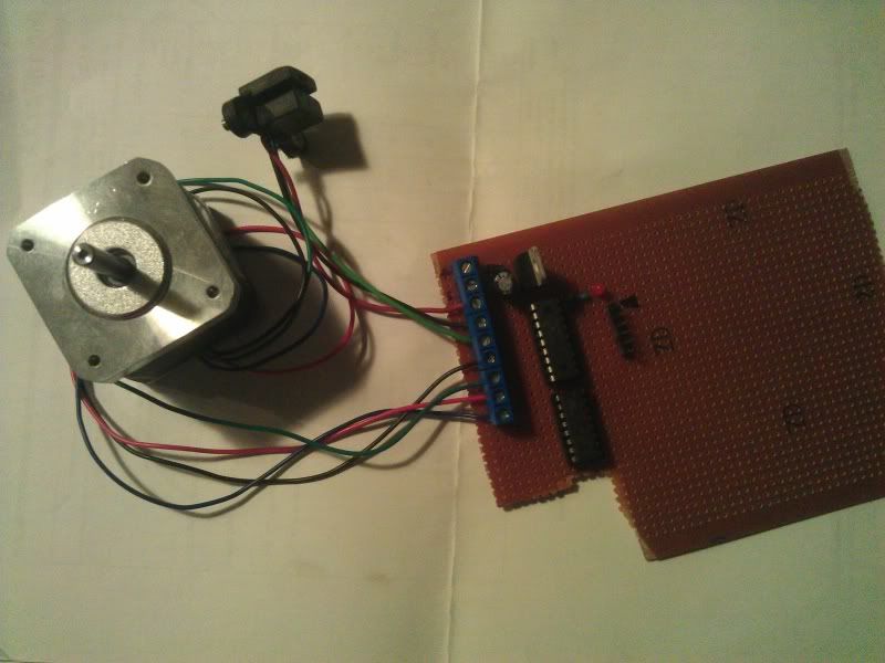

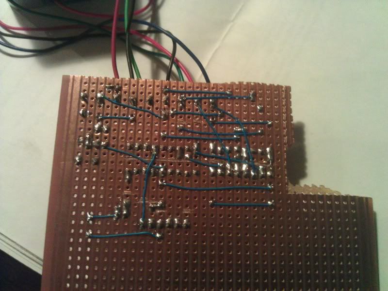

mikey Posted July 20, 2013 Author Posted July 20, 2013 I did this today: It's a PIC16F628 with a L293D motor driver. I've hooked up a hall sensor and stepper motor. If the motor's not fast enough I'll find another brushless motor that is. Tomorrow I'll write some code and hopefully hook it up to the speedo. Quote
