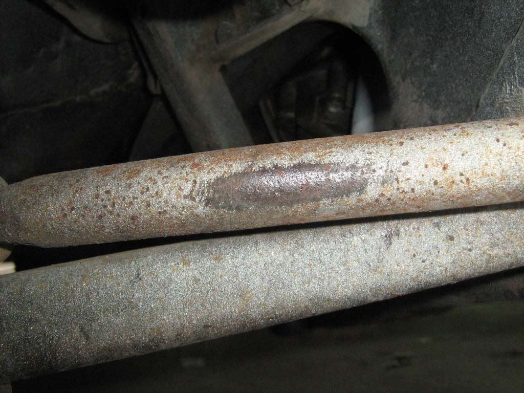

I rub my tie rods i think on full lock, if i was to go say Tyre Master would they be able to help me out?
Am i going to be able to avoid the rubbing, if i raise the mounts?
