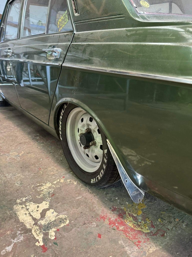

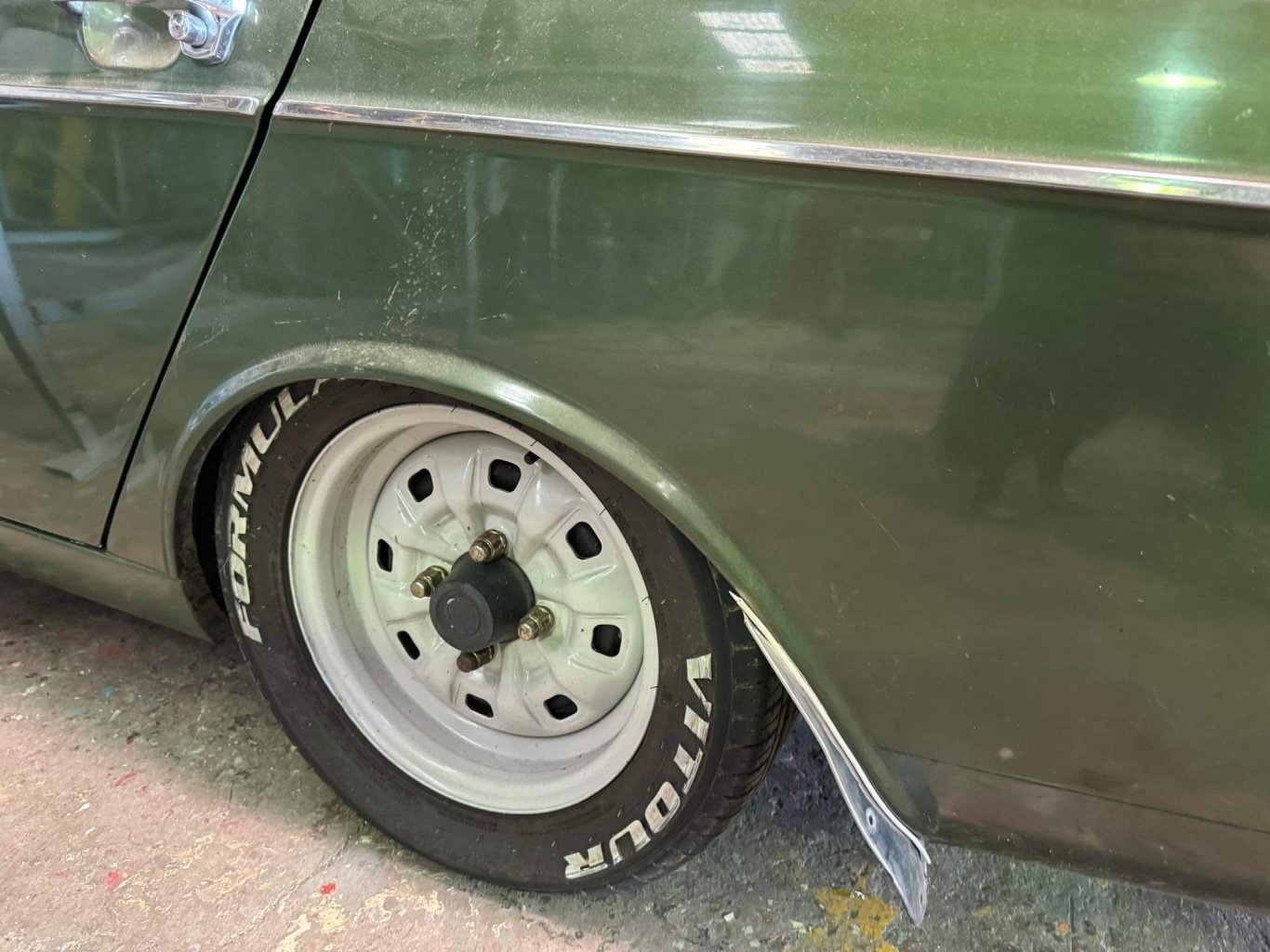

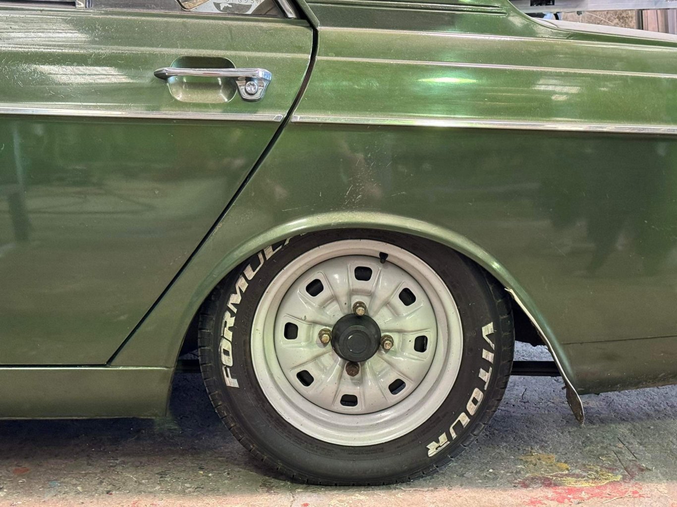

I borrowed some 14's off a chap to see the rough state of play; Current 13x5 ET25 Lancia 14x5 ET45 - I like the look but that offset is a hard no Fiat steels, 14x5.5 ET28 (ish, I couldnt find markings so did a roughy measurement). These fill the arches nicely but I have never liked this style and they are heavy as fuck. I am leaning pretty heavily to some 5.5 or 6 steels with the RWD offset, but in the holey style if @azzurro will sell me some Altho a man with a Maserati has told me he has some of those mint rims then ghosted me The search continues.1 point

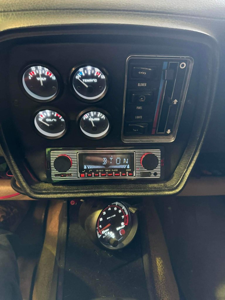

After a bit of messing around I've got the flywheel, clutch and master cylinder sorted. I was looking into the different types of sound deadening, Dynamatt seems to be the go to but fuck it's spendy. Just to do the front half of the interior it was going to cost about $450. I went the cheap Chinese route instead. I bought enough to do almost the entire inside of the car and it was $45 including shipping. Time will tell if it's any good, but it seems about right. I pulled the dash and trim parts out from under the bench and gave them a clean up. It was the first time I've seen them in about 16 years. The stored really well. I have had the instrument cluster in at Parrot and son to have a little work done, the main thing was having the tacho modified to suit the 6 cylinder and they fixed a couple of small issues. I've wired the engine up more or less. I'm waiting on the electronic ignition to arrive, I'm going to run some hard fuel lines, install a fuel pump, regulator and make some new brake lines. The drive shaft is being built and should be ready in a week or so. Hopefully not too much longer until she's running. The interior is mint apart from the front seats, they need recovering and probably some new padding. Does anyone have any recommendations for someone in Christchurch? Cheers.1 point
