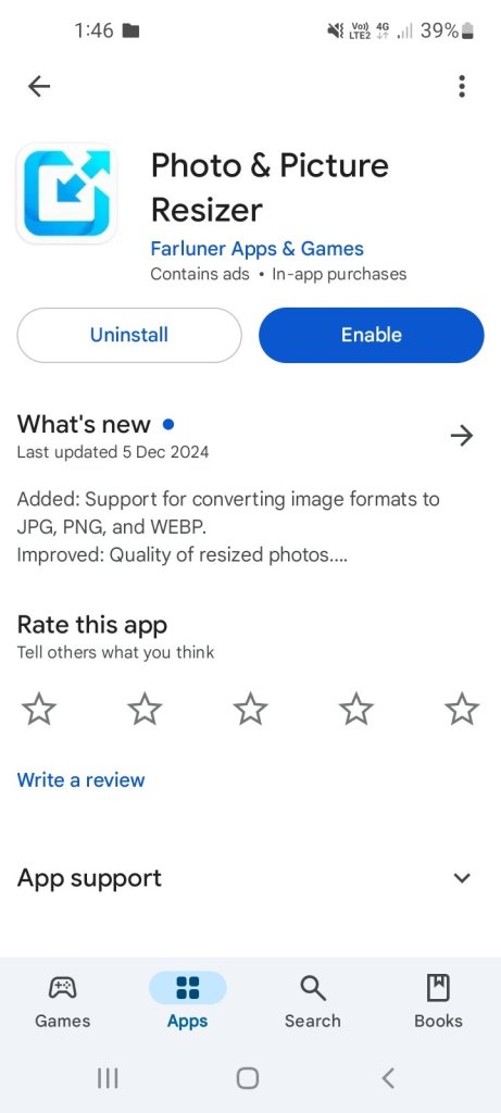

Alfashark Posted January 3 Posted January 3 Great to see another Beetle getting some love! As far as getting the pics to a manageable file size, open each one in your gallery and take a screenshot. Then upload the screenshot and you should be good to load up a pile with each post. Quote
Raizer Posted January 3 Posted January 3 Can get free photo editing apps, then it's easy as to resize your pics. Not surprised at one of Kev's Beetles having rust, happy to see it being saved! Quote
Bearded Baldy Posted January 4 Posted January 4 This is what i have used for years now. Can resize multiple photos at once etc etc. It has a paid version but the free one has never steered me wrong. Im on samsung but imagine their must be similar/same one for iphone. Good luck 2 Quote
