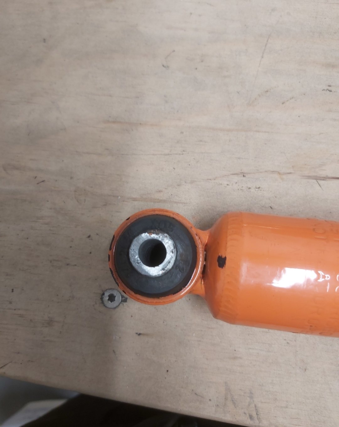

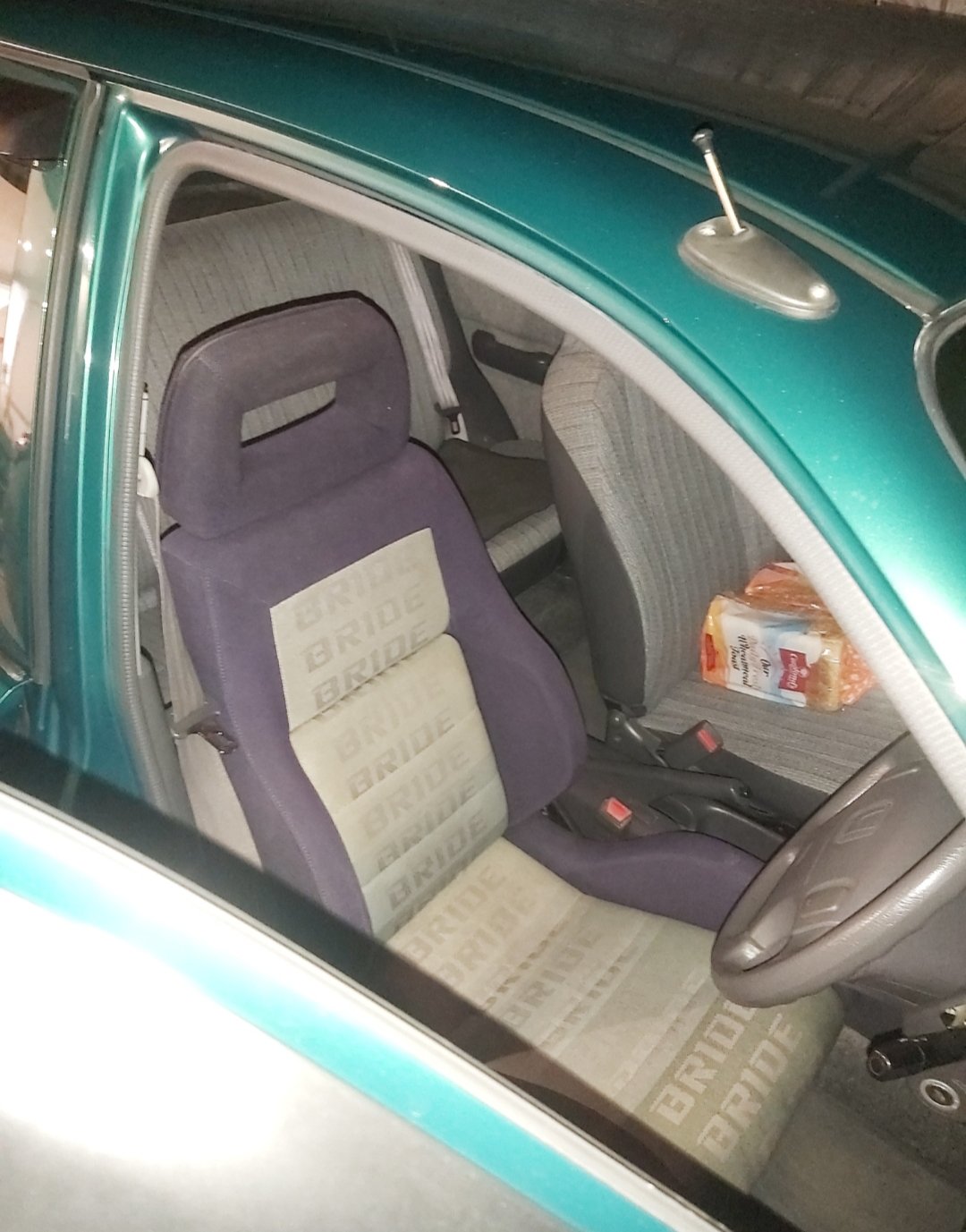

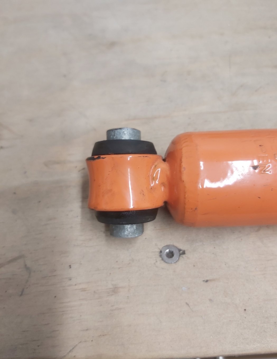

Popular Post kp60nick Posted November 24, 2024 Author Popular Post Posted November 24, 2024 Some stuff happened since july. Old rear shocks where buggered and I had some ones leftover from the starlet build top mount worked out fine. Bottom mount wasn't right. Shock had a 16mm hole and mount on axle was 10mm with a 50mm spacing between tabs. It just happed that the gate at work has 16mm bar with the spike on top so I chopped 100mm off the bottom over hang drilled a 10mm hole pressed into the shock and away we went After I put the wheels on there was no way to use the advan ad07 tyres to their full potential without falling out of the chair. Another part left over from the starlet build was my bride recliner just sitting around waiting for the perfect project car. I brought another drivers seat and ended up stripping it of its seat mounts and modifying them to suit. Its currently just fixed position so its super low and makes you feel like a boy racer when driving. here's a shit photo. After that I spent the next month or so using it for daily use. Was going great. Decided to sign up to do oldschool drags and really looking forward to using it over summer then 8 hours after this photo was taken at knock off time. An unfortunate accident in the work place carpark happened. One of the guys backed into it. Terrible I know. Because of that terrible accident things snowballed a little To be continued....... With only 3 weeks till os drags will he make it. Stay tuned to find out. 10 2 Quote
