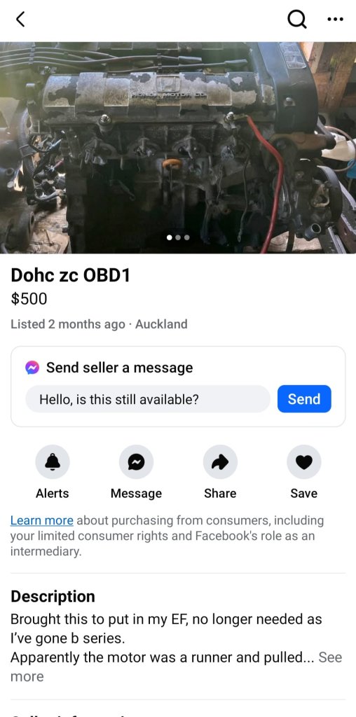

Willdat? Posted February 20, 2025 Posted February 20, 2025 22 minutes ago, kp60nick said: Apparently yes. They are still in the d series family. Not sure about the electronics. Could be done I'm sure of it. I managed it so it must be easy, the electronics issues addressed in that thread are pretty simple to resolve. This was EFI sohc zc to dohc zc. 1 1 Quote
SiRge Posted February 20, 2025 Posted February 20, 2025 Yea did a dohc zc in a shuttle as well with no electronic issues, however even dohc zc are getting pretty rare these days too. Probably a sohc VTEC from an EK is going to be the cheapest opportunity, but the you'll still need to adapt up to an obd2 ecu, or pay for an ever-so-increasingly expensive obd1 ecu ($200-300 odd, but chippable) 2 Quote
kp60nick Posted February 26, 2025 Author Posted February 26, 2025 On 21/02/2025 at 07:46, SiRge said: Yea did a dohc zc in a shuttle as well with no electronic issues, however even dohc zc are getting pretty rare these days too. Probably a sohc VTEC from an EK is going to be the cheapest opportunity, but the you'll still need to adapt up to an obd2 ecu, or pay for an ever-so-increasingly expensive obd1 ecu ($200-300 odd, but chippable) Maybe this could work? 1 1 Quote

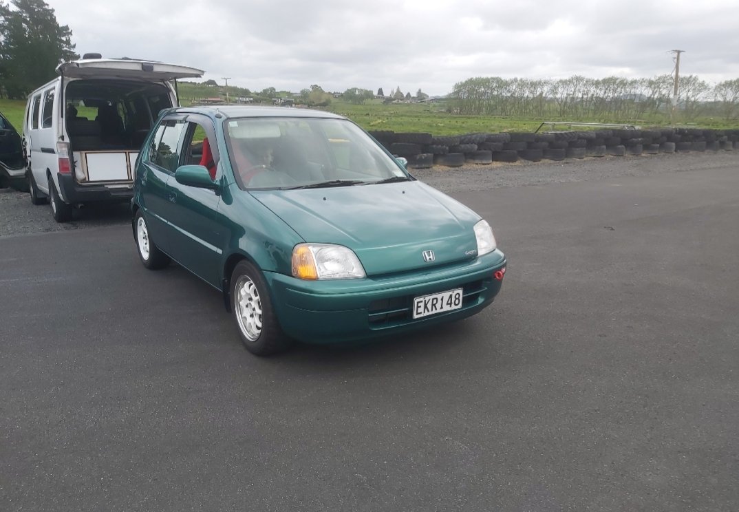

Popular Post kp60nick Posted April 28, 2025 Author Popular Post Posted April 28, 2025 Just ticked over one year of ownership with this. The past two months I've been doing the HD auto club circuit days. So far haven't had any problems. It's been so fun squeezing everyone of the 60 horses it has. Its got plenty of body roll but have a plan to solve that with a rear sway bar. Getting tyre pressure right has been a bit of a trick probably need to get a better tyre pressure gauge. Next day is the 25th may. Also removed the rear muffler and I'm now running it on npd 100 octane not sure if it helps but it sure smells good. Here's some photos from the last few months 13 1 Quote

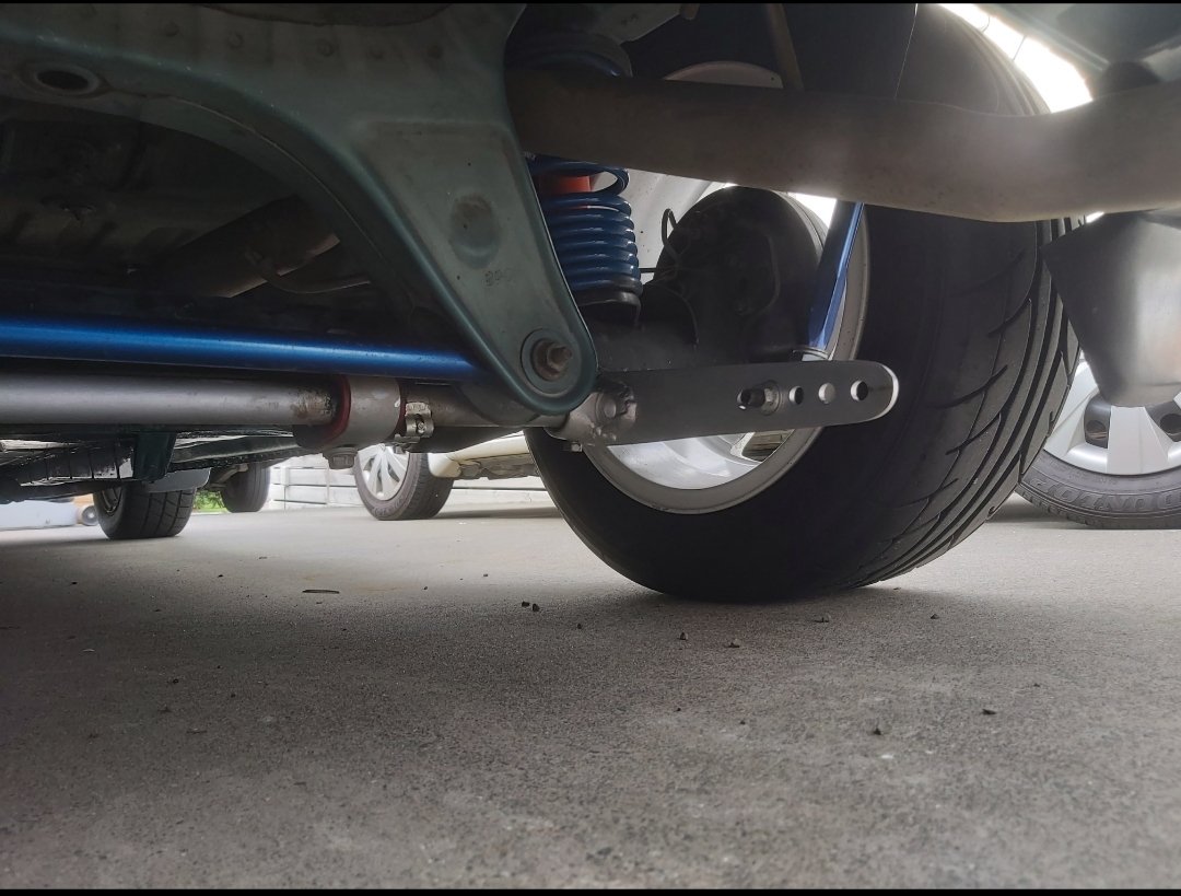

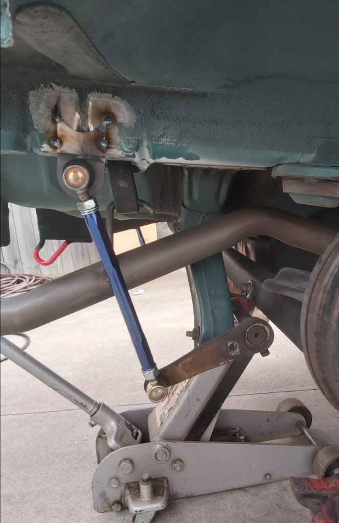

Popular Post kp60nick Posted May 28, 2025 Author Popular Post Posted May 28, 2025 Just ticked off the 3rd track day over the weekend. We had a good 6 weeks between days so I had a bit of time to try out improvements. First thing was trying to tackle the aggresive left front tyre wear by killing the understeer and body roll. I asked a few fellow fwd racers and they all said stiff rear / big bar. No factory rear sway for the logo this meant anything I did would need to be custom. I already had a rear sway bar from integra but it was only about 10mm to 12mm so didnt feel it was worth making it work because the difference wouldn't be noticeable. I was poking around the garage and I came across the 24.5mm torsion bars from my Narava. Then came across some honda fit sway bar links. Opened my parts drawer and found some starlet sway bar bushes. Started with making some mounts for the bar to mount to the axle. Originally wanted to mount it underneath facing forward but fuel tank was in the way. Facing backward and underneath fouls the panhard as it goes through its travel but the closer it is the arc of the arms doesn't interfere with the panhard. So I made mounts that mount it about level with the bottom on the back face of the axle. There is just enough room between the axle and panhard for everything. That was the trickiest part after that finding mounting for the body mounts was somewhat easier but still unsure if where I've actually put them is any bit legal but could cut them off and make them bolt on. (Just tacked in photo) When testing, I was finding the bar was shifting to the left potentially due the arc of the panhard when going over bumps. I've since put some bolt up hose clamps that seems to have stopped the problem. Also doing test drives it's now started lifting rear wheels when cornering hard and entering driveways. Other notable things I changed was trying out some semi slick ish tyres for the front the are pretty meaty but seem soft and they are cheap. So of course I needed another set of rims which of course needed a complete restoration. So blasted the centers and had Arrow wheels take out the buckle and weld the lips and re polish. Then painted the centers in gloss white. The improvements are definitely noticeable I can now keep my foot flat in 3rd gear going into t3 t4 at Hampton club circuit. I was lifting before entering previously. Just feels so much better all round. Could definitely do with a heavier front spring to stop the rear wheel lifting so high (was told almost 200mm high) but still in the testing stages and still managed to consistently be doing 46 seconds (dont know what it was before never had lap timer untill the last two sessions of the day) All in all everything was good had a small event with the hub nut starting to come loose but thankfully that was found quickly. Looking forward to the next day later this year going to take the winter off to do some other things while weather is crappier. 13 1 Quote

Rhyscar Posted May 29, 2025 Posted May 29, 2025 This is cool. Great to see rear swaybar worked a treat. Bonus cheapo upgrade might be stiff front swaybar and upgraded bump stops all round. Will improve handling until such a time you can properly address spring rates. 1 Quote
mjrstar Posted May 29, 2025 Posted May 29, 2025 I run exposed wheel centres and white match mark paint between the nut and the axle on my honda. Not sure what the torque spec is but I'd say it's more than my torque wrench would deliver, and is exactly what my longest power bar plus a bit of galv pipe is capable of. 1 Quote
kp60nick Posted May 29, 2025 Author Posted May 29, 2025 5 hours ago, Rhyscar said: This is cool. Great to see rear swaybar worked a treat. Bonus cheapo upgrade might be stiff front swaybar and upgraded bump stops all round. Will improve handling until such a time you can properly address spring rates. Thanks for the advice. I've already got a super thick front bar. The front spring rates are only 2kg or something like that. I have some fit coilovers that I've got to try make work at some stage. Up until then I'll make it work with cheap fixes. 1 Quote

E4shakey Posted June 8, 2025 Posted June 8, 2025 Did you have a pattern or template for sway bar mounts? And where did you get the links from? I have all the bits but have same problem with mount. Quote

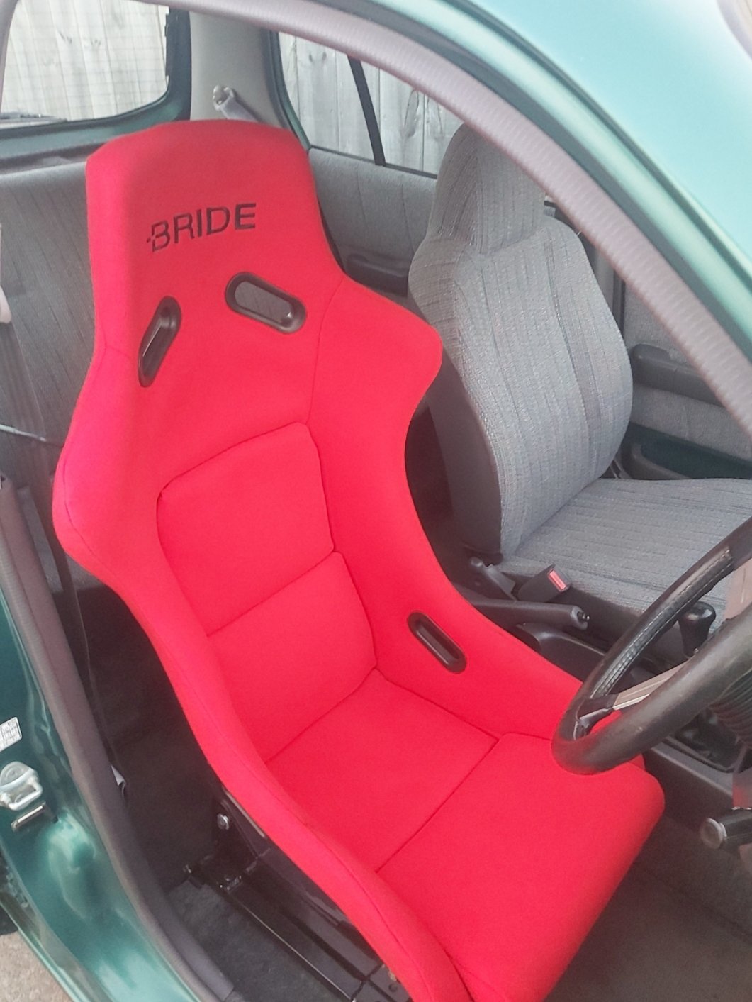

Popular Post kp60nick Posted November 19, 2025 Author Popular Post Posted November 19, 2025 So I didnt really stop racing over winter. july track day The weather in july was perfect conditions and last minute decision was made. With all the modifications to the rear and removing the abs fuse (it would lift a wheel and have a freak out) I was able to get my laps down to high 45. Seconds. Came back from that track day hungry for more so I decided to pull the brake lines from a non abs logo at pick a part and drop 5kg removing abs unit I changed the drivers seat to something a bit lighter and add strut brace I've had sitting around for a while. August track day I was excited to try out the new mods unfortunately the weather didn't want to be nice again. With the rear bar and the soft springs I had the best drift car. Removed one of the links and went back to under steering but that was more controlled than the oversteer. Nothing else to report apart from mud. missed September because of sickness October track day I decided to make a set of new sway bar ends that had a bit of adjustment in them to give myself some more adjustment incase the rain came again. The bottom hole is the same as the original and the other is about 100mm away. When I initially went out on track it felt really good, smoother than before didnt feel like I was floating on a cloud. But I couldn't achieve the same lap times as july. The silly thing about that day I was having understeer problems all day and chasing my tail playing with tyre pressure and driving lines but it didn't make any difference. Not until I got home later I realized I had the sway bar set at the middle hole. I assume that was the difference. Its definitely softer than before I think I will add more steel to try stiffen it up. Cant do Novembers day daughters birthday. I've got a full new suspension set up coming up for December day. At this I'll just say custom everything. Hopefully get a wof in the next week and get it ready for the drags. Thanks for looking 13 1 Quote

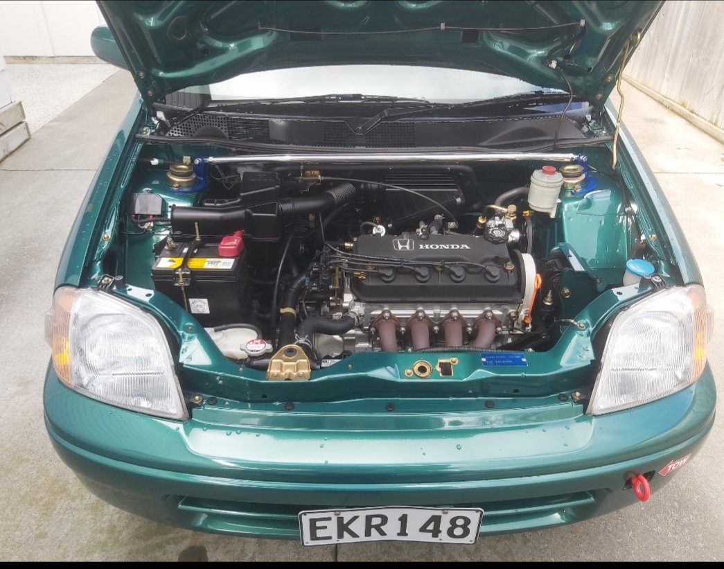

Popular Post kp60nick Posted September 26 Author Popular Post Posted September 26 June 2026 Sooooo started the engine swap. With a deadline of being finished before os drags. Nothing special just a low kms d16 non vtech. Not going to open it up just do timing belt, water pump, gaskets and seals. It started with just a normal tidy up engine block and all engine accessories. I prefer to paint the block if you get a good adhesion it doesn't flake and you dont get the oxidation of the aluminum. Ive found a good basecoat colour that looks fairly close to vapor blasted aluminum. Before I pulled the d13 engine there was a few things that needed attention. First was the back half of the body hadn't been painted on the underside. Jacked it up as high as I could Removed the axle rear suspension and fuel tank Masked up the car in the garage prepped and painted the floor. While the rear end was out it all got a tidy up of satin black. End of part 1. 14 Quote
Popular Post kp60nick Posted September 26 Author Popular Post Posted September 26 Time for engine out. When I was doing the tear down. I noticed the tyres had hit the corner of the front tubs potentially with old suspension but if there was a time to sort it out it would be now. I had no intention of repainting the engine bay but when pulling engine out some of the spider rust on front crossmember had started to pox out again. Plus with the tubs needing some attention a quick flick of paint over the whole bay didnt seem to bad. So another garage paint job. Ended up painting the whole underside of the car again. End of part 2 9 1 Quote
Popular Post kp60nick Posted September 26 Author Popular Post Posted September 26 Time to assemble engine and bring it home to put it the hole. As normal Denis from Terei brothers in kelston sorted me out with my gold addiction. Purchased a new clutch and light flywheel. Bolted gearbox to block and slid the engine under and engine craned it up to the mounts. everything got a coat of black or silver reassembled rear suspension. Repainted the panhard bar Cusco blue. Ended up repainting front sway bar Cusco blue as well, had heaps left over Still yet to paint rocker cover. Need the temperature to be above 16⁰ End of part 3. 12 Quote

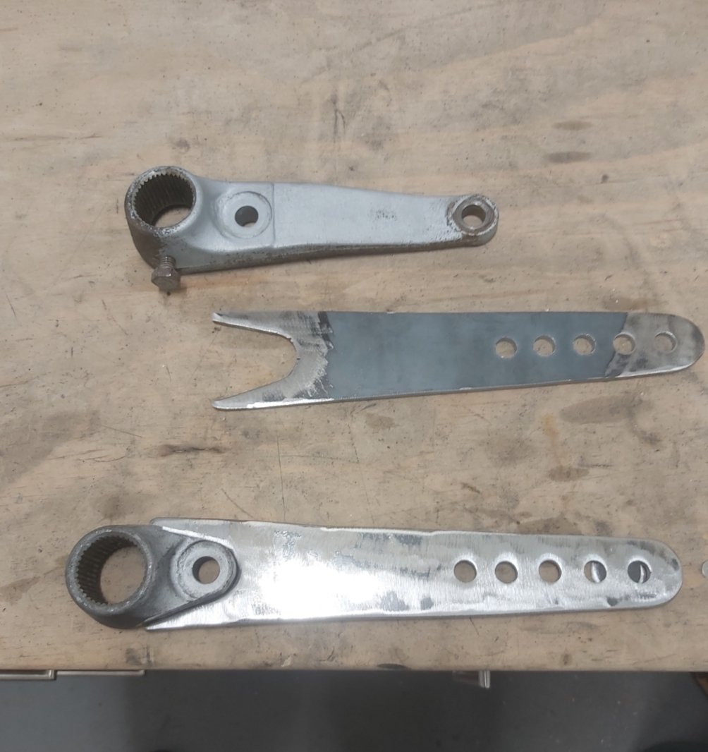

Popular Post kp60nick Posted September 26 Author Popular Post Posted September 26 Im missing heaps of detailed stuff. Its been a crazy few months taking everything apart cleaning, painting rebuilding. So many hurdles along the way lots of things I haven't photographed. One major part has been steering rack rebuild, it had play in the center and once it was tightened to take the play out the outer ends would bind. So it needed a new shaft but there's no replacement parts for them. After trying one of the power steering shops in Auckland they couldn't help me. Strangely they kept asking about the value of the car weather it was worth my time to continuing with it because the parts and labor would be more than the price of the car. Got a second option from Porana power steering. He came up with a solution that didn't involve a new shaft and while he was at it he removed power steering for me to tidy up the bay. Next part was camber tops. Went down to my favorite suspension shop in town Race shock specialists. I should have done this when he built my struts originally but oh well. Because of the extra height added from. The camber plate and bearing he had to shorten the body to keep it all the same height. Super happy with the results looks like it will have around 2.1⁰ negative. End of part 4. 15 1 Quote
