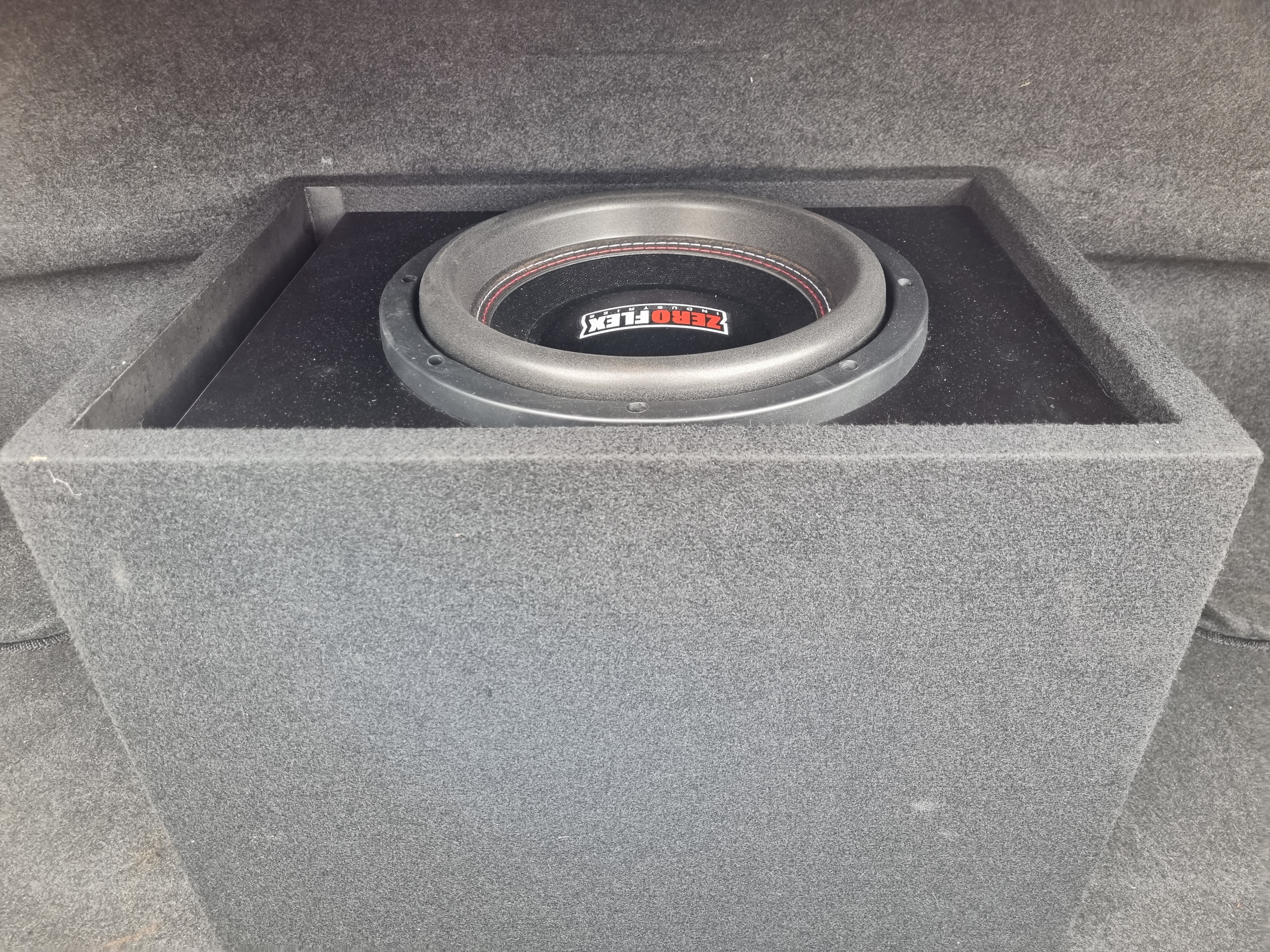

Popular Post sheepers Posted August 6, 2022 Author Popular Post Posted August 6, 2022 New stereo. Factory system was OK but no Bluetooth no hands free etc. So I replaced everything. Had to re route some of the factory loom and patch in a couple of wires but it was pretty easy. Running the power feeds under the car was the hardest bit, fuck I can't wait until I get a shed with a hoist. So anyway head unit is a kenwood one. It's got buttons and shit. There's a 100x4 amp under the drivers seat and a 600w amp running the sub. Front doors for a pair of boston 6.5LF pros that I've had for a while. Had to cut the hole or a bit to get them in but the rest was easy. Rear doors got some 5" alpine things that work great. Sub is a zero flex 10" which absolutely cranks. I'm still fucking with the steering wheel controls to see if I can get some basic functions working off the steering wheel, time will tell in that one. 18 Quote

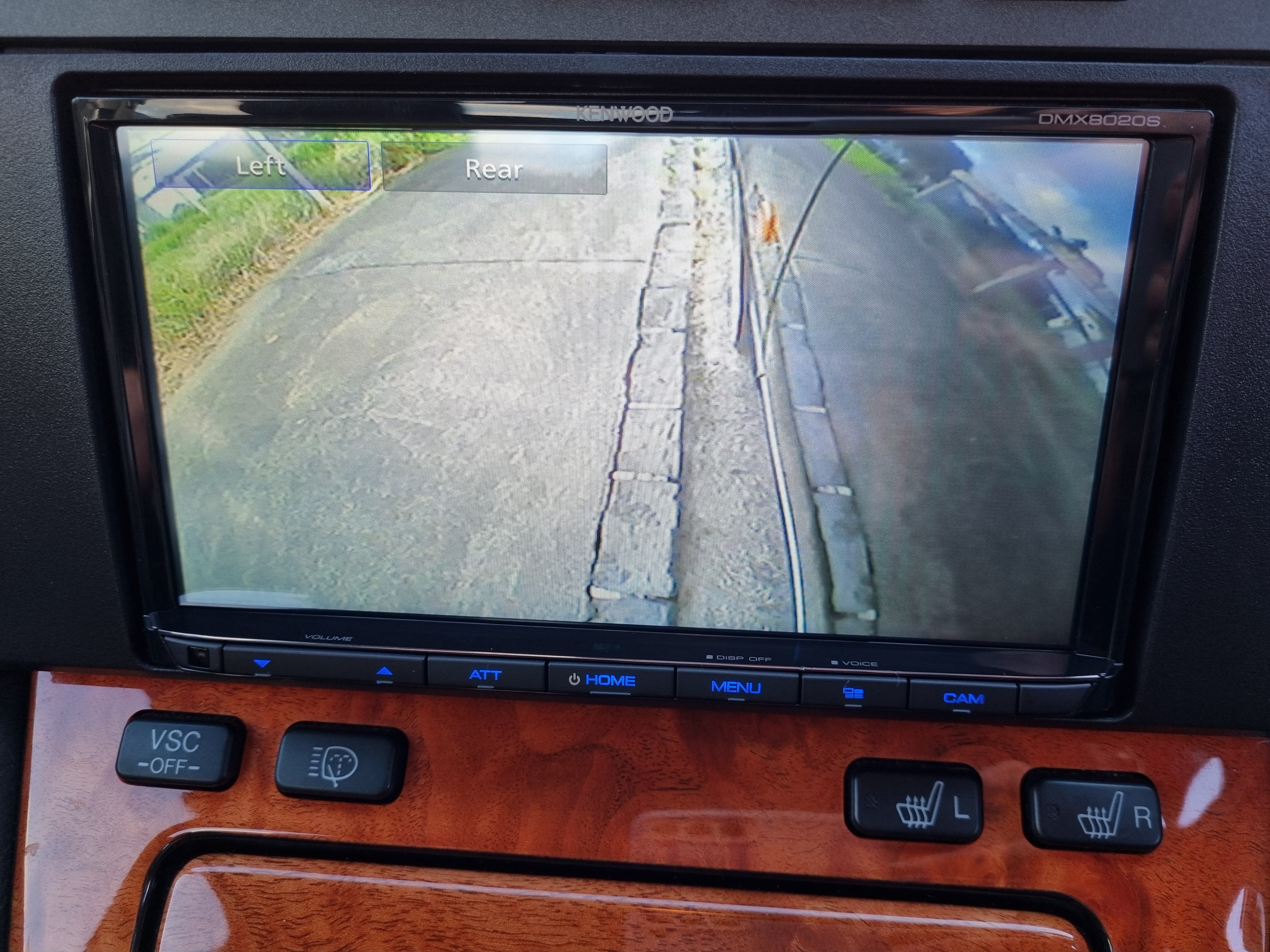

Popular Post sheepers Posted August 28, 2022 Author Popular Post Posted August 28, 2022 Reversing camera. And also side view camera. The new head unit has twin camera inputs. The reverse camera works as per normal I.e when the cars in reverse but the other one is selectable with just a button on the bottom of the head unit so you can turn it on whenever you want. I thought it would be a good idea to put a camera in the left side wing mirror so I can see the kurb when parking. Because I can't drive that would be a good thing to stop me driving my rim into the kurb.. So anyway mounting the cameras was easy. Running the wires was not. Got there in the end and it all works sure super awesomeo. 34 Quote
