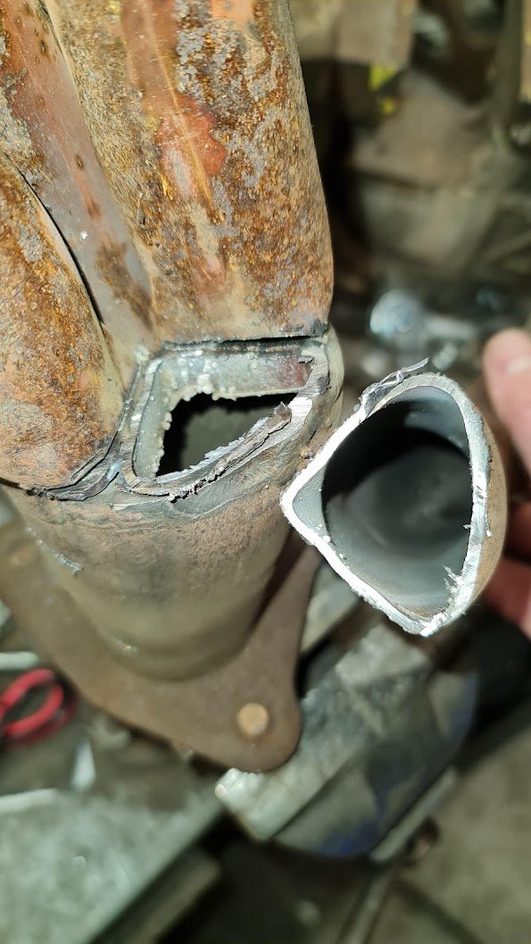

~Slideways~ 2,162 Posted January 8 Author Report Share Posted January 8 Have been driving this everywhere, bit of a tidy up and a new wof. Took the Semi's off and put the super cats back on, man what a difference the tyre walls make it feel like the tyres are flat. Still fun but easy to out drive the grip now. Shame the semi's are so fckn loud, louder than the worst mud terrains I've had! Haven't had a chance to do anything else on the Speeduino yet, needed it as the daily while working on other cars. Out of interest I unbolted a spare 1.6 exhaust manifold to see how bad the collector was to see if they were as bad as Roman's ones. Yes they are. Welded on the inside with a thick bead which is choking it down from the head port size: Look at how much the tube is crushed to fit into the collector! From the inside it doesn't look so bad because you can't see the crushed bit, but based on the outside, they must be bottled necked heaps here? Why didn't they just make the cone bit a little bigger to avoid crushing down all four tubes? Bet if I made a better manifold it'd make at least 2hp across the board. 3 Quote Link to post Share on other sites
kyteler 59,663 Posted January 8 Report Share Posted January 8 Chasing 2HP Roadster life. 3 2 Quote Link to post Share on other sites

Roman 13,462 Posted January 14 Report Share Posted January 14 Haha there must be only one person in japan designing all of the oem manifolds. 2 Quote Link to post Share on other sites
