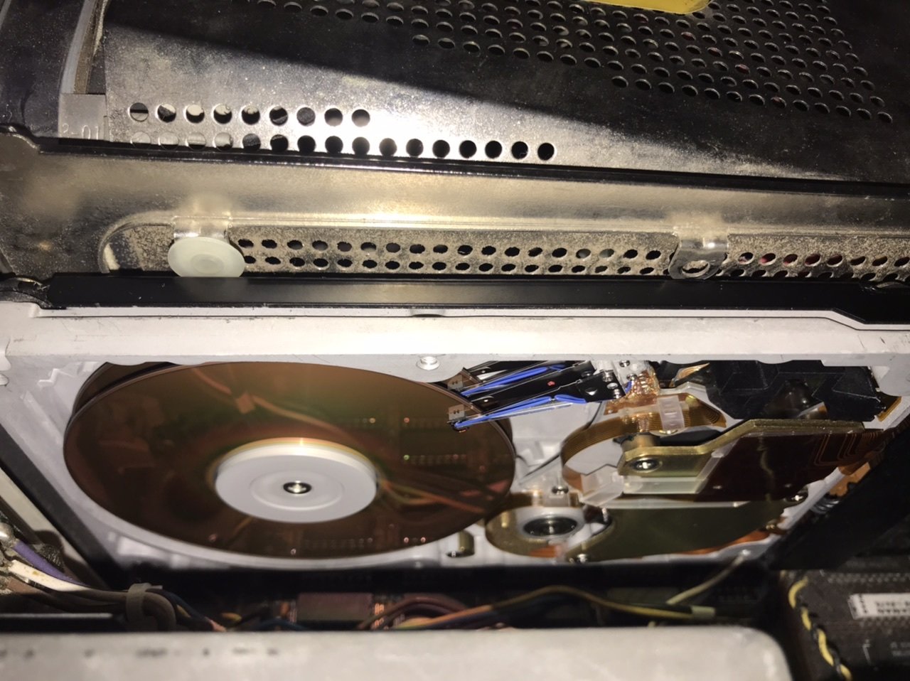

~Slideways~ Posted November 22, 2019 Author Posted November 22, 2019 1701 error is something to do with the hdd or the hdd controller. The fact that is knows to try read the hdd as soon as the card is installed should mean that the controller is working, maybe the 35 year old hdd is dead or stuck. I’ll see if I can take it apart and see if I can unstuck it. 2 Quote

~Slideways~ Posted November 24, 2019 Author Posted November 24, 2019 Holy shit the IBM 5155 hdd is working! All I had to do is take it apart, plug it in while open and give the head arm a bit of a nudge. 20mb of glory. Some read failures but shit, it’s 35 years old! 9 Quote
Popular Post ~Slideways~ Posted November 24, 2019 Author Popular Post Posted November 24, 2019 The initial start up failed to read an executable but it didn’t say what, but then it continued to this: It has Tetris! Some corruption happening here comrades: 13 Quote

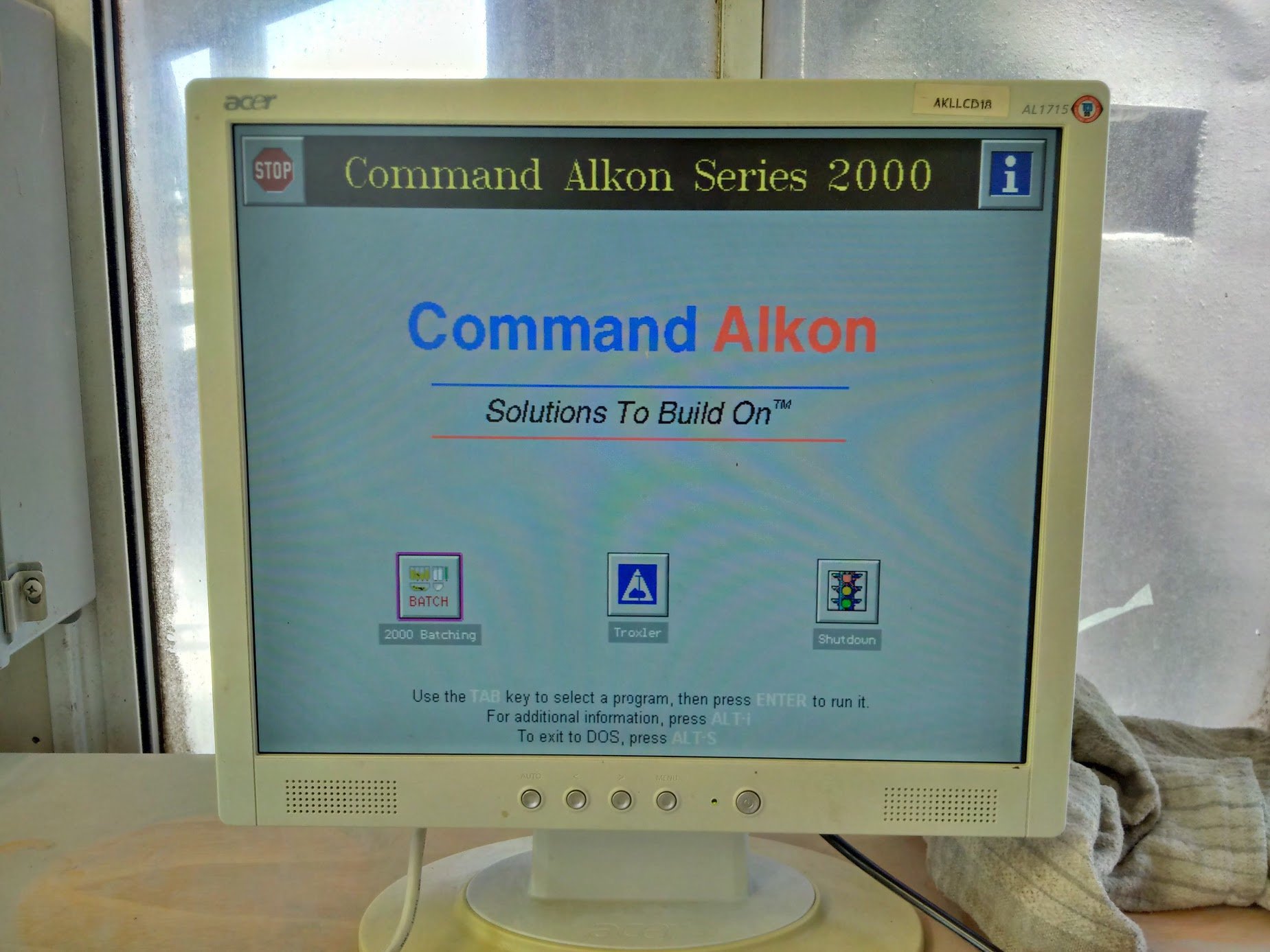

Popular Post Ghost Posted November 25, 2019 Popular Post Posted November 25, 2019 Speaking of industrial computers this was driving our batching plant until we had it rebuilt 2 years ago. AMD K5 PR133 and 8MB RAM was probably overkill for what it was doing: 9 1 Quote
ajg193 Posted November 25, 2019 Posted November 25, 2019 20 hours ago, ~Slideways~ said: Holy shit the IBM 5155 hdd is working! All I had to do is take it apart, plug it in while open and give the head arm a bit of a nudge. 20mb of glory. Some read failures but shit, it’s 35 years old! You're a brave man opening a drive like that. Have you ever had any problems with dust getting on the platters? 2 Quote
~Slideways~ Posted November 25, 2019 Author Posted November 25, 2019 48 minutes ago, ajg193 said: You're a brave man opening a drive like that. Have you ever had any problems with dust getting on the platters? I’ve done it a couple of times and always ended up with a drive that started working when it was previously dead, so it not really brave it’s more like risking killing a dead thing. There were no signs of life except for the controller card was working since it would indicate it was trying to read but failing. 2 Quote
