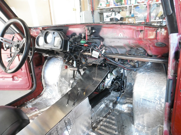

~Slideways~ Posted May 2, 2018 Author Posted May 2, 2018 After doing some research on that VFR800 build it won't be possible on a right hand drive car, even if I were to make it rwd using a live axle to replace the beam axle rear. The driveshaft goes through the firewall where the pedals are on a RHD car. Boo. I've email LynxAE to find out how much their fwd sprocket LSD diff's are. Another option might be to modify a Civic diff, that way I can use bigger civic shafts and hubs/brakes. Quote
