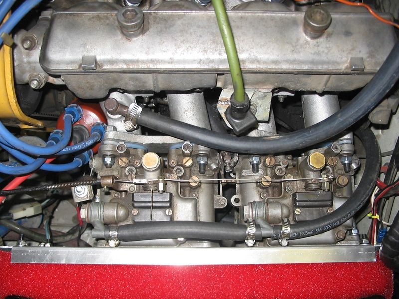

Twin 40 sidedraughts is what you need. I had them on my twin cam Lada and it did the doooorts.
This was only after I managed to find a manifold that cleared the dizzy tho, they are out there.

This is the dream setup. If anyone can point me in the direction of such a manifold...
Do you have carbs already?
I have 2 manifolds (one in use, other has dizzy scoop removed, pending dizzyless ignition 'one day'...)
They pop up on Tme now and again, around the $200 mark, 125T specific and NZ made NZDM yo!
I also have a 124 'waffle' fannymould for IDF downdrafts i would sell but there may be strut clearance issues? (have never fitted it up so not sure)
