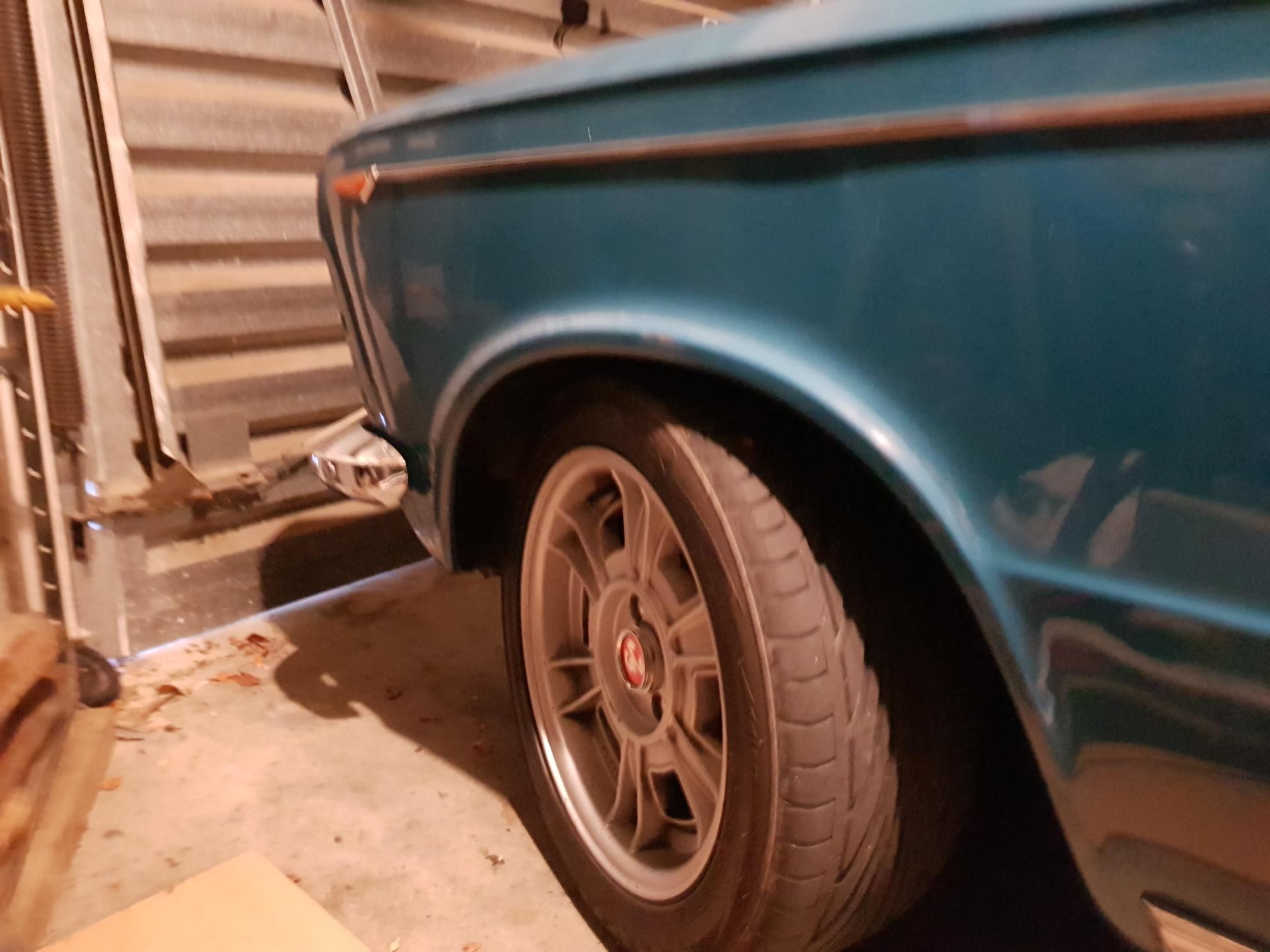

Sunbeam Posted May 20, 2021 Author Posted May 20, 2021 I was wrong. I had a measure up in the shed of the spare wheel. The offset is actually 29. Therefore the CD66 at 7 inches wide with a 10 offset are going to sit 45mm wider. Now I’m not so sure they’ll fit. Quote
epoxy124 Posted May 26, 2021 Posted May 26, 2021 Hi I've got a 125 with some US CD66 replica wheels that have been on for a couple of years. https://autoricambi.us/cd-66-style-wheels-15-x-7-set-of-4/ They are 15x7 and 23 offset. Fit perfectly, very snug at the rear which is just how I like it, no rubbing but wouldnt want to be any wider track there. No issues at the front either. With 205/50 15's the steering etc is very similar to the 185/70 13's that were originally on it prior to mods, of course the suspension is lower, stiffer etc now so apples to oranges. The track width is a bit wider but wheel centrelines not much different to original, maybe a cm or two wider. 4 Quote
Sunbeam Posted May 27, 2021 Author Posted May 27, 2021 Thanks for chipping in @epoxy124! I have seen the 15 inch versions are available in different offset. Can we see some more pics of the car please. I’d like to see a shot of the whole car, you don’t see many fiats with 15 inch rims. I think a fat 13 suits the car, but I’d like to see yours! ps. Are you running with or without the factory “spacers” Quote
epoxy124 Posted May 28, 2021 Posted May 28, 2021 The back has the standard steel spacer plates on, and the front doesnt - the brake disc hats are a bit thicker than the originals, pretty much exactly the same as the original + factory spacer. :) I put them on before lowering the car and it did look a bit like a square roller skate. I'd like to try something like a 15x7 Rota Shakotan but $$$ 6 Quote
Sunbeam Posted May 28, 2021 Author Posted May 28, 2021 That’s a nice, straight looking car. Think it should have its own thread. Nudge. Personally I prefer the look of the 13 inch CD66, but certainly you have given me an alternative to consider if I can’t make em fit. +1 on those rotas too. Lovely. Quote
