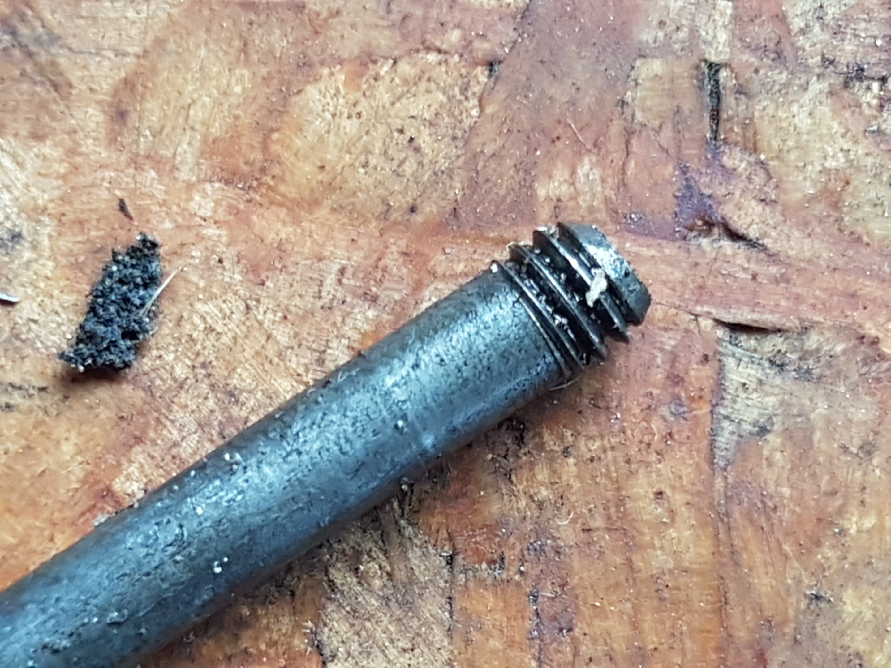

The eagle eyed amongst you will notice that there's only 3 cylinder studs. #4 was super loose and was able to be removed by hand.
Hmm... This seems short...
The stud had snapped at the thread at some stage. There's still a hunk of bolt stuck down the hole and the top part of the stud hole is pretty munched. Looks like it'll need a helicoil.

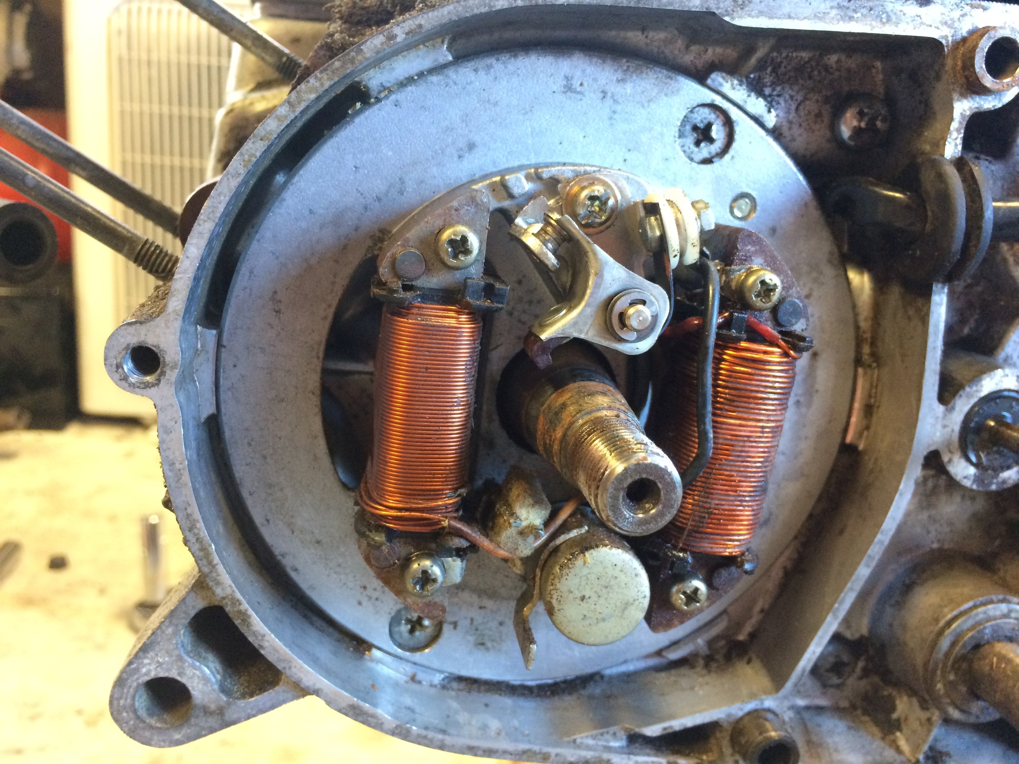

Took the cover off and removed the flywheel to get a look at the points.
The left hand coil has loose windings at the bottom... Anyone seen this before? I think it still works, but might give out soon I guess?
  • Sad 1
Gave everything a quick clean up and set the points. There was so much crap under the sprocket cover!
Gets really good spark now :)
Also investigated the broken stud - I suspect it used to be the other way up and someone sheared the top off when tightening the barrel down, then flipped the stud over to pretend nothing ever happened... The thread is good inside the casing, so all it needs is a new stud and it'll be good to go.
