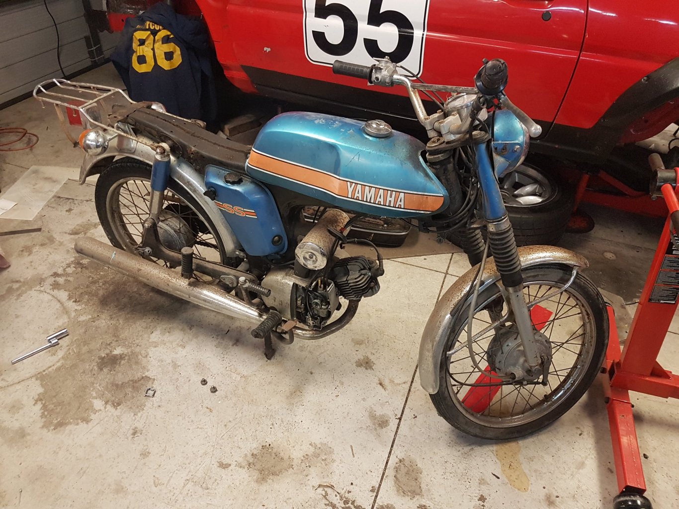

I swapped a bucket seat for this bike a few years back and it's been sitting in my Dad's shed ever since. I had no information about what it was or when it was built, all I knew was that it was a badass 50cc motorbike that I needed. I assumed it was an FS1E.
It's time to do something with it, so I picked it up on the last trip to Palmy and send the engine/frame number to www.yambits.co.uk to figure out what it was - they came back saying it's a 1974 Yamaha FS50 (newer than I expected).
The frame has a small amount of rust, but it's easily fixable, and there are a few other things that need sorting - stripped spark plug thread, possible points issues and it sounds like the rotary valve is out of time.
I'm in two minds about what to do with it. Most of me says modify it into a small cafe/brat style bike and another small part says restore it back to normal... What do y'all reckon?

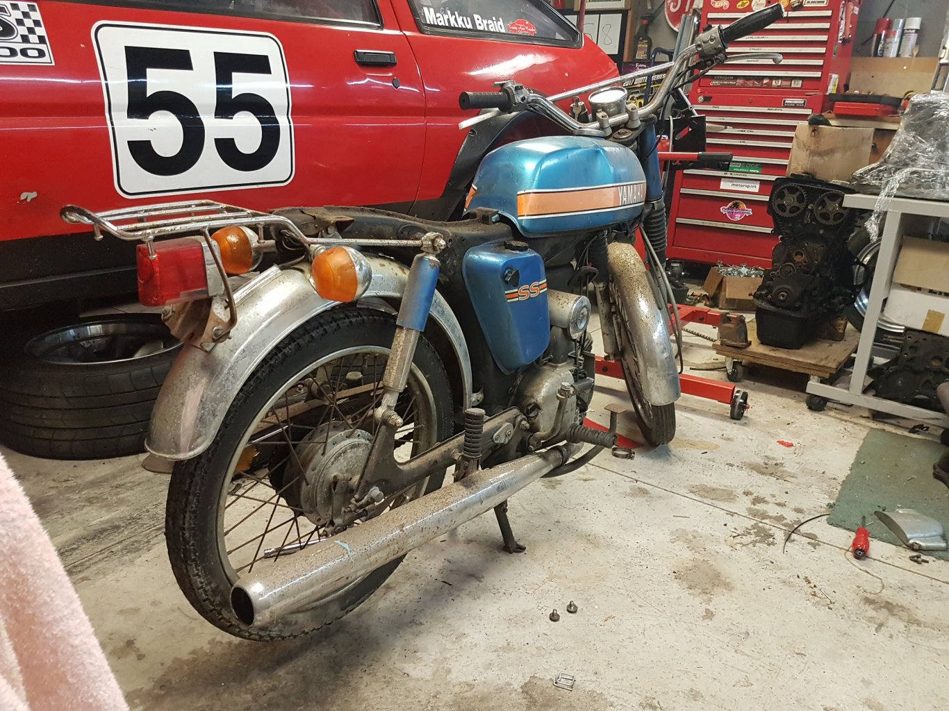

I think I'll get started by pulling it to bits and giving the frame/tank/motor/trans a recon and will decide on mods afterwards.
The plan is to make everything reversible to keep its collectible status but I'm dead keen on low bars and a sweet seat... possibly forks and wheels too. Will see how it pans out.

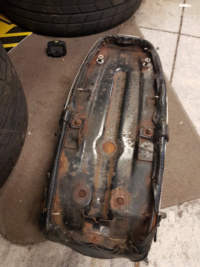

Pulled the seat off and the underside of the seat looks tidy enough. There's a bit of surface rust but nothing to worry about.
Seeing it with the seat off gives me ideas to make it more of a scrambler...

It goes... Kinda...
Gave the carb a rebuild using the kit that @Threeonthetree sent down. It runs OK, but doesn't pull very well and won't rev. Next thing to check is points which will require a flywheel tool.
If you havent yet remove the entire exhaust system and burn off all the carbon build up as this will choke your engine alot. Alot of different ways to do it but I usually stand upright on a bare concrete floor and pour petrol down exhaust and carefully light it up and use compressed air to get super hot and to blow melting buildup out other end
