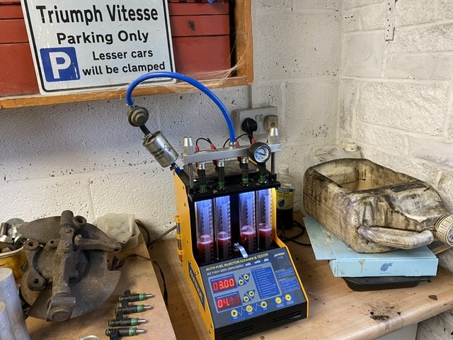

VitesseEFI Posted August 24, 2023 Posted August 24, 2023 Cleaning and matching a set of injectors for my son’s sigma SE into Spitfire conversion. Quote
