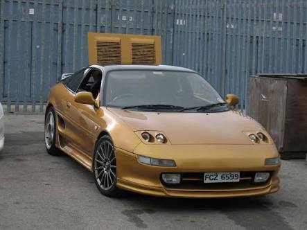

kyteler Posted February 22, 2016 Posted February 22, 2016 I'd rather those than these: This look would be alright though, I reckon. Could even put some covers on them. Quote
mjrstar Posted February 22, 2016 Author Posted February 22, 2016 Might try and find some rectangle buggers like these.. (not sure how to link pic but there is a ok looking red mx5 with flares, the recessed ones are going to perhaps be hungry on depth http://www.topmiata.com/shop/jass-performance-low-profile-headlights/# Quote
flyingbrick Posted February 22, 2016 Posted February 22, 2016 https://encrypted-tbn0.gstatic.com/images?q=tbn:ANd9GcSCywasxyGmqYJInKJbRC-xrfl70Ct81CL2qOjvXWgktBh50mytrmhqnon0BA Quote
kyteler Posted February 22, 2016 Posted February 22, 2016 https://encrypted-tbn0.gstatic.com/images?q=tbn:ANd9GcSCywasxyGmqYJInKJbRC-xrfl70Ct81CL2qOjvXWgktBh50mytrmhqnon0BA Yuck. 1 Quote
BlownCorona Posted February 24, 2016 Posted February 24, 2016 The rx7/z31 looking ones that kyteller posted look so sweet, +1 for that Quote
mjrstar Posted February 26, 2016 Author Posted February 26, 2016 Im sure we all crapped on about headlights 10 or so pages back? Quick helpful service from these guys.. Will be interesting to see if it stops well enough or if a plan 'C' needs to be hatched. Quote
tortron Posted February 26, 2016 Posted February 26, 2016 you should paint the headlights body colour 1 Quote
