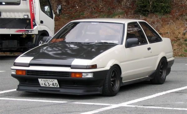

plan was to paint tops of them like so. but have ran out of paint.
need font lip! $3500 retail from toyota! special price was laughable also
Shit.... There are bound to be some plastic ones around. Was trying to convince a friend to use his injection / rotary moulding access to make a whole pile of them. Will see where that goes.
