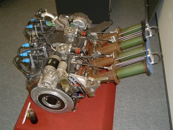

haha should look into getting them full variable instead of two stage, check the picks of the mazda lemans 26B uses what looks like a electric window motor and a cable and pulley system I would post the pics up but there huge!
787B stuff
Would be a prick to setup I'd say plus would need countless hours on the dyno but dreams are free

yea thats a mean setup you have, the pic you showed is the 26B thats in that link I put up which made the page to wide and gay. Yamaha has a two stage setup on there bikes now where instead of the trumpets retracting in length they pull 'in half' sort of to give a shorter trumpet its pretty cool. Wasnt saying to implement the veriable trumpet idea brad just saying its cool! and if I owned dyno it would be mean to setup for a hp or two!
