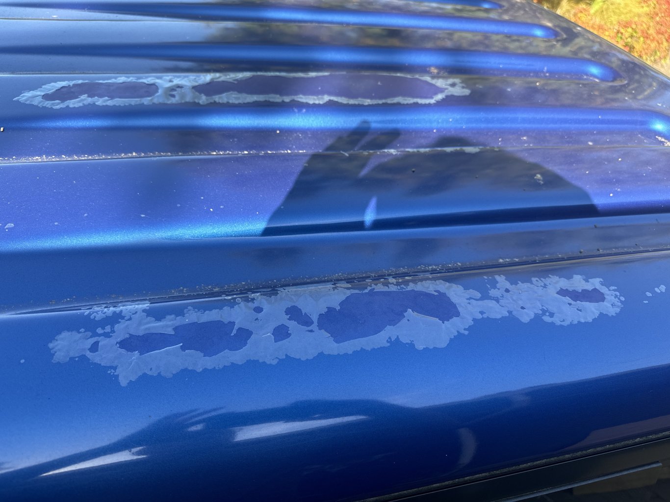

Tiger Tamer Posted February 2, 2025 Posted February 2, 2025 We bought our Holden Colorado new in 2018 and had a canopy fitted at the time. Decided to have it ceramic coated so I didn’t need to polish it. I only wash it with a proper automotive detergent. I have been using the roof racks quite often lately, but when I went to tie some timber on today, I was meet with this. Only on the canopy. Anyone else have had this experience or heard anything similar. cheers Quote
tortron Posted February 2, 2025 Posted February 2, 2025 Clear coat failure, often UV related, probably not anything to to with ceramic coating. Might even have had a touch up, touch up clear seems to lift first from what I have seen Quote
Tiger Tamer Posted February 2, 2025 Author Posted February 2, 2025 Yeah, But the ceramic coating is supposed to stop the clear coat from failing , and it is only 6 years old. we had a Suzuki Swift done a few years before this . Had the same issue on the plastic painted trim but not on the steel panels. Though they were still fine at the time I had the ute done. Quote
mjrstar Posted February 2, 2025 Posted February 2, 2025 I'm not so sure that ceramic coating will provide much if anything in the way of uv protection. I'm with @tortron the canopy re clear failure, it will have a different clear coat perhaps of a lesser quality to that of the rest of the vehicle. 1 Quote
Tiger Tamer Posted February 2, 2025 Author Posted February 2, 2025 I will be talking to them tomorrow to see what they have to say. Both times I was told by two different dealerships the same thing. You never have to apply polish to the paint again. The coating protects the paint from the UV. I totally agree it looks like a clear coat failure and will be. Of course it could well be car dealer BS. 1 Quote
Bearded Baldy Posted February 2, 2025 Posted February 2, 2025 Bet they only ceramic coated the body and tray, and left the canopy. Not that car dealers would do such a thing. 1 2 Quote
cletus Posted February 2, 2025 Posted February 2, 2025 Yeah I would assume the ute itself would be good quality paint and clear, and the canopy will be made in nz and painted locally by the lowest bidder 2 Quote

Tiger Tamer Posted February 3, 2025 Author Posted February 3, 2025 I spoke to the owner of G3 detailing and was told the trouble with the dealership organising it is that they farm it out to whoever does it the cheapest. Probably only good for a year. At the time I thought there was only the one place locally that did ceramic coating. That and the quality of paint used on the canopy won’t be the same quality as on the ute body. Probably as Cletus said I would think. I think I had better get some polish on the ute body rather quickly. 1 Quote

jjerm Posted February 4, 2025 Posted February 4, 2025 The main issue in these situations is the body is painted in a totally different manner to the plastic canopy as is in this picture. It is a clear coat issue as the base coat is still there. Super common on nearly all aftermarket painted plastics 2 Quote
Tiger Tamer Posted February 5, 2025 Author Posted February 5, 2025 18 hours ago, jjerm said: The main issue in these situations is the body is painted in a totally different manner to the plastic canopy as is in this picture. It is a clear coat issue as the base coat is still there. Super common on nearly all aftermarket painted plastics The ceramic coating is supposed to stop the clear coat from failing. But as I have now found out when it is organized through a car dealer you get the quick and short term coating. Not that I knew that at the time. I think the cost was $600.00 at the time. Quote
