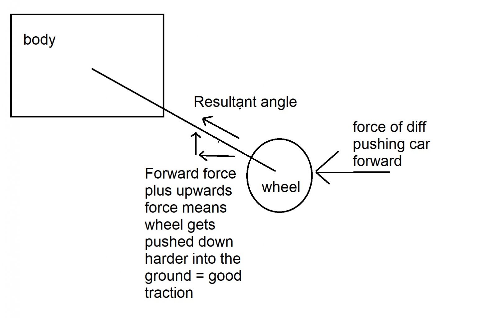

Roman Posted March 21, 2021 Posted March 21, 2021 The bane of my existence with a lowered 4 link setup on a standard Toyota one. Is that the 4 links at standard height are meant to slope down towards the diff. Because when they do it works like this Then when you are hard on the brakes, the opposite happens. (which is also good) The angle of the bars pulls the rear of the body back down, so works as anti dive of sorts. However when you lower it enough that the bars are beyond parallel with the ground, so they now slope up towards the diff. When you launch hard off the line, it tries to pull the body of the car down instead, which because of intertia saying fuck you means it lifts the wheel up instead. So grip completely sucks. Then under braking, it jacks the rear of your car sky high because the pulling force tries to lift the body. I would set 4 link angles so that you're a fair margin away from having bars parallel with the ground at its static angle Quote

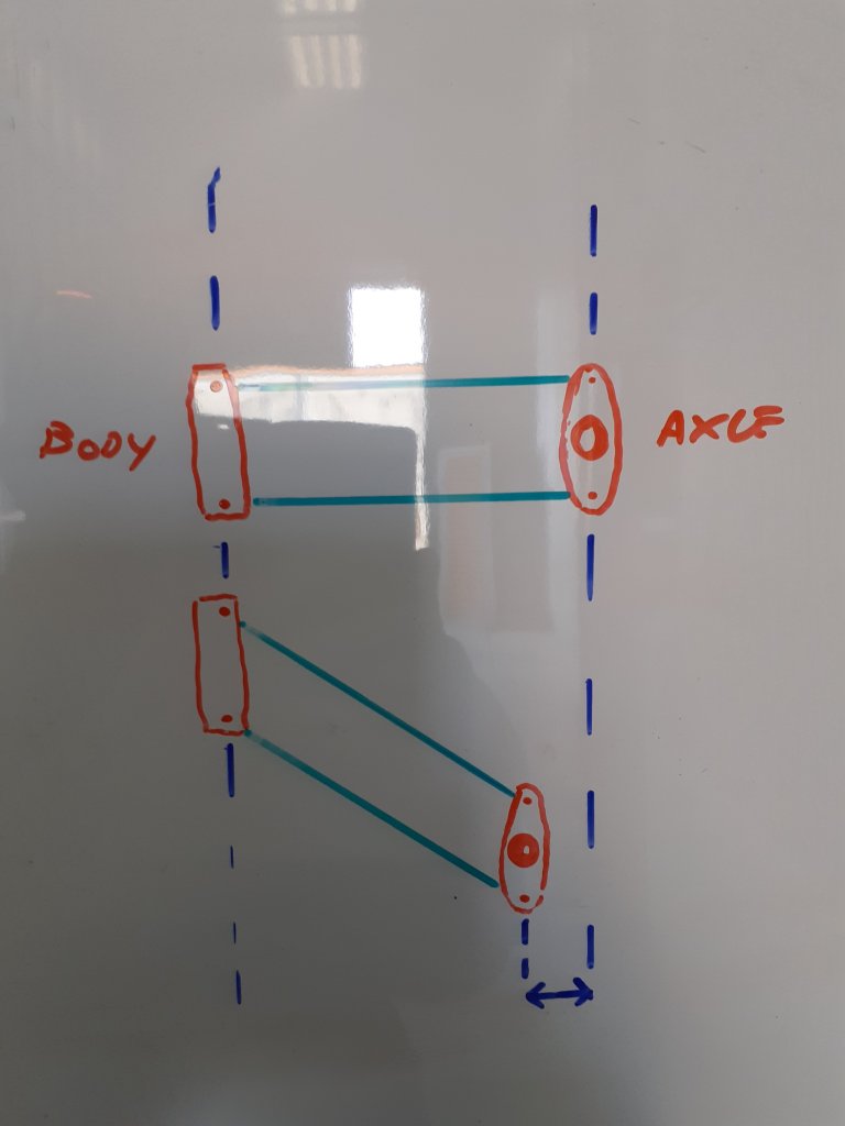

cletus Posted March 21, 2021 Posted March 21, 2021 Roll steer is caused by the link arms shortening or lengthening the wheelbase on one side, kind of like how a skateboard works This pic is exaggerated (maybe not if you have a jeep or safari haha) 5 Quote

zep Posted March 21, 2021 Author Posted March 21, 2021 Ah right. And as the bars shorten it pulls that side of the diff in an arc towards the front of the car, effectively steering with the rear. I think I need to figure out my travel next - can't imagine it's heaps though! I'll check out the 3 link version. Quote
