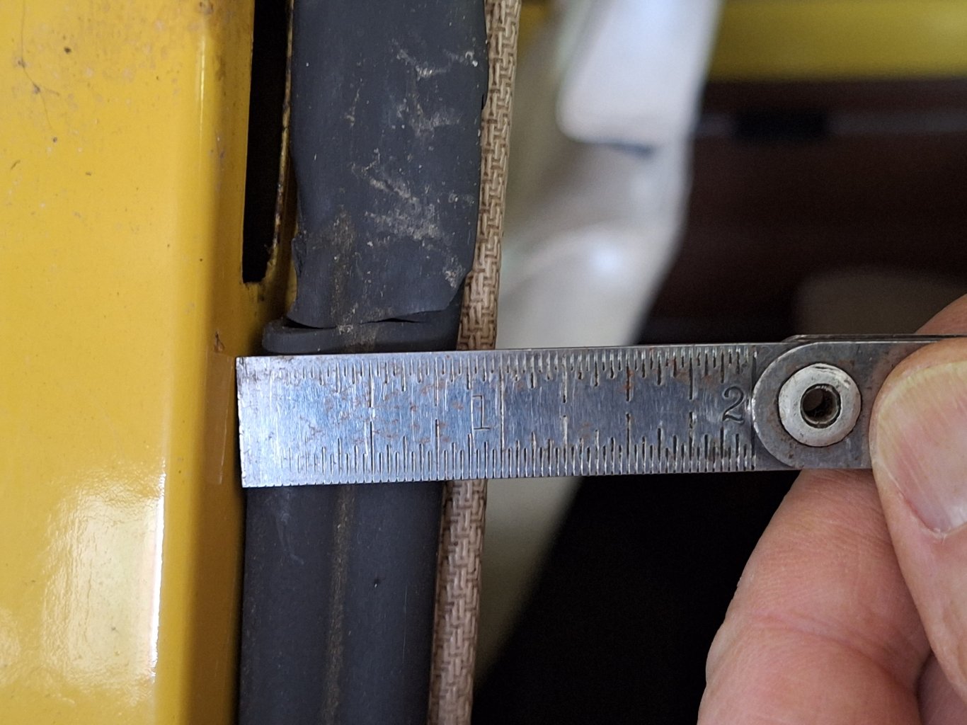

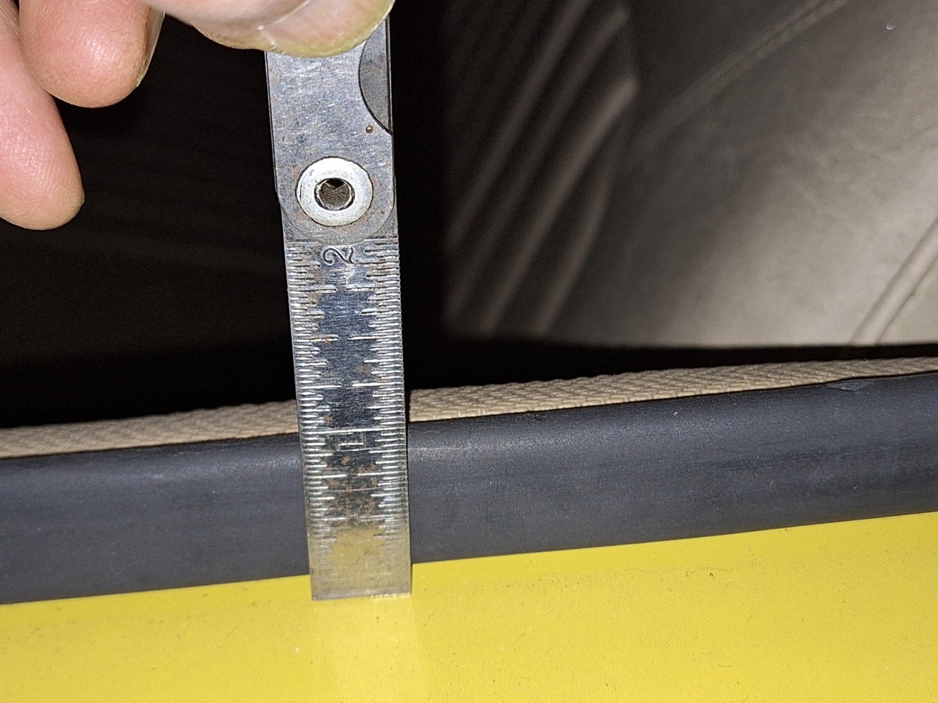

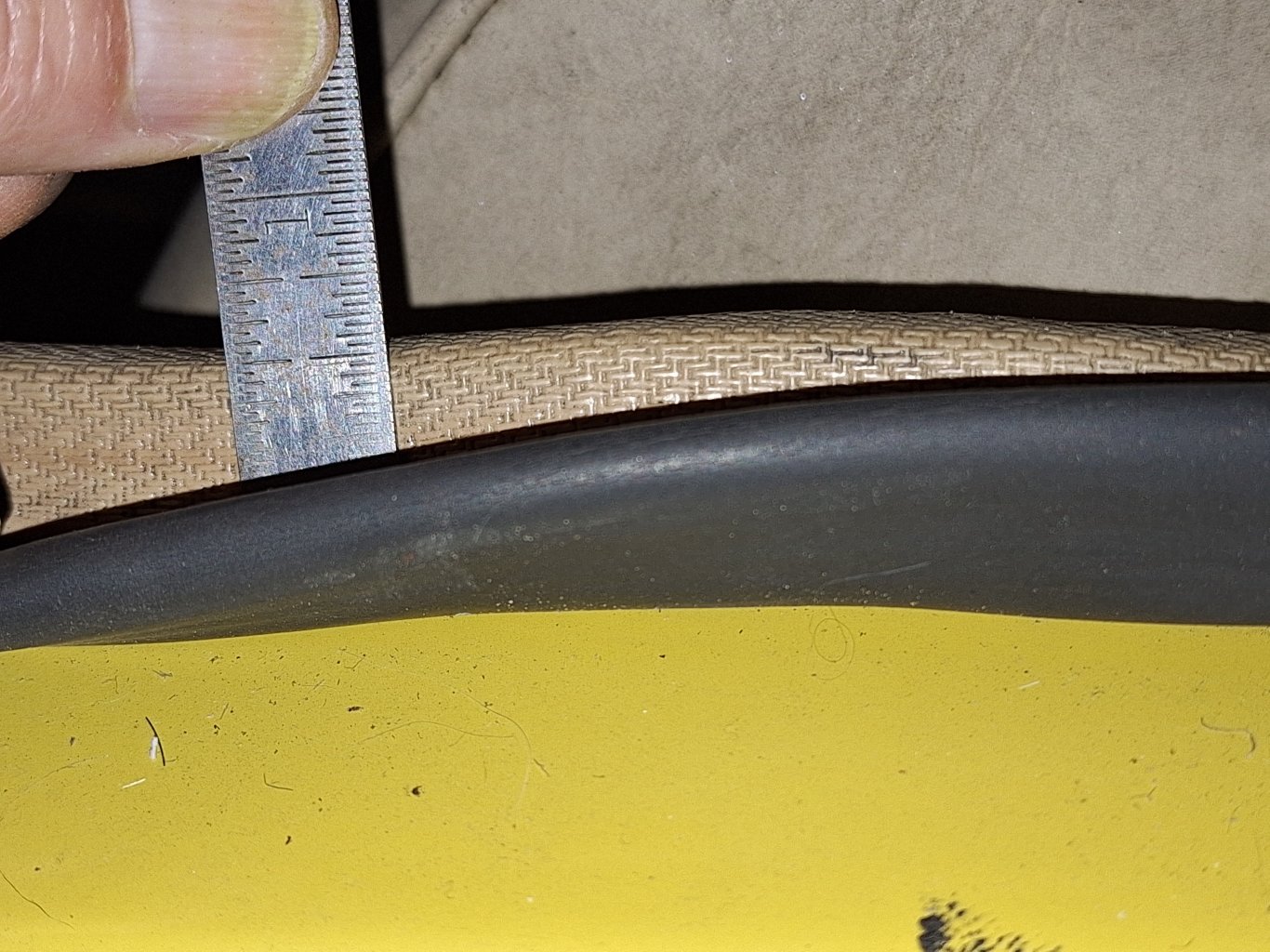

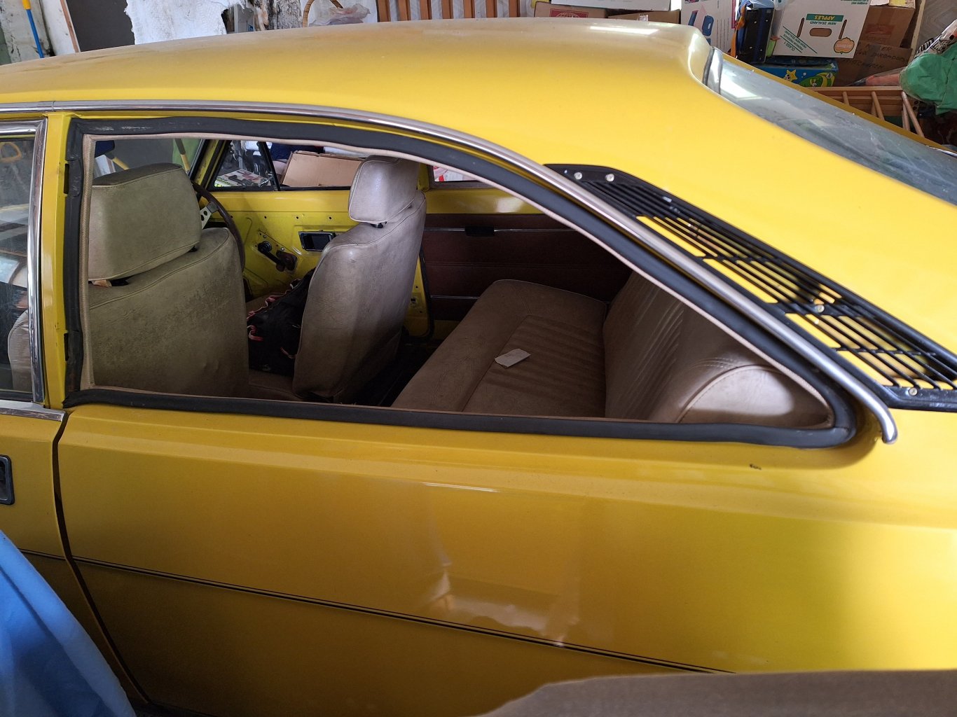

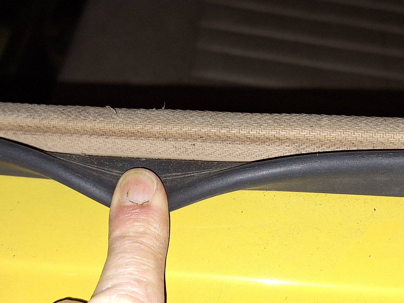

locost_bryan Posted October 29, 2023 Posted October 29, 2023 This is the seal for the opening rear quarterlight windows. It's basically an oval tube with a piece on the bottom that goes onto the window frame. Measurements are with an old imperial feeler gauge ruler. I suspect that, since the hinge blocks are identical to ADO16 ones, the seal might share the same profile. Quote
kws Posted October 29, 2023 Author Posted October 29, 2023 Thanks @locost_bryan that's exactly what I needed. That's different to the weird two-piece seals the donor car had (which in hindsight I should've grabbed for a sample) but look to be exactly what I was thinking of fitting, definitely gives me something to work off. Quote
