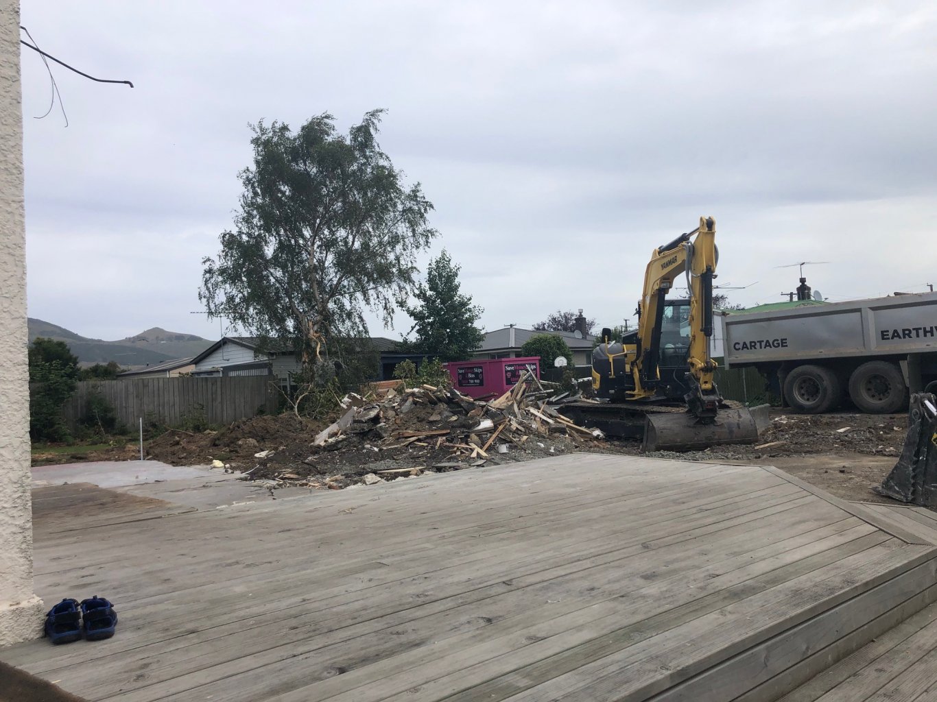

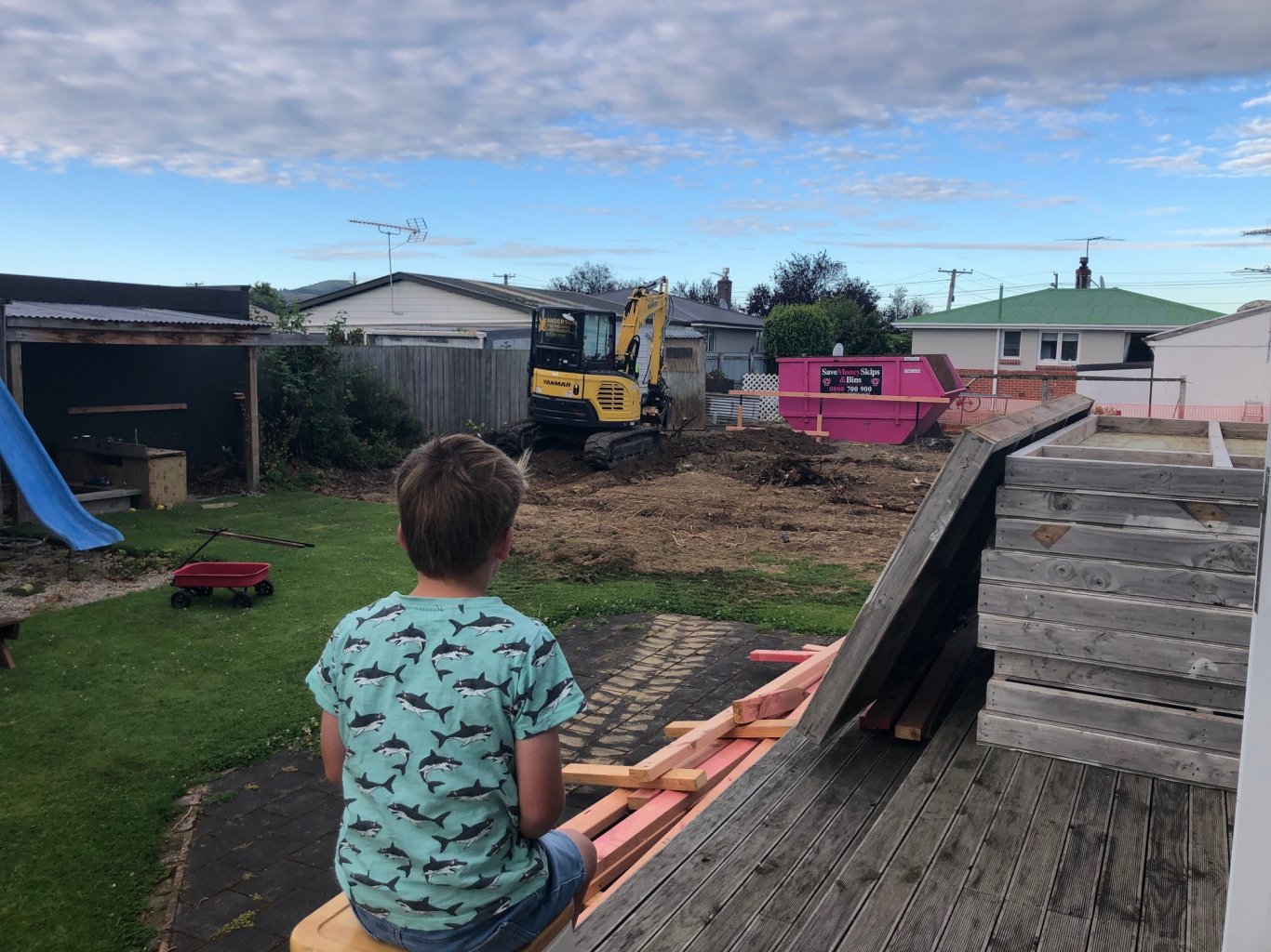

nzstato Posted February 1, 2021 Author Posted February 1, 2021 At this point I had the 'grumpy client call to contractor' moment - I had specifically had a conversation that I wanted the tree in the corner kept wherever possible, then I had my wife message me that it was gone when she got home. It ended up needing to go to run the services but called them out on poor communication and that they have pulled down our fence with the neighbours without replacing it. They've made a hell of a mess digging the foundations first (and found all of the old pipework in the process) rather than digging the new services, making the new connections/getting rid of the old so then they could dig foundations at will. Obviously had an effect as there was a 'site meeting' within 10min of my phonecall whereby the civil subbie has been advised the direction this now needs to be heading in... The boys do enjoy watching the diggers..... Thats kinda up to date to now, it's just build progress from here. At the end will probably have sections on the legal aspects of a subdivision and my all of my final numbers to figure out if this was even financially worthwhile. Anything else I'm missing as unanswered questions? Cheers Quote

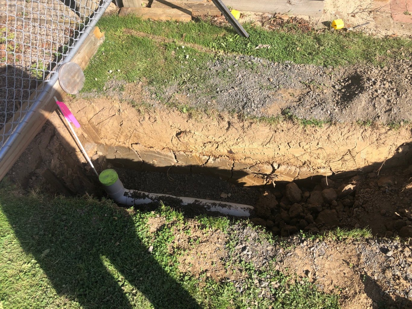

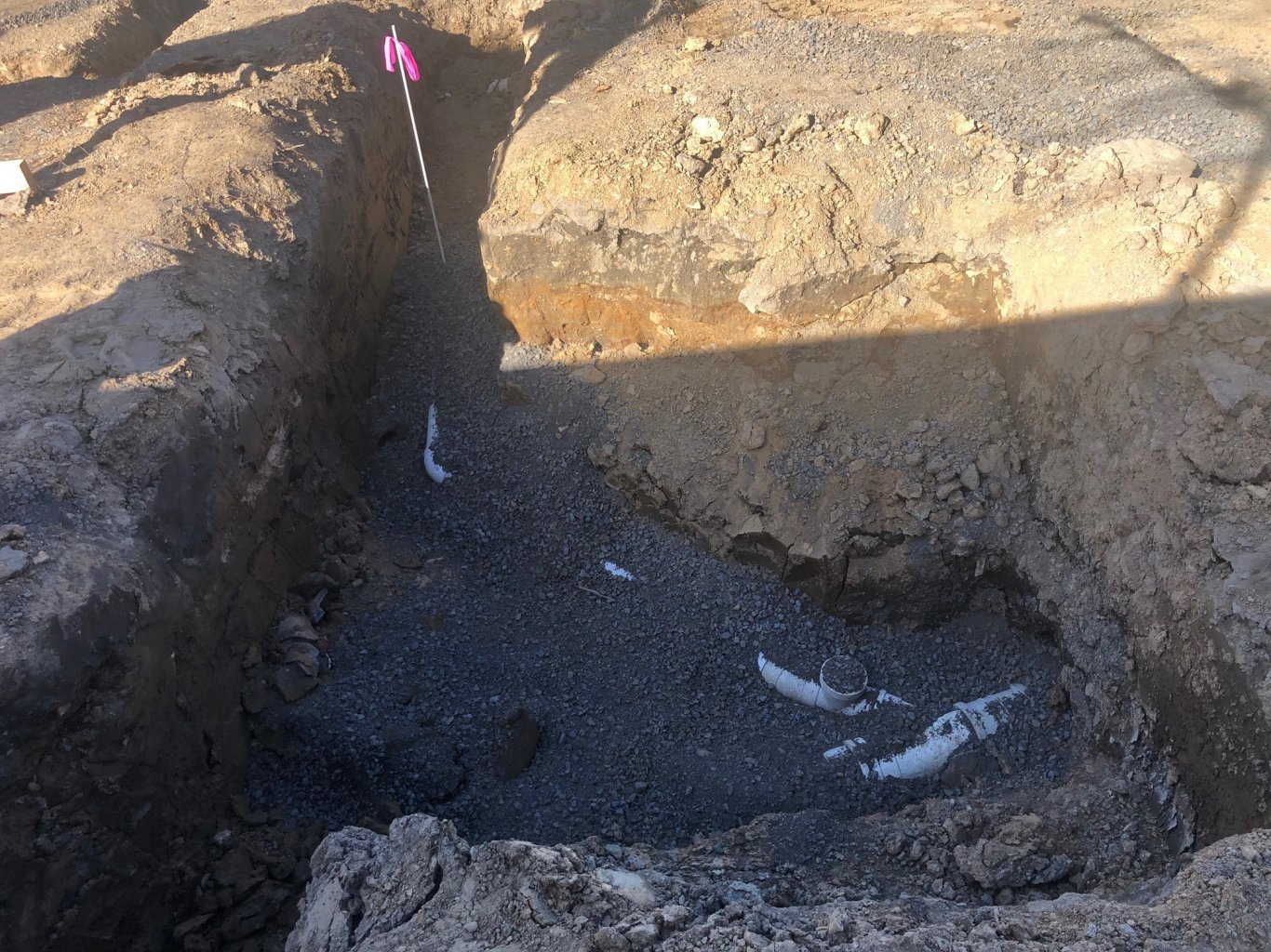

nzstato Posted February 16, 2021 Author Posted February 16, 2021 After a few setbacks we are starting to see some progress again. We have a new fence to separate ourselves from the neighbours, after a few grumbles on when/where it was going up from those next door I am yet to hear a thank you.... Also the storm water connections have all been made. They were able to use my existing connection to the main as the new connection for LOT1 (below) My temporary connection uses the new one which will end up for LOT2 and we have one there waiting for LOT3. Now they will tidy up the dirt piles on the section a bit, build a fence between us and the build and then start on the footings for us to get some concrete in the ground... Market is roaring on regardless, very little stock in Dunedin. A future post will go through how we have gone through the sales process -> currently undecided if will sell privately (my job is in sales) or if through an agent but expect them to be put through the wringer Quote

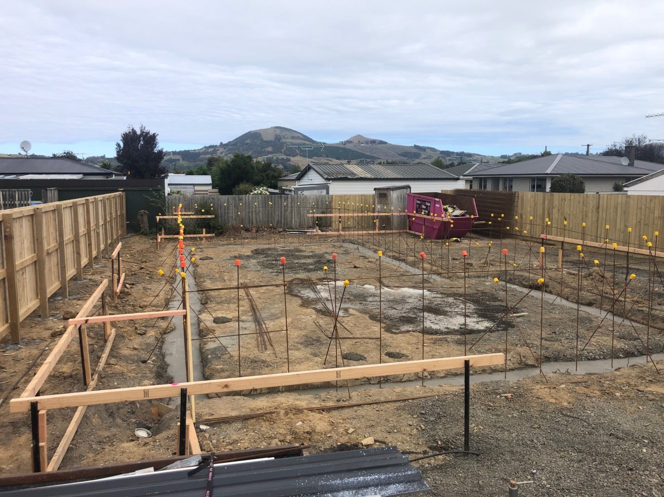

nzstato Posted February 25, 2021 Author Posted February 25, 2021 Site is looking better now, footings are in and remainder of the fencing is in place. Blockie is coming on mon. Quote

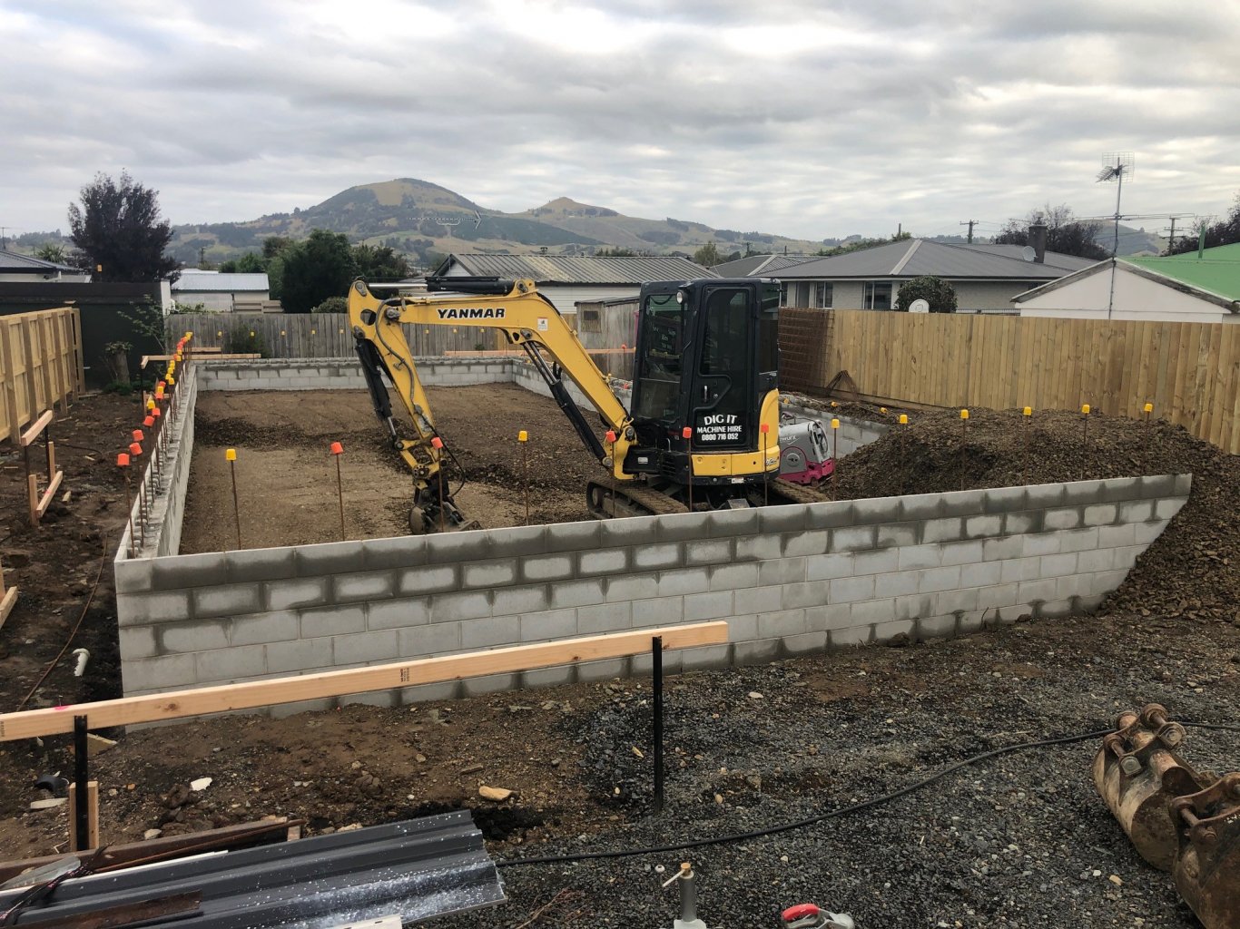

nzstato Posted March 11, 2021 Author Posted March 11, 2021 Little bit more progress... they're back filling the foundation, you can see we've had to come up quite high on the blocks to satisfy the floor level with the council (flood hazard zone). It wont look as pronounced once we get the ground level back with some fill/top soil and there will be a small bit of decking around the front here. Have also had my negotiation hat on for the provisional cost revisions which are coming back, keeping em honest. Quote
Sunbeam Posted March 11, 2021 Posted March 11, 2021 Wow, that does look high when you see it like that. Quote
