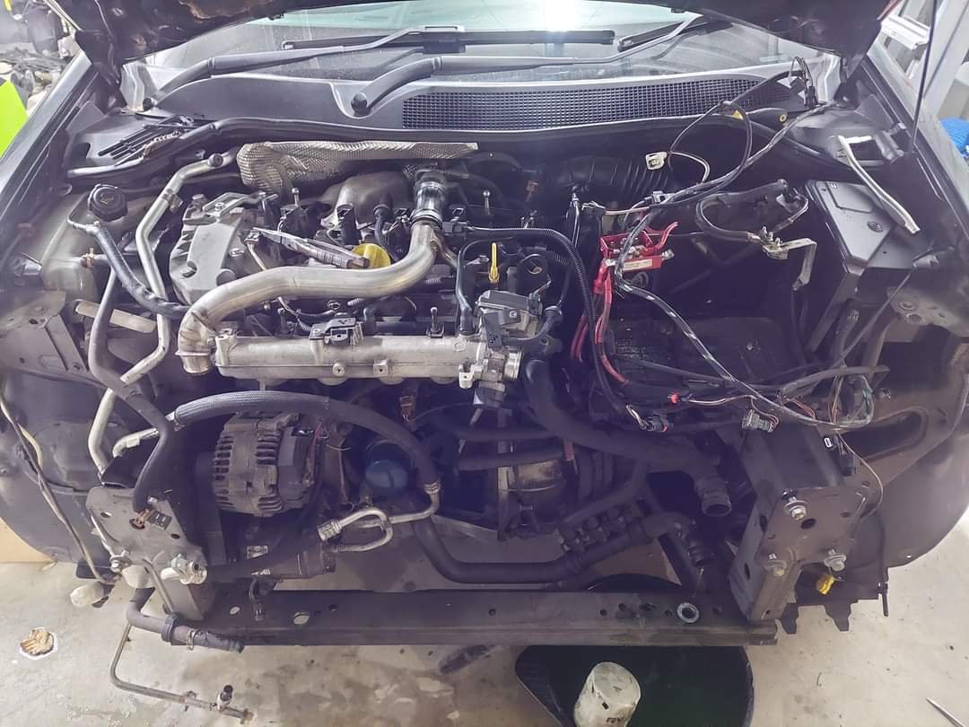

  1. She lives! Filled up the engine oil, gearbox oil and coolant. Fitted up the wheels and put it on the deck. Hooked up the battery and gave it a go. Surprised as it started first go, no visible leaks. Didn't rev it up or anything as it needs the tuner box hooked up and a proper tune, also need to swap the fuel pump over from the 265 due to the new system being rising rate so it has a different internal fuel reg. Stoked!

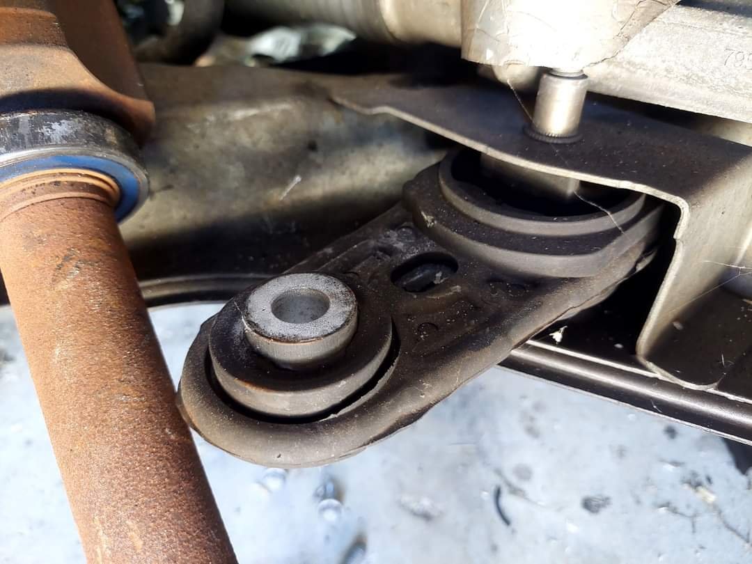

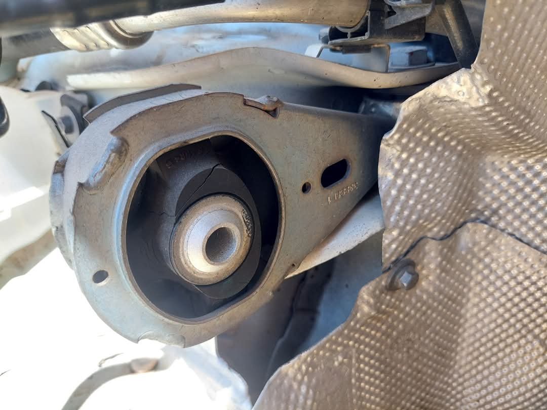

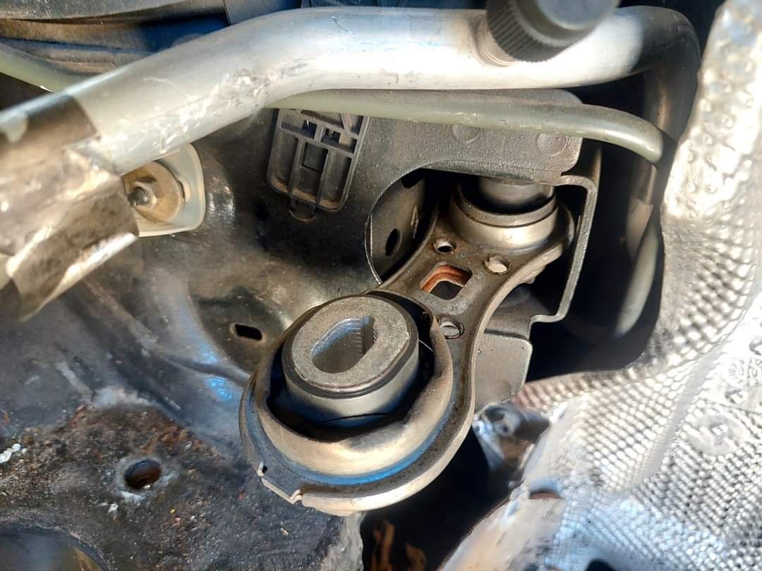

  5. Small daily update. Refitted the lower engine stabiliser mount - I've reused the old one, the inserts I've purchased only replace one of the bushes that's torn, not the other so I'll look at just buying a replacement unit. I also got my spanner back and finished tightening up the transmission mount. Exhaust fitted. I had to swap the rs225 intake pipe onto the turbo to get better clearance over the brake slave cylinder. So cleaned it up and fitted it. I also bought some vacuum hose and fuel vapor hose for the breather piping. Rerouted everything to suit and re routed the fuel line as they're different across the 2 cars. So now the fuel lines are sorted, crankcase vent pipes and inline valving is sorted, and Brake booster hose sussed out. I'm not overly happy with the fuel hose layout so I'll change it over later. Luckily I could reuse the push oem push lock fittings. I ended up just hose clamping new hose onto the barbs. Chur

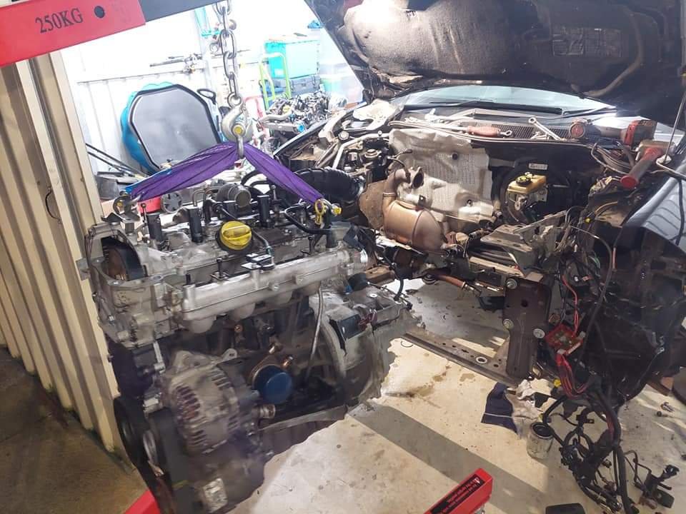

  6. Cue "It was a good day - Ice Cube". Donk and box back in the hole. Oil filter housing/oil cooler swapped over aswell with new filter on. Just awaiting pick up of my work ute tomorrow (as it's having some recall work done) so i can get some other tools i need to carry on with assembly. Stoked as to see the gap filled! Chur

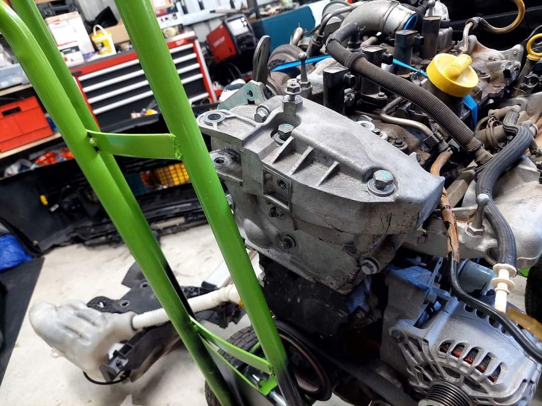

  7. Drilled and tapped an additional mount hole for the engine upper timing cover/engine mount. This is due to a variation between the 2 top covers and the 265 inlet manifold not having the provision for the additional mount. Upstream o2 sensor back in and rs265 exhaust cover fitted. I did a half ass job trying to clean off some of the melted plastic from the engine bay. And lastly for the night ive swapped over the lower engine stabiliser mount and rh drive shaft hanger from the 225 engine. Hopefully I'll have this bolted back in the car tomorrow evening. Chur

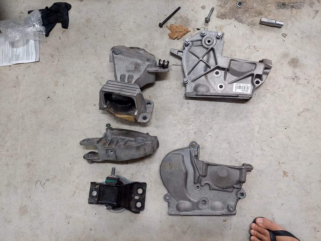

  8. Couple hours in today. Looks like the breather/decanter plate has been leaking (top plate on the rocker cover). Removed it, cleaned it up and refit with some Three bond sealant. Also cleaned up the ignition coils and replaced the dust seals (just used some orings I had) and refit them. Gave the rocker cover a very quick degrease. Quick clean of the ac compressor and refit. Also fit the drive belt. Swapped over the required sensors from the rs225 engine. Also swapped over the thermostat housing. Reused the old thermostat. The seal seemed ok but i gave it a light smear of sealant just incase.

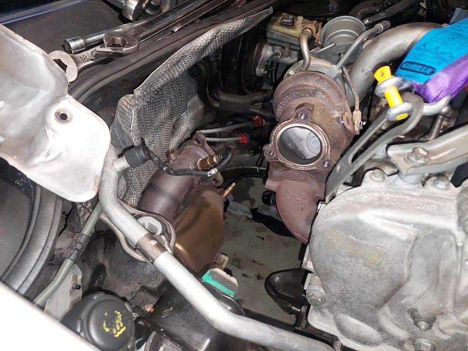

  12. More downpipe spam. Ground out the outlet flange to match the larger pipe, picked up some titanium exhaust wrap and wrapped it up. Pretty stoked at the outcome tbh! Chur

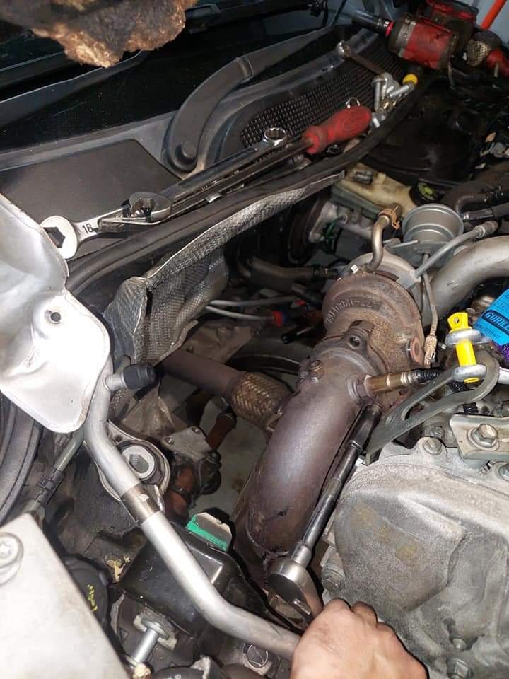

  15. Thought I'd have a go at making a decat turbo downpipe as the factory cat pipe is very restrictive on these. Luckily picked up some 2.5" bends from the only exhaust shop that I could find that was still open a couple days before xmas. Removed the old downpipe, a couple studs were siezed so had to cut and extract them. Welded a piece of flat bar to the flanges for the position. Cut off what I didn't need then cut and welded I'm some pipe. The welding is pretty atrocious but solid enough. Still need to weld in 2 more oxygen sensor bung and I'll probably heatwrap it but it should help it breathe a little. Hopefully have some more updates across the next week. Chur

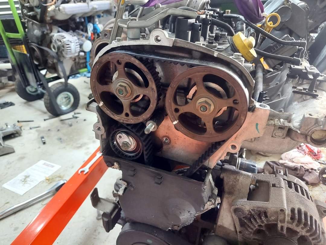

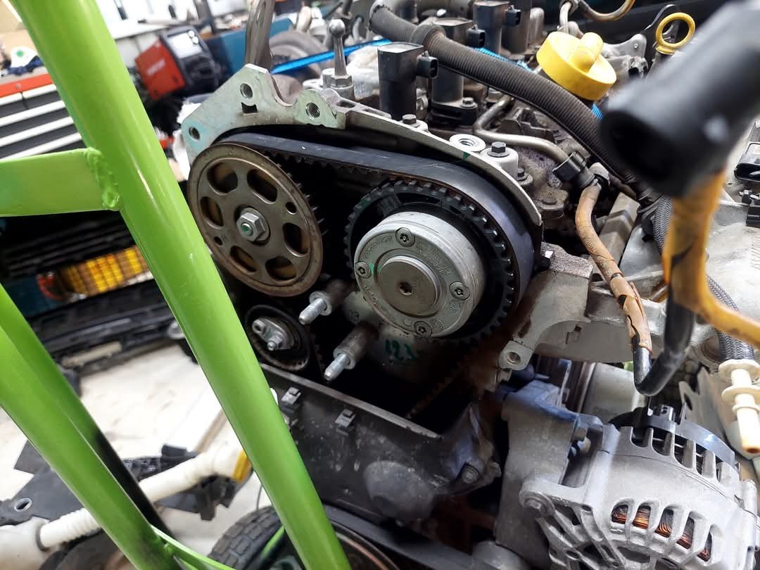

  17. Difference in intake manifolds. 265 225 Also was having a look at the exhaust downpipes. Both 225 and 265 are 2.5inch but slightly different in design. Both terminate to the exhaust in the same spot. As I'm wanting to decat the system as it's a huge restriction on these, if I can't get a second hand one cheap enough I might just by some pipe and bends and do it myself. The factory 225 exhaust is 2 1/4inch and the 265 looks to have an aftermarket 3inch exhaust (flexi is torn and brackets have broken off at the front). Might see if I can repurpose the 265 exhaust and bodge something together for the 225. 225 265 Might order the mounts this week and hopefully get a rear crank seal, gearbox input and output seals as well. Chur, Tai
  18. Not a real update but planning the next step and to organise new parts. Have been super busy with house reno's and family coming over for a holiday plus other family duties since last post. Had a quick moment today to check over a few things. Firstly, the engine mounts and timing cover swap. As there are a few differences a d changes required to get it to work. Rs225 Rs265 Covers and mounts side by side (265 on top). The 265 cam cover has an extra 2 smaller bolt provisions on the top for the top timimg cover. The top engine mount on the 225 also has an extra mount point which bolts onto the intake manifold. From what I've gathered, most in Europe who carry out the conversion drill and tap into the intake manifold to allow for the extra bolt. I'm thinking I might just swap over the 225 intake manifold/throttlebody/injector rail and injectors onto the 265 head. Reason being is that I'd need to swap the 225 tb over anyway (as this is known to have random cut out issues if running an rstuning box), also I can just run the factory fuel system and do away with the rising rate fuel setup. This gives me the oem provision for the top engine mount bolt hole and I can also run the factory engine cover if I choose. Also checking over the rear engine mounts. Upper 265 225 Lower 265225 I'll need to swap over the 225 rh cv shafts hanger and lower mount bracket (engine side) and run the 225 dog bone mounts. Both of mine are torn so I'll just order some new ones.

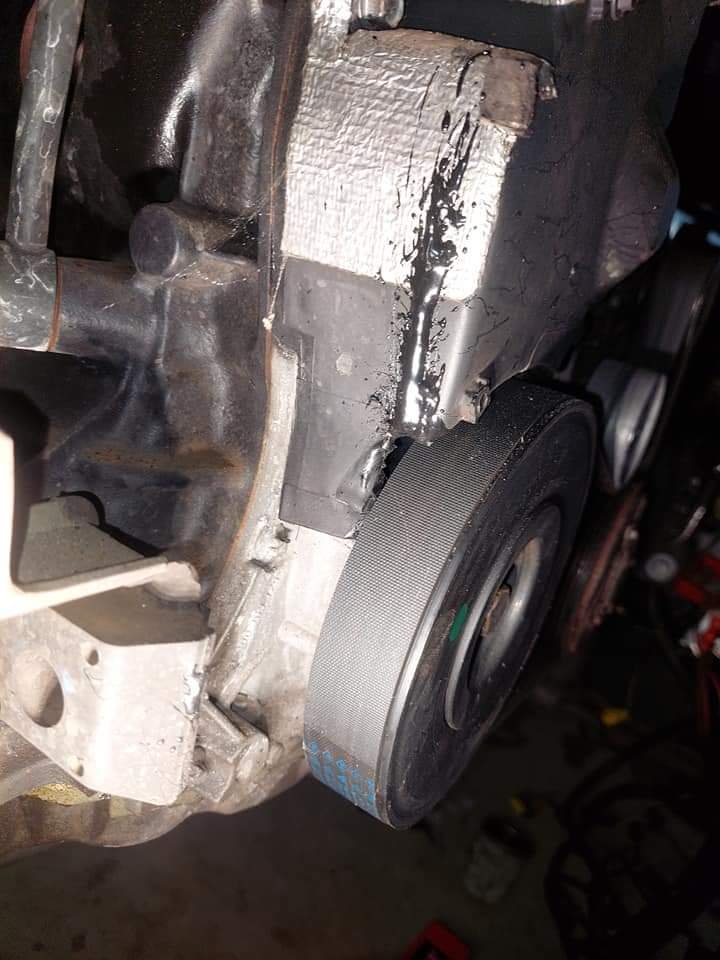

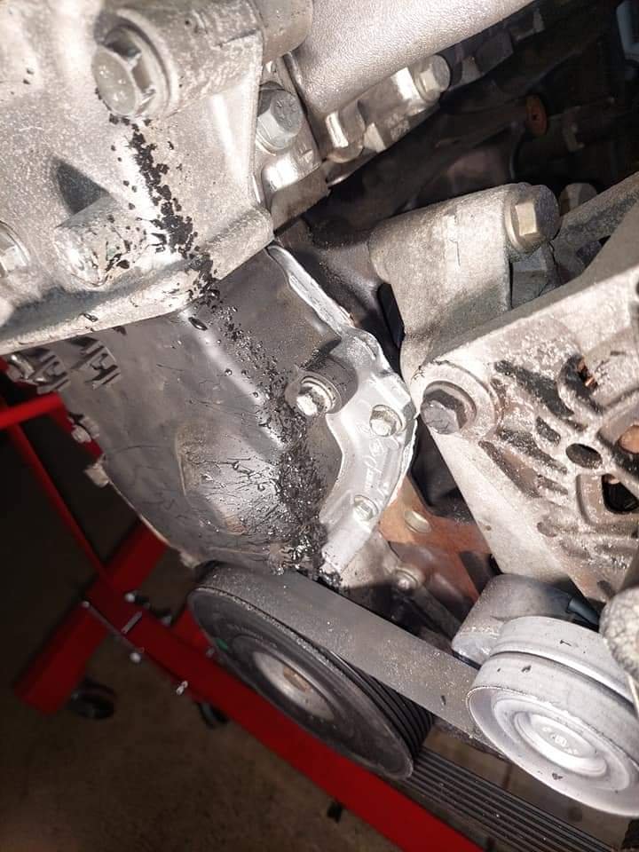

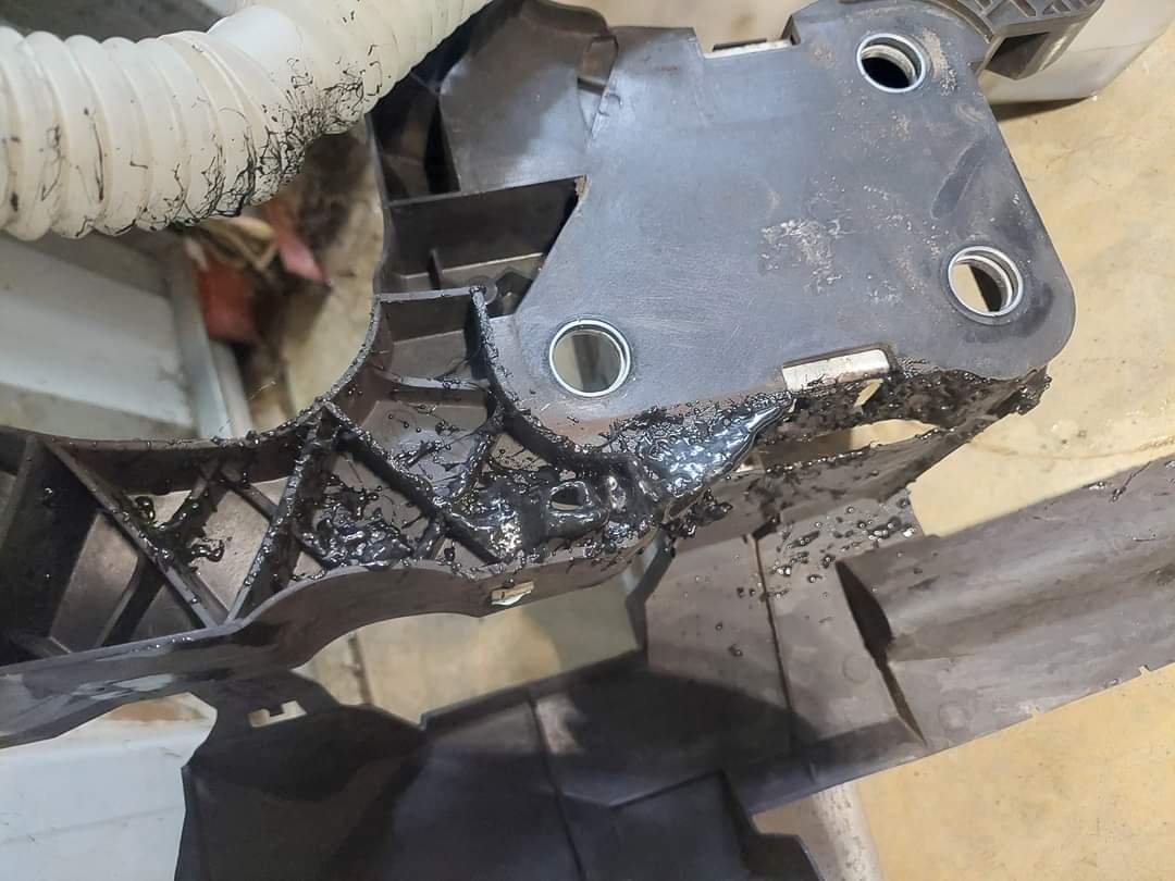

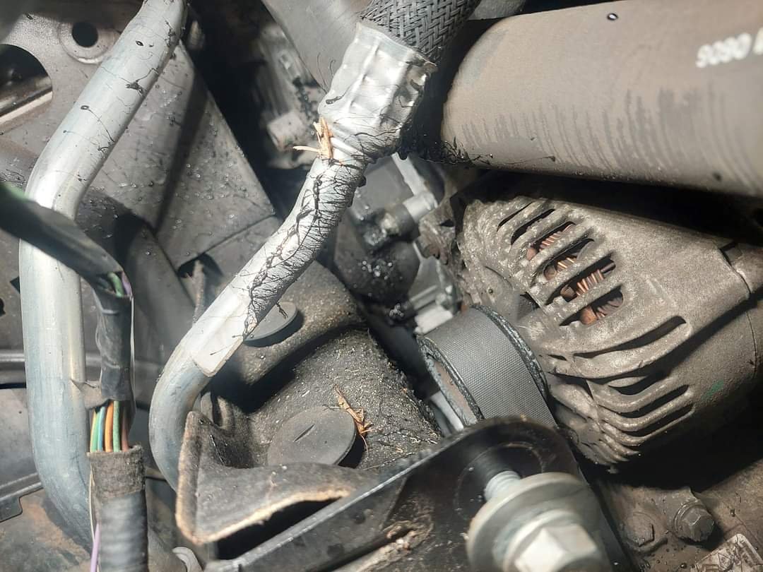

  22. Managed to sneak in an hour on this after the kids went to bed. Front end off, bit weird getting the bumper off but everything else so far has been nice and easy. Also noticed this black substance sprayed and melted all around the front of the engine area. Wonder where it's come from, will soon find out. I reckon another hour or 2 and I'll have the engine out. Will see if time allows tomorrow. Chur.

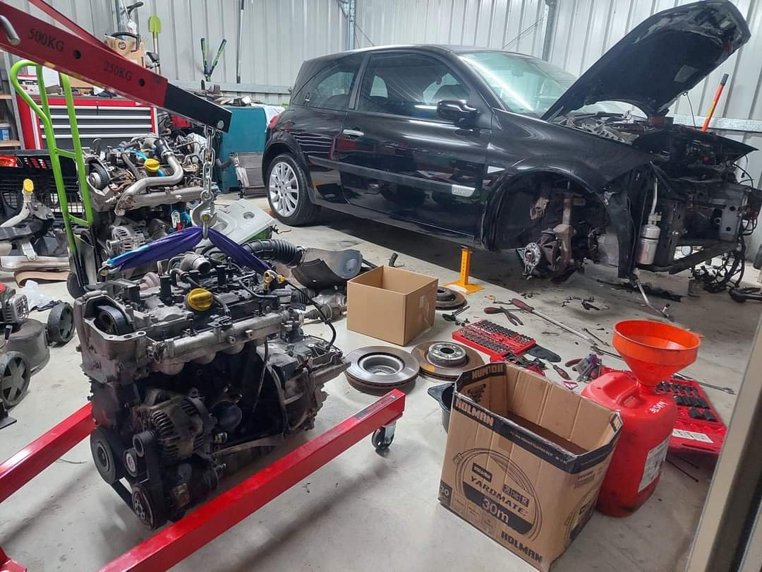

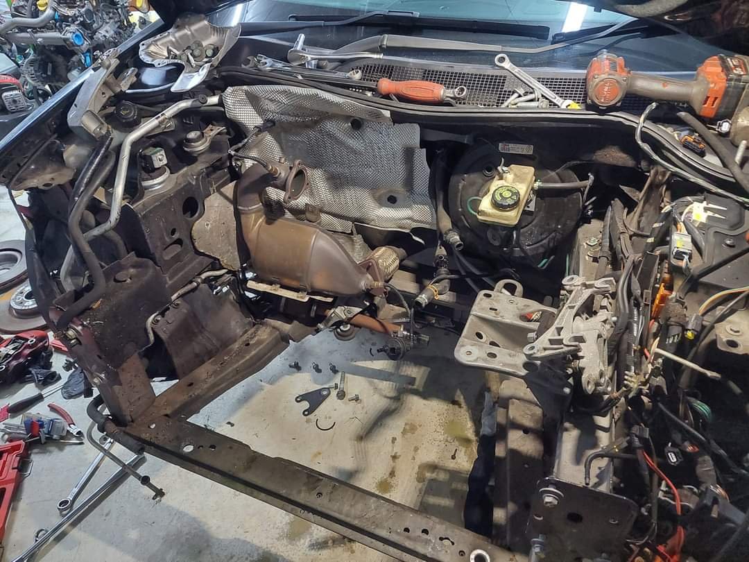

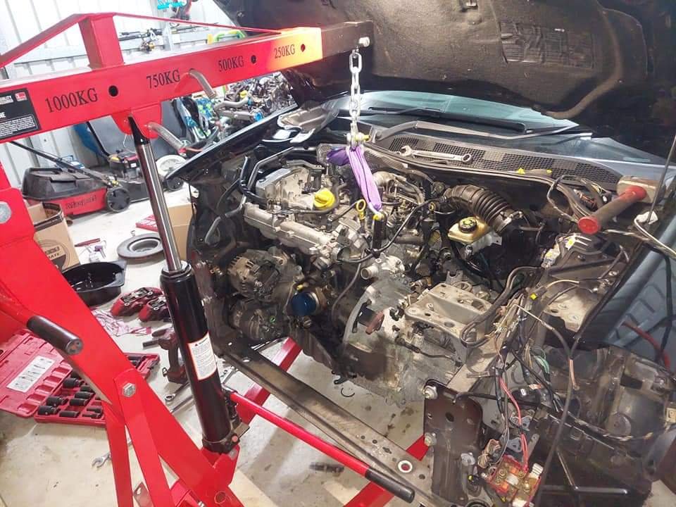

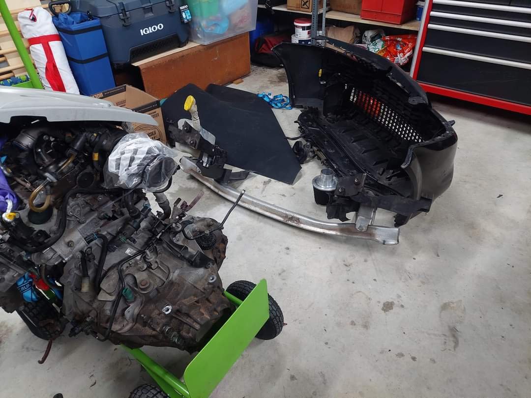

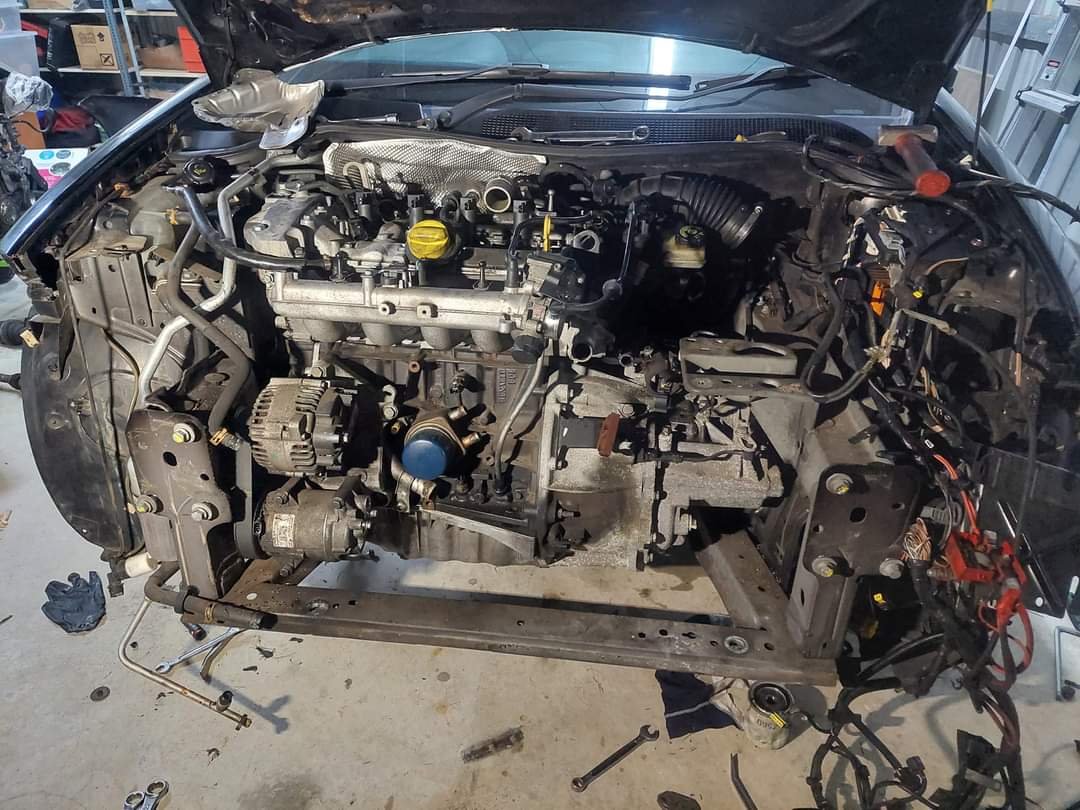

  23. Engine out. What a prick trying to remove the halfshafts. Ended up pretty much unbolting the whole knuckle & strut and everything connected as the lca was being a bitch. Of course half the exhaust fasteners were seized as well, couldn't unbolt it from the bottom side of the cat, so ended up managing to remove it from the top. Out it came though. I will need to grind off one of the cat lower flange studs though. Trolley worked a treat. Had to lift and shuffle it to turn it due to no castor's but it was easy enough. Length was perfect for both the box and engine as well. I might try and do some work during the evening this week but we'll see what happens. Chur.
  24. Managed to sneak in a couple hours today. Got the lacky to set her up... Then proceeded to start the strip down for engine and gearbox removal. A little bit more time and I'll have the donk out. Just need to disconnect the fuel lines, clutch line, exhaust and halfshafts. Hopefully time allows next weekend. Chur.
