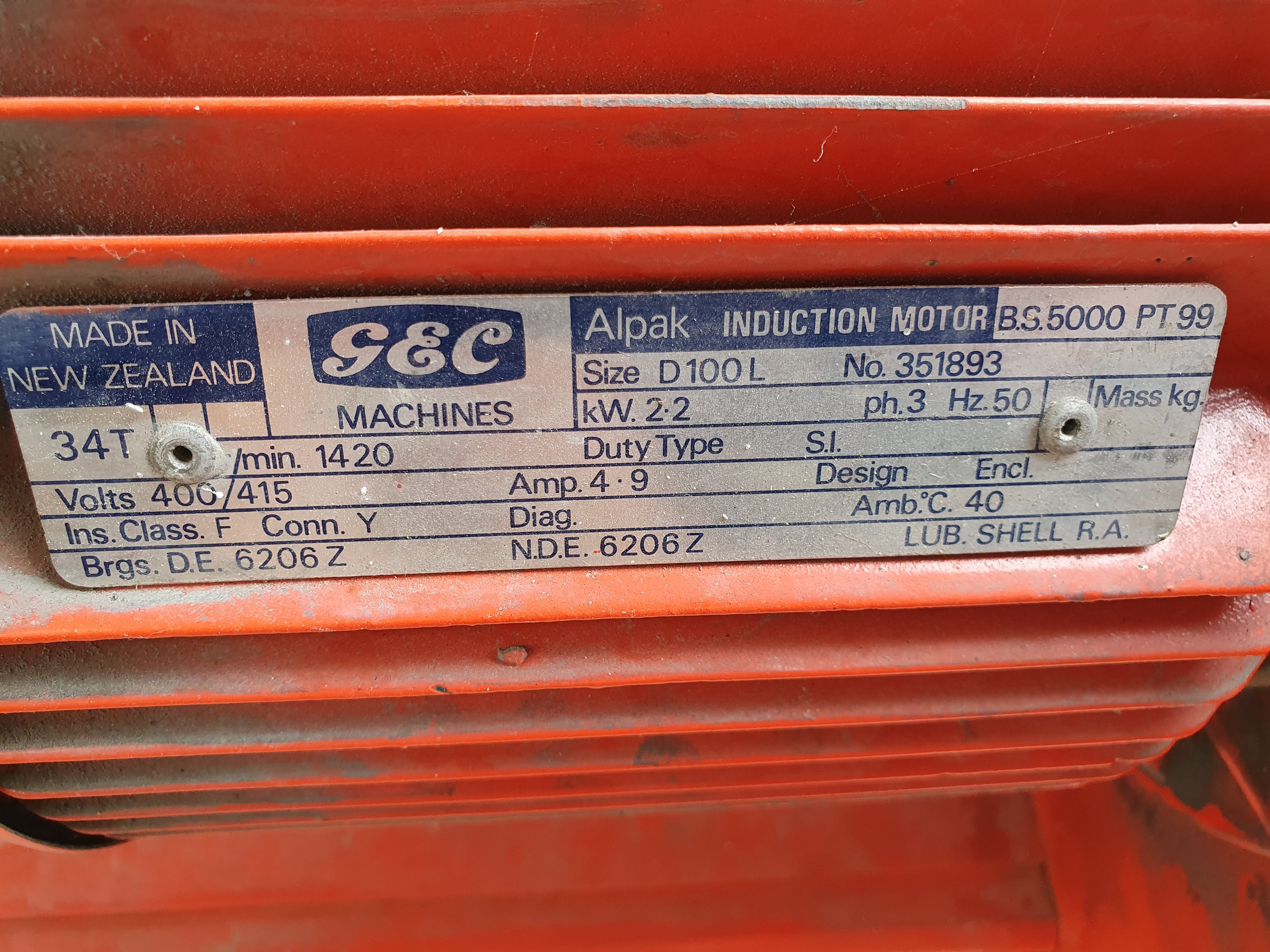

Kimjon Posted May 2, 2020 Posted May 2, 2020 This is a 3 phase motor, obviously...as that's what the tag says. My very basic knowledgeable of electric stuff is an equation I recall from school: P = V.I Now what's preventing me from losing this motor and substituting it for an equivalent 2.2kw power single phase alternative? If P = V.I 2.2kw = 240v x I I = 2.2x1000w ÷ 240v I = 9.17Amps Seams like not ridiculous amount of amps to draw? Is this possible? As simple as finding a 2.2kw single phase motor and adapting it to fit my application? Or is there a cheaper alternative to all the above? Ideas, thoughts, experiences please...???? Quote

fletch Posted May 2, 2020 Posted May 2, 2020 Can you take a photo of the wiring inside the terminal box of the motor? It says 400v star, (Y) so it should be able to do 230v delta with a Chinese vsd or 2nd hand trademe one. If you can get one cheap it will be the easiest way 1 Quote

rusty360 Posted May 2, 2020 Posted May 2, 2020 Not that it will prob worry you but I'd say the frame, shaft size will be different on a single phase motor vs 3 phase. 3 phase power would be good, so much 3 phase gear out there that's normally a heaps better price that single phase. 2 Quote
rusty360 Posted May 2, 2020 Posted May 2, 2020 I couple of motor details for ya. Looks like frame size is same and shaft size to. Single phase is 13amps full load. 1 Quote
UTERUS Posted May 2, 2020 Posted May 2, 2020 @rusty360 those numbers mean fuck all in the real world, it can easily be drawing double that current. 2 Quote
