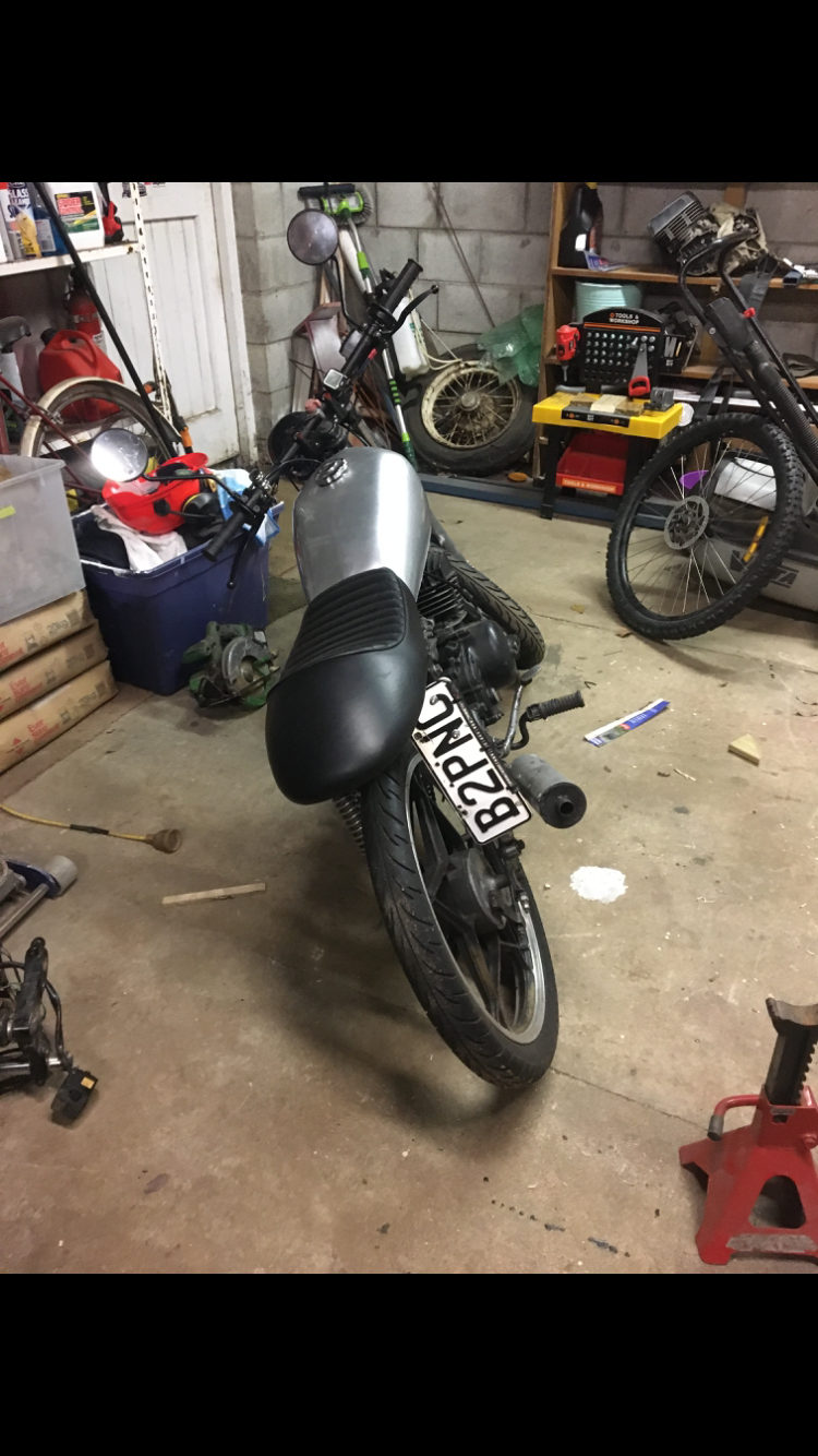

After a wee bit of pissing about I got this thing running the other day. I had the new ignition key wired in slightly wrong so instead of grounding the coil when it was turned off, it was switching the battery positive to ground when it was turned on. Long story short, I made some fizzing noises and a teeeensy bit of smoke, but its all working properly now.
That 6V headlight is an absolute glo-worm though!
For the front guard, I hunted about to see what I could find that might mount it. Turns out an RGV150 front guard is a bolt on replacement!
I had to tweak the mount a bit to fit my shortened junk guard, but it looks like it will work.
I thought I'd have a crack at fitting the RGV kick stand as well. I had to chop off the foot peg as it was gusseted to the stand mount, which was OK as it wasn't correctly aligned to the other side and really annoyed me when riding.
Precision with string-lines even.
Its not perfect, but miles better than it was. And now the bike stands up on its own!

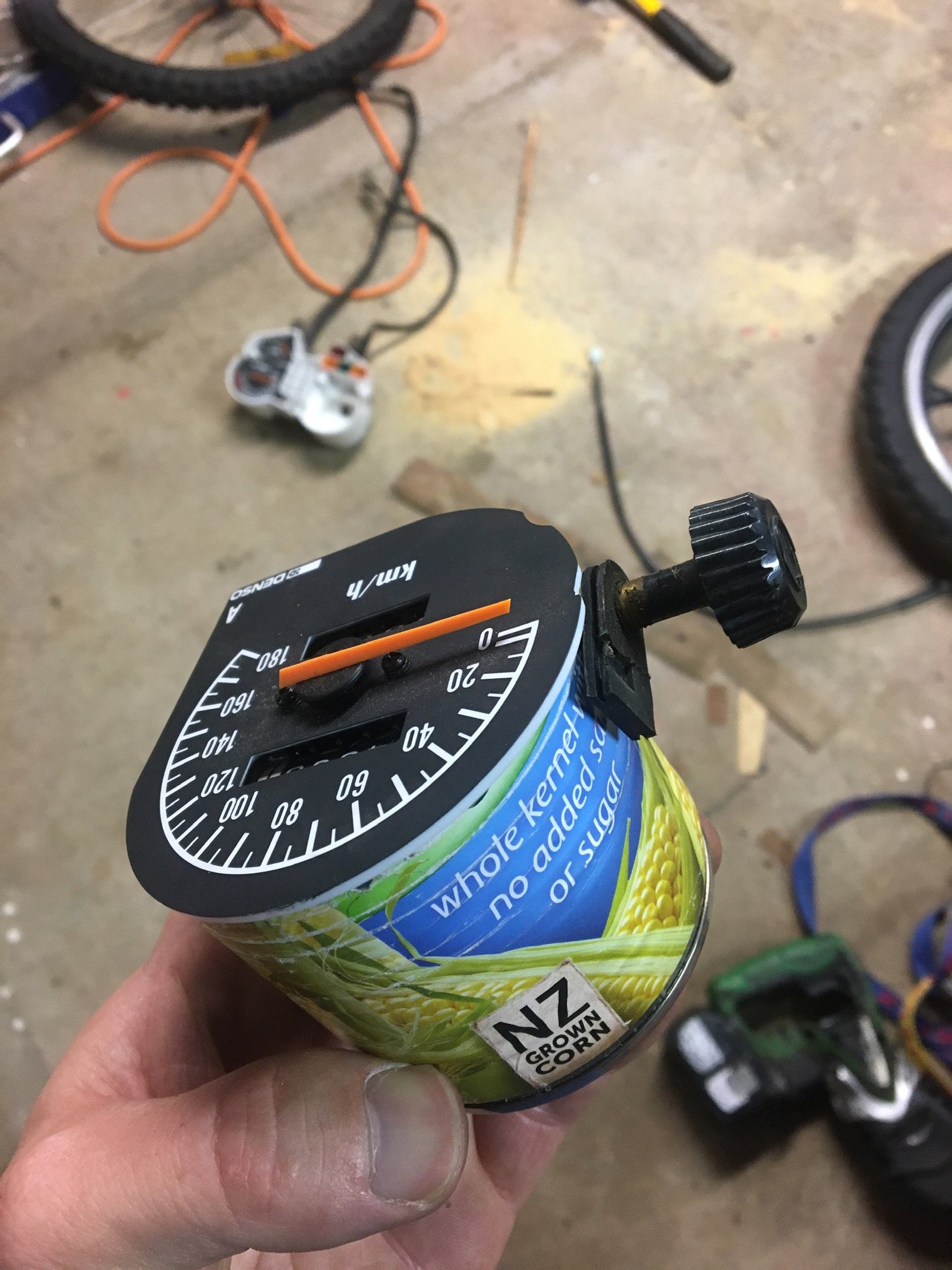

So it turns out that an RGV150 speedo and speedo drive is 2 washers and a corn kernel tin away from fitting a GT50. No salt for this 2stroker.
