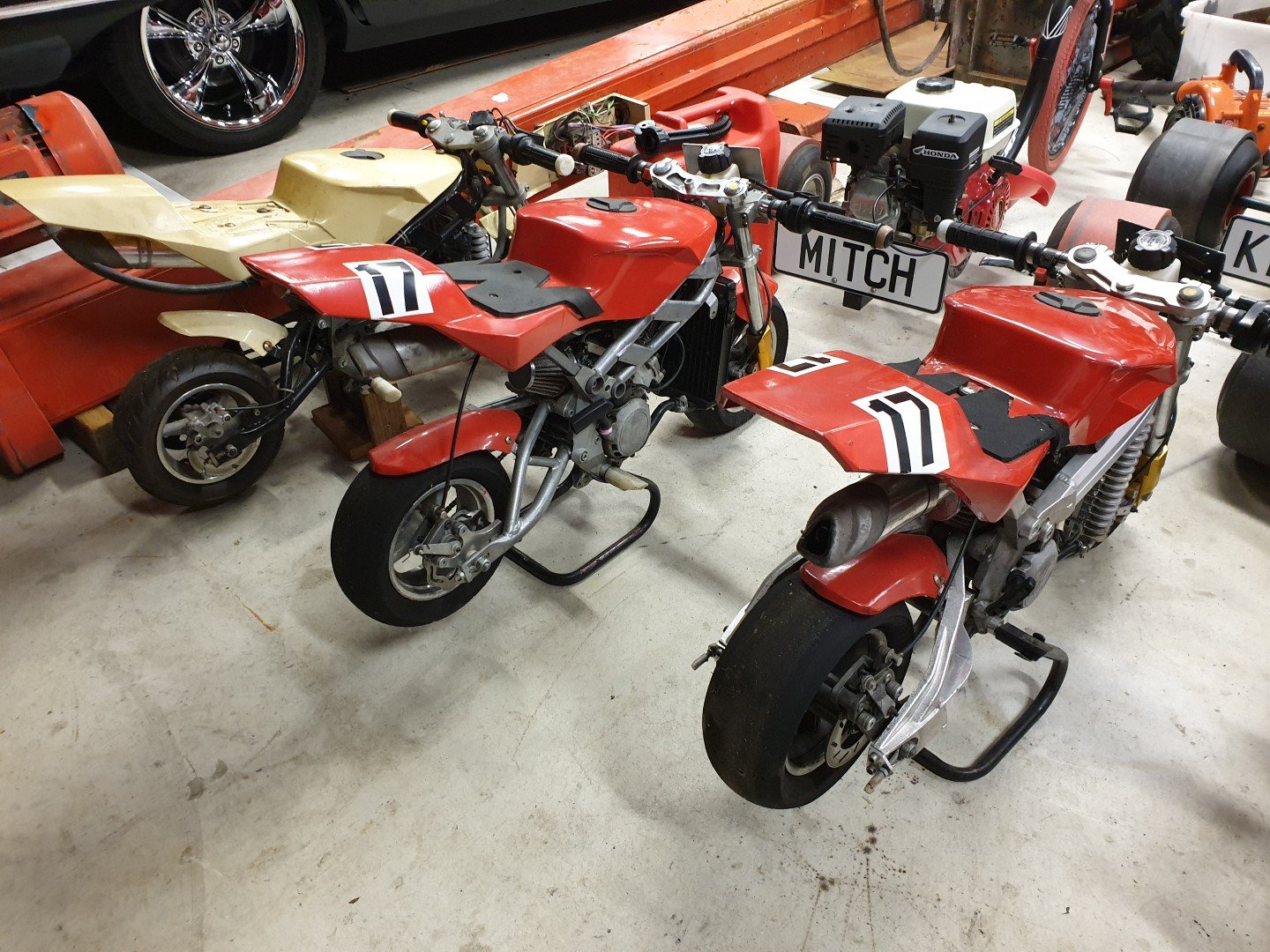

So, I picked this lot up... all water cooled 39cc ~8hp motors. Yes, approximately 8hp!
So many parts, enough to make a 4th working bike....and another spare engine for ummm, yeah...maybe, hmmmm???
  • Like 9

I was seriously considering doing this. What's cooler than 1 motor, obviously 2 motors! But it would be gokart fast and even I wouldn't want to ride something like this at 130kph!
These liquid cooled motors start at the bottom end around 8hp, and go upward of 15hp for the top of the line European motors. Very impressive for such small capacity. That's my attraction towards these motors - stupid power from such a small motor...

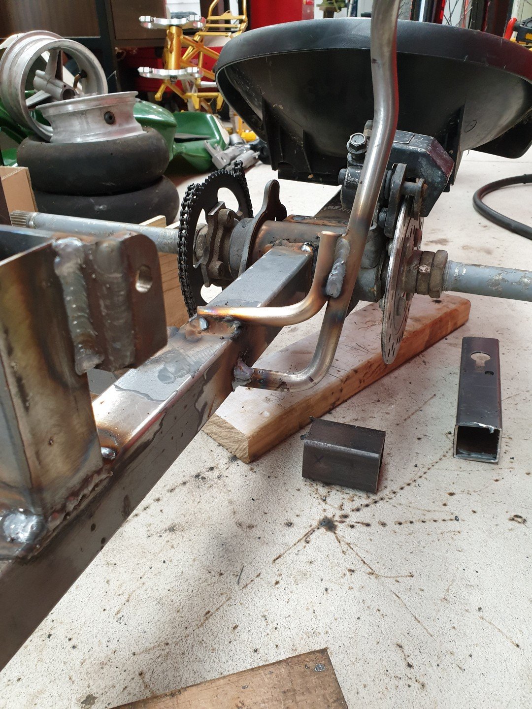

Put 4hrs work into this today, picture time:
Exhaust all sorted.
Hubs cut down, latched, re-drilled new pcd. So much work in these...its the hardest part of the build and the least fun to do.
Got stance? Stretched tyres onto much wider rims.
Sprocket: new pcd drilled, centre bored out, old sprocket cut down and used as a spacer.
20190807_102523_resized.jpg.d880f8203759583861d7ad2d1e74fee4.jpg20190807_104309_resized.jpg.7c92e0be4a0a7126ed86a6a55b380eeb.jpg
Engine mounts. Only solved half the problem so far. Need to fit other stuff before finding a solution for the next bit.
But happy with progress so far.
