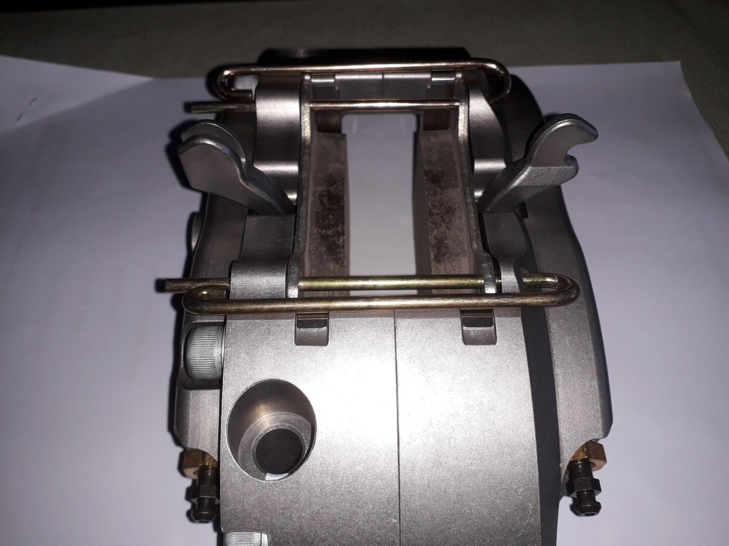

johnny.race Posted September 19, 2020 Author Posted September 19, 2020 On 11/08/2020 at 15:32, Mark_Fleming said: SR1600 - I really like those calipers with the integrated handbrake mechanism....any chance you can dissect one and show us the lever mechanisms? I take it there is some form of "paddle" between the piston and the pad to pull them together when in operation? I got some in. Here's how these ones actuate the handbrake mechanism ... 1st 2 pics of what they look like with pads fitted. These next 3 pics are taken with pads removed and the handbrake levers showing their movement. Basically each lever presses against the steel backing plate of each pad moving them against the rotor. Might talk to @Taistormsometime about how to go about the handbrake setting up if I can't figure something out myself. But yeah, this is how the Wilwood Powerlite handbrake setup essentially gets it done. 3 Quote
