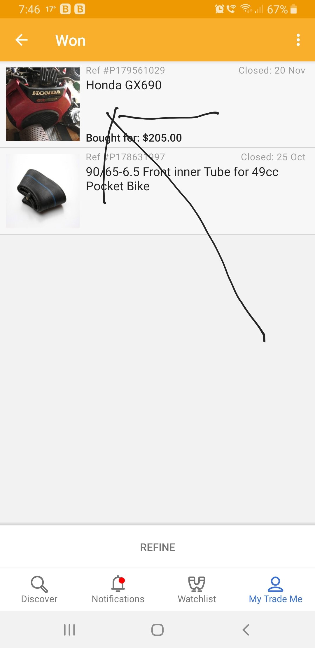

Muncie Posted November 20, 2019 Author Posted November 20, 2019 Hmm what shall i do now i have 2 twins...... 1 1 Quote
Kimjon Posted November 21, 2019 Posted November 21, 2019 Seen that for sale, be interesting how it goes for you? Quote
SOHC Posted November 21, 2019 Posted November 21, 2019 I want a twin for my stretch bike, I am amazed your rear wheel hub lasted at all Quote
Muncie Posted November 21, 2019 Author Posted November 21, 2019 That ring that slips over hub has done wonders holding it all together i did a massive burnout on it yesterday nothing is showing any signs of duress. 9 hours ago, SOHC said: I want a twin for my stretch bike, I am amazed your rear wheel hub lasted at all Saw one last night on a concrete saw sitting embedded in a traffic island just out of huntly must of jumped off a trailer. 2 Quote
