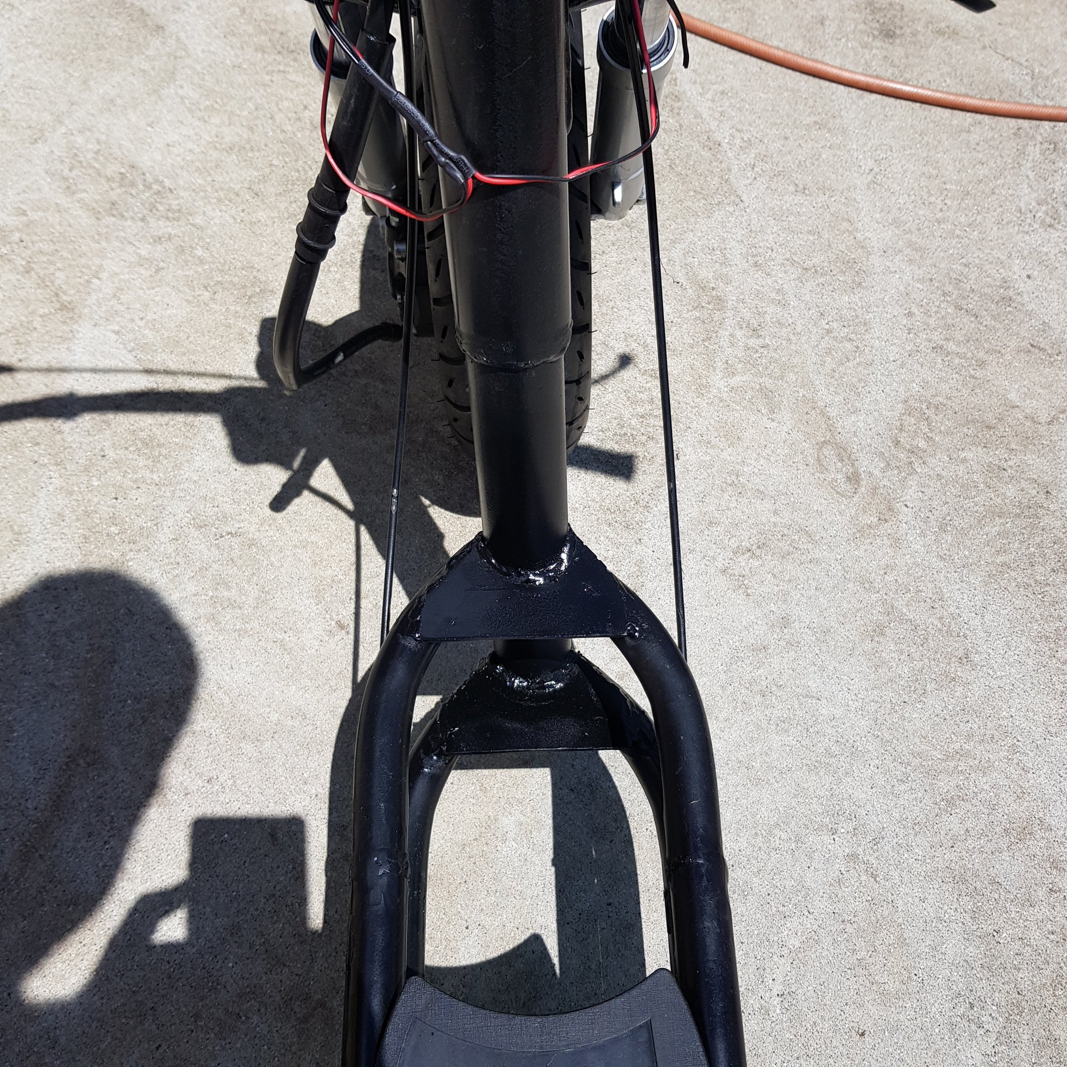

Muncie Posted January 11, 2019 Author Posted January 11, 2019 Welded some gussets in at base of forks and frame it pulls up hard now on the brakes so wanted to just make sure it doesn't crack up or let go. Only tube i could get to slip into the moped down tube was 4mm wall steam pipe so better safe than sorry with the difference in wall thickness i turned the amps up and stuck these in for good! Quote

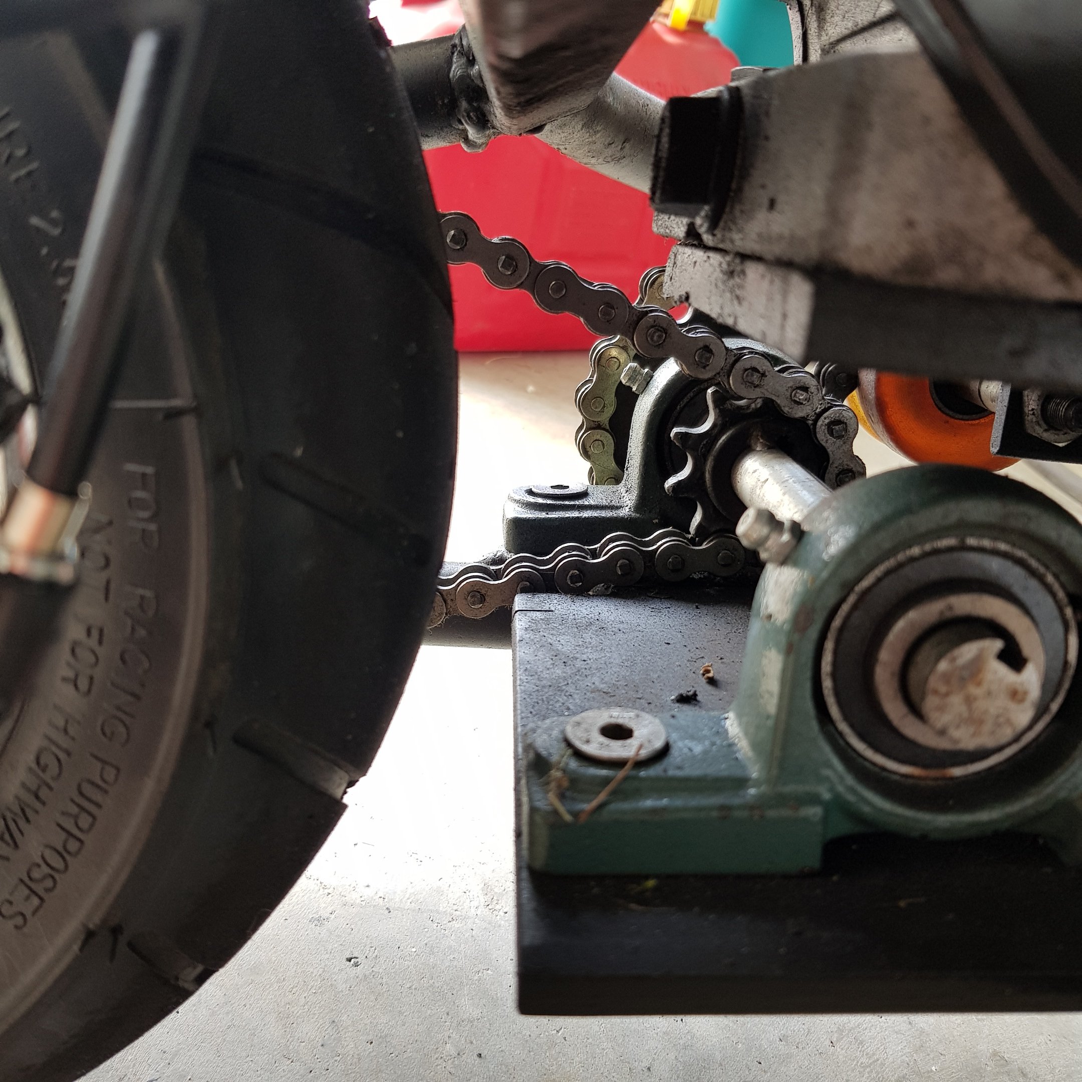

Muncie Posted January 26, 2019 Author Posted January 26, 2019 Found a clearance issue with chain so that got reemed out its noticeably quiter no more chain chatter. Quote
Muncie Posted January 28, 2019 Author Posted January 28, 2019 Checked the bolts on the engine and jack shaft today.... engine 3 out of 4 loose 1 missing eek replaced with high tensile ones. Jackshaft the same all loose but present at least, so replaced and stuck spring washers on the lot. Attempted burnout it coughed cleared and instantly filled the garage with thick smoke awesome! suspension helps the front bite instead of sliding alot. 3 Quote
