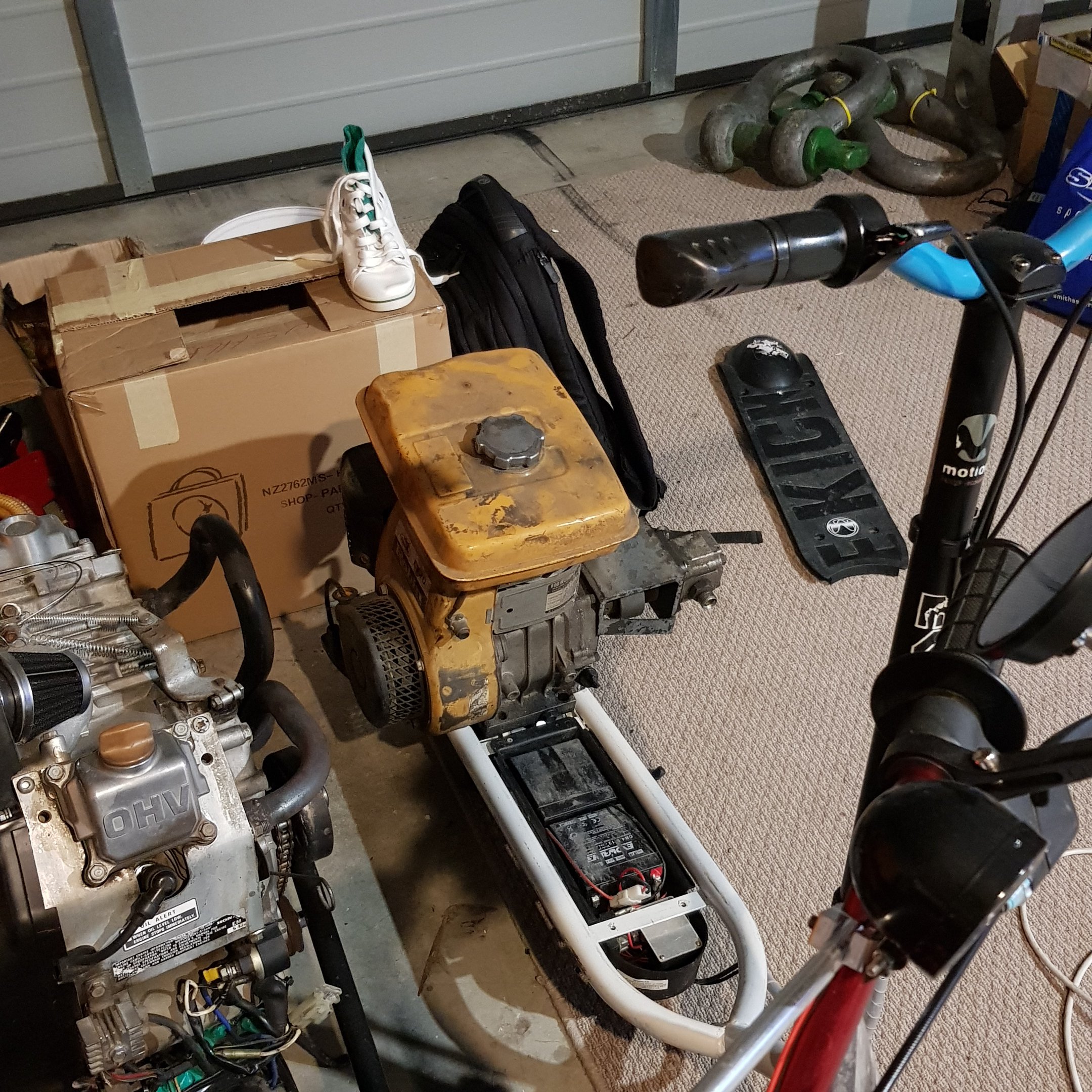

Muncie Posted August 19, 2018 Author Posted August 19, 2018 Slightly side tracked scored a Robin 5hp motor this week and another dead electric scooter a few months back so pretty sure ill bang the 2 together. Just need a wheel a sprocket and to reuse some old stuff from the first 2.5hp version to get the kids able to charge around with me. 1 Quote

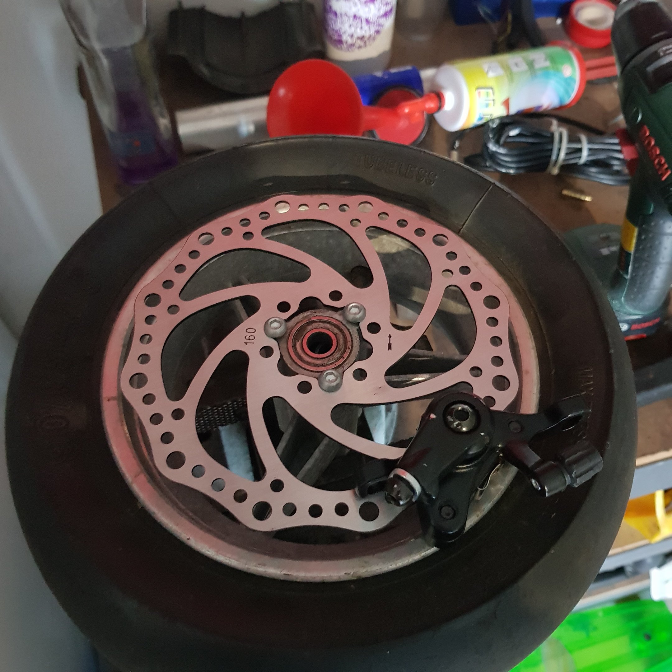

Muncie Posted October 31, 2018 Author Posted October 31, 2018 If the disc isn't a prick to fit i will invest in hydraulic just wanted to look them over and see they'll fit on the 6.5" rim without clashing on forks or tyre everything is tight! Quote
Muncie Posted November 22, 2018 Author Posted November 22, 2018 Hmm looking very very promising this is on a front rim which is very snug. So will adapt this to the back first which needs to get on with pulling its weight a bit better in the braking stakes, the rim is far wider out back so more room for the caliper ideally will run twin discs on the front. Plan is a big spacer to pick up the discs 6 holes and bolt through to the original 3 holes on the rim. Probably go 5-10mm thick so i can tap into it for the cap screws. Quote

Muncie Posted December 27, 2018 Author Posted December 27, 2018 Attempts at a brake upgrade this morning failed miserably due China spec machining and brake disc screws that all snapped off. Attempted many methods of extraction all failed they must of had some motherfucker of a locktite concoction on them. Ordered a new bare wheel with a treaded tyre fitted so was worth a try....... might slap this back on and blow the tyre off the rim for shits and giggles! 1 Quote

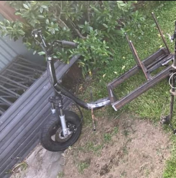

Muncie Posted December 27, 2018 Author Posted December 27, 2018 In other news i bought some more bits as i want to make this thing a bit more plush to ride will be lopping off my homemade front end and attaching a full stepthru scooter front end. Its going to get longer yet again but brakes suspension and room to stand without a cylinder head against ya leg will be worth it. Quote
