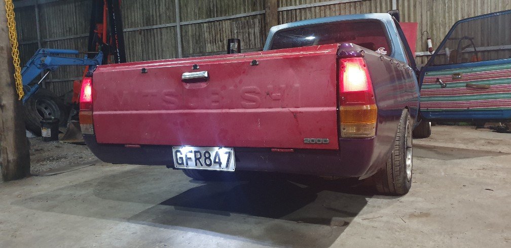

tortron Posted March 19, 2020 Posted March 19, 2020 Put this all back together and drove it outside  then turned it around and put it back in the shed and cut the other side apart  Owning a mitsubishi is so good. recommend it to everyone 2 Quote
lush Posted March 20, 2020 Posted March 20, 2020 20 hours ago, tortron said: Put this all back together and drove it outside  then turned it around and put it back in the shed and cut the other side apart  Owning a mitsubishi is so good. recommend it to everyone Them feels 1 Quote

Rotaryhoe Posted April 26, 2020 Posted April 26, 2020 20 hours ago, tortron said: Dug up this on the rear of my tray Truck was an 83 so it must be #243 and made on the 55th day of 1983  MILDLY INTERESTING! Not sure about the 55th of May lol. But here is a bit of useless trivia. These were pressed in Palmerston North at a company called Coachwork International. They were the only company in NZ to have a press big enough (400ton) to emboss the lettering on the tailgate. They stamped all the major brands wellsides back in the day due to local content rules. Mildly interesting... or not 4 Quote
tortron Posted April 26, 2020 Posted April 26, 2020 55th day of the year..... It's how many manufacturers date their stuff  But yes that is mildly interesting Apparently NZ trays are different in a few ways than other countries. All in ways that involve less work being done. An Aussie guy keeps saying it's not OEM and I keep saying yes it is NZ made their own for the above content reasons  NZ trays have a folded rather than pressed/beaded cab end panel (others have one that's like the floor of the tray) The panels Infront of and behind the wheel wells are flat, others are pressed like the centre floor Inner tie down rods are welded in, others are bolt on We have flat/folded wheel tubs, USA has rounded ones Our fuel flaps are below the swage line, so are flat and easy make. Aussie and USA has theirs on the swage, so another panel to press.  All the stuff is the same dimensions tho 2 Quote
lush Posted April 29, 2020 Posted April 29, 2020 My rear panel is one fold, numberplate mounted with rivnuts. I like it but it's obviously been redone at some point. I also have a shaved tailgate and checker plate floor on my tray. Swapped the shaved tailgate out for an original one because I like to rep mitsi haha 2 Quote
