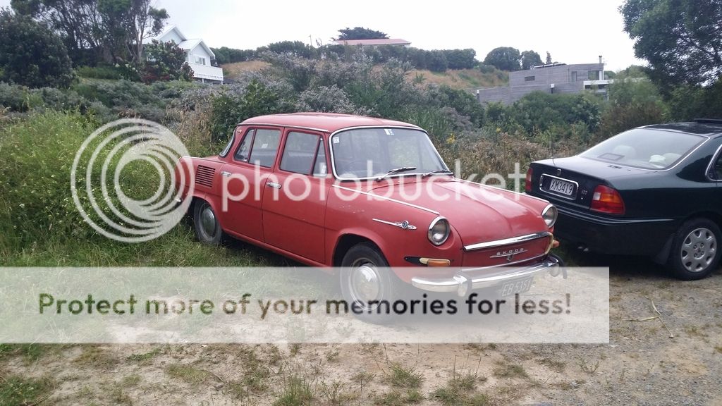

dozydesmond Posted October 6, 2015 Posted October 6, 2015 So, discussion thread for my Skoda S100 any comments, criticisms (constructive only please), ideas, help, or info regarding the project go here, all welcome Quote
azzurro Posted October 6, 2015 Posted October 6, 2015 yay. for some reason these are the car i remember most from my childhood - we never had one, but there must have been a garage nearby (Blockhouse Bay) that serviced them or something, but i remember them because they were so different from everything else. Then they just disappeared probably around when Japanese imports became a thing. me and my sisters called them pushmepullyou cars and would push each other whenever we saw one driving around (we did that most of the time, but it was a good excuse!) I think these were in NZ for much the same reason as Lada's - some sort of barter deal with the Czech government - butter or whatever for cars? I think they are mean. More pics please. Quote
azzurro Posted October 6, 2015 Posted October 6, 2015 haha, that's perfect as is. only the most hateful capitalist would steal the air from the glorious workers atmosphere to inflate their tyres. Quote

jakesae101 Posted October 7, 2015 Posted October 7, 2015 love the old skodas a mate has a 120L with a hotted up alfa engine in it i link him to most skoda things that pop up here he said to tell you to take the front guards off and have a look, they go bad at the front of the door post and lateral chassis rails 1 Quote
h4nd Posted October 7, 2015 Posted October 7, 2015 My Gran had one of these. When my step dad went fishing with my uncle, he was quite surprised to see a fish go by the window during a river crossing to get to the spot... That patina is awesome. I hear there's rally kits for these? Quote
R100 Posted October 7, 2015 Posted October 7, 2015 My dad had one of these but it was a 110r coupe in yellow. Looking back i wish we kept it as i never saw another one again we sold it. Quote
NickJ Posted October 7, 2015 Posted October 7, 2015 I saw that on Facebook not too long ago and had massive wants, look forward to seeing more pics! Quote
Alfashark Posted October 7, 2015 Posted October 7, 2015 Sweet! As per comments above, pull the guards as they can go hideously bad aft of the front wheels. If you're interested in easing up the appetite that these have for head-gaskets with the 1000/1100/1200 engine, and wouldn't mind having a spare 20 odd horsepower in your back pocket, keep your eyes peeled for a Skoda Favorit - Boxy FWD hatch that appeared around '91. They use an all-alloy 1300 that first made an appearance in the 120L (The rear-engined model after yours) and quite literally bolt straight in, using their existing carb/flywheel/clutch. Quote
dozydesmond Posted October 7, 2015 Author Posted October 7, 2015 Thanks for the advice on the rust spots guys, ill have a look when i get a chance as for the engine, i might know someone who can do stronger gaskets, as i really really want ti keep it as factory as possible And as for having seen it on facebook, thats where i found it, and i fell in love with it (LOL last time i fell in love at first sight i ended really really badly so lets hope that this time is alot better. it should be, its a car and not a chick this time :D )and as i have stated, i havn't made the swap yet as i have no tow car till next weekend. i can get a trailer no problem tho (Im in rangiora, its in cromwell...) Quote
