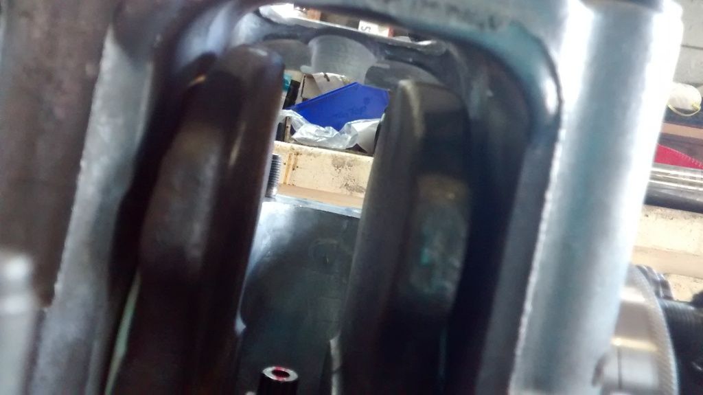

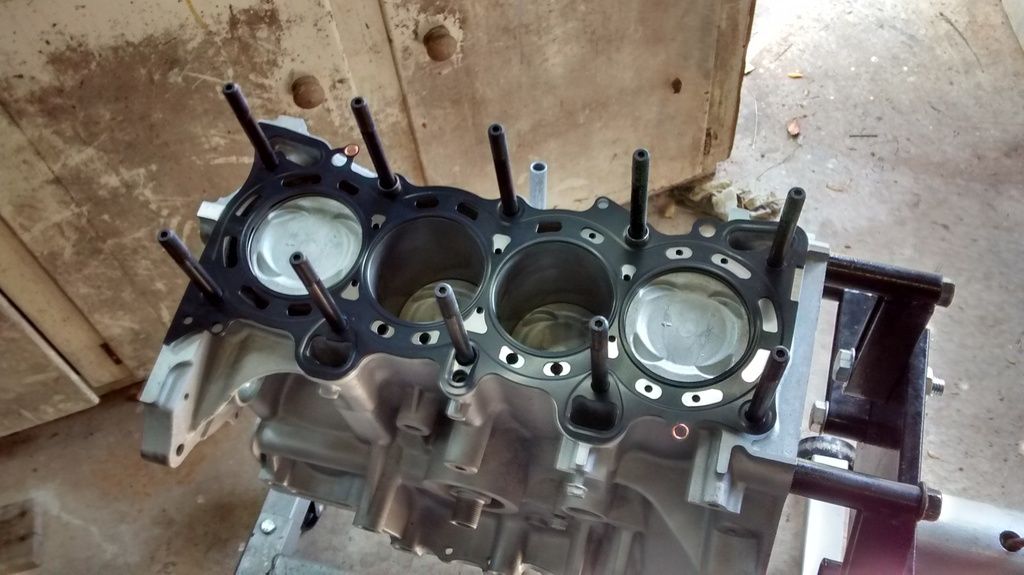

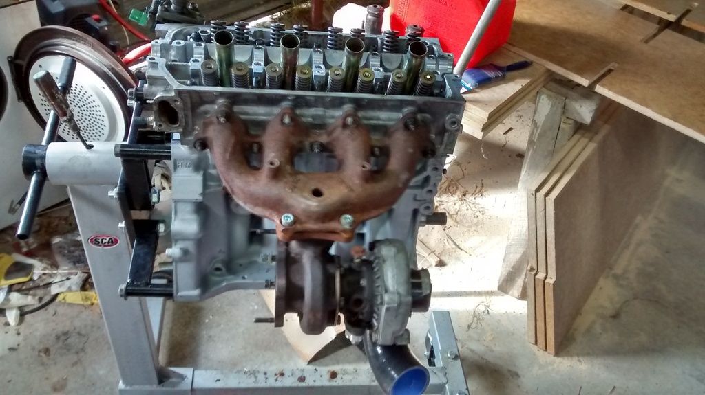

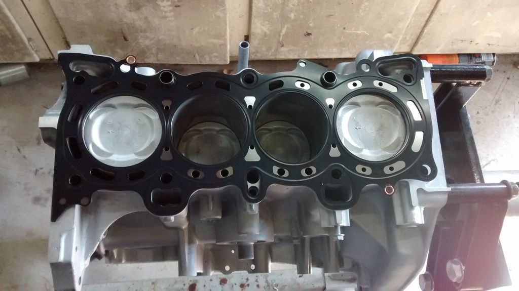

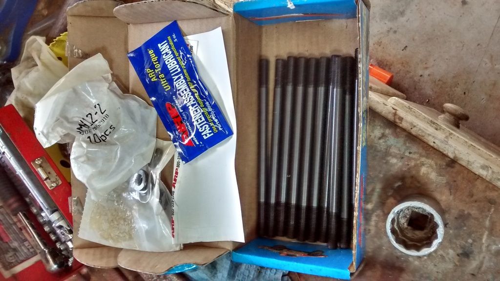

I have started assembling the engine. I've done the crank and spark plug seals, fitted the head studs ,gasket and head. I've started fitting the water pump pipe and thermostat housing. Put the vtec solenoid on. I'll get some assembly lube next week and put the valve train in. The crank girdle needed a bit of grinding so the rod ends will not hit it. I shouldn't be bending/damaging those rods any time soon. I've dummy fitted the churbo (still need to sort out gaskets for it). TOmorrow I'll clean the oil lines and figure out that plumbing. I'll dig up a service manual and check out the oil pump clearances and give it a port. I have two oil pumps so I'll practice on one first.

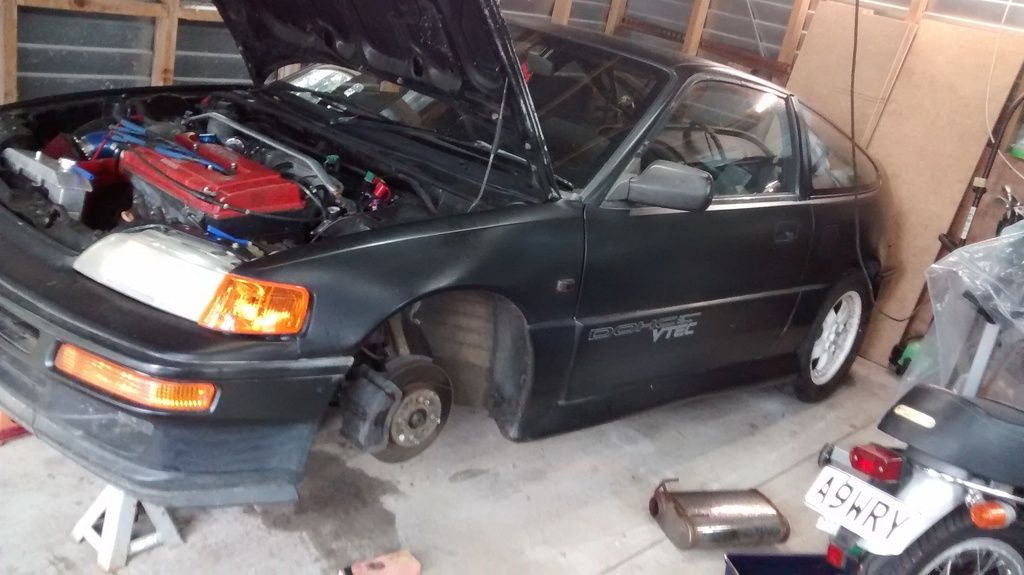

It needs a bit of work to be legal but its mostly straight and rust free. It has a b18c out of a integra type R. goes like a cut cat mayte. First thing to go was the bonnet, Alternator wasn't charging so I got someone to whip it out and tested it. I've replaced the regulator as everything else checked out ok. The wiring isnt the tidiest but thats easy enough to sort out. I have pulled out the leaky d2 adjusties and stuck stock stuff in for now. The wheels are on tardme as they are too big and i've put some on from my hoard. I have a stock radiator to replace the alloy one. Also have a muffler to replace the bigbore.

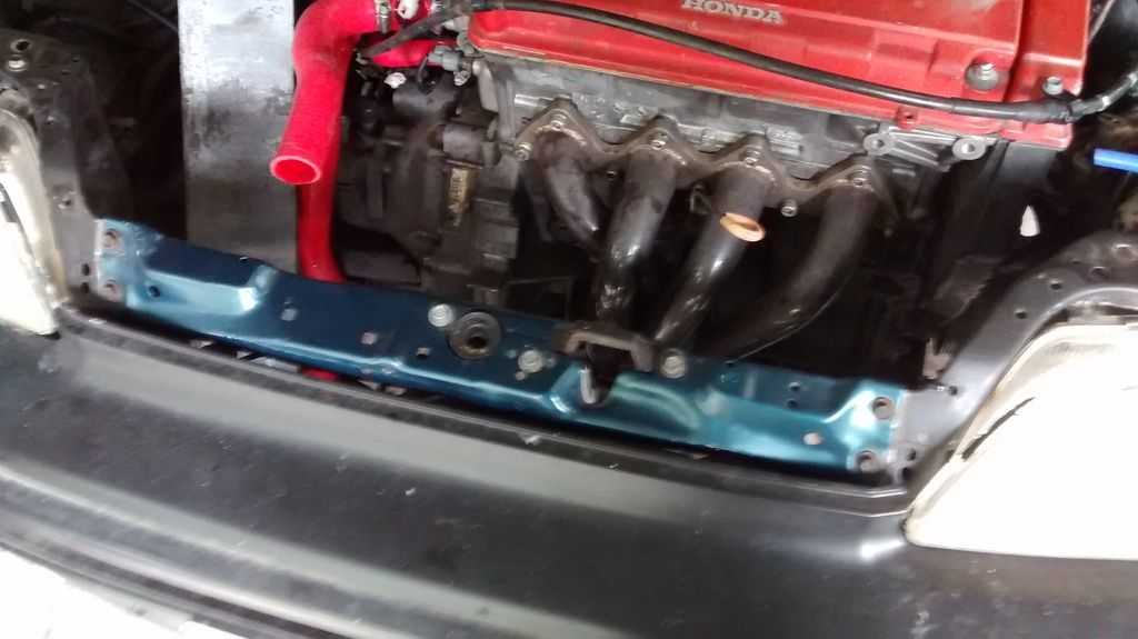

Today I put the stock front struts in and a replacement bonnet catch panel. Surprisingly the one off my parts shuttle fitted (after a few pieces of encouragement from the hammer)

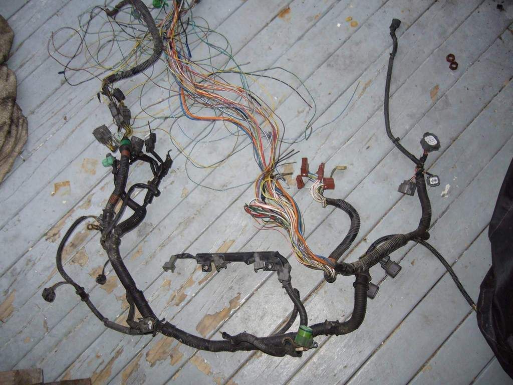

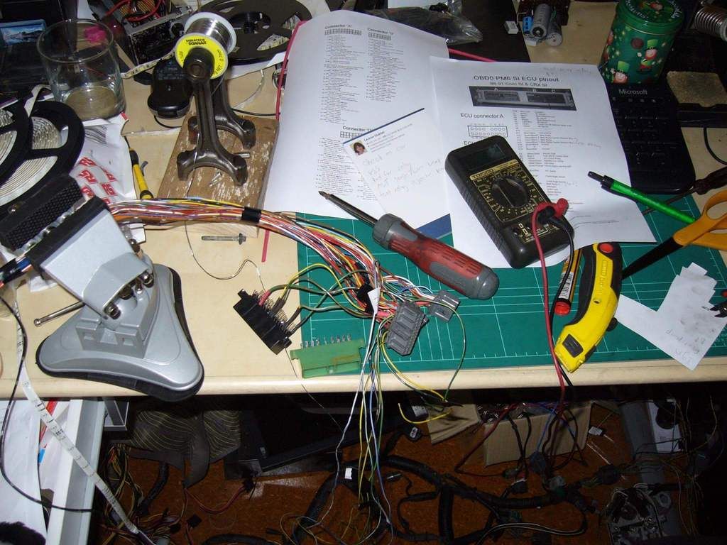

The engine loom is a mess of chopped up factory crx and integra. So so fix it I've got a sohc vtec loom from a eg civic. The reason I'm using that loom is its cheap from zebra and it has the correct Ecu plugs for a chippable tunable factory Ecu.
received_884340628367797_zps4hglauze.jpe

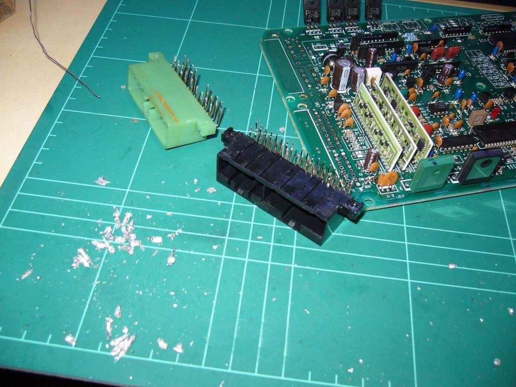

First I de soldered the Ecu plugs from the beagle. Identified the feeds etc and soldered them on. I could chop the plugs up and solder directly onto the existing loom but I prefer to be able to remove it.
The wires at the other side of the loom have been identified and labeled. Next step is to test what's left of the loom on the crx and find the required stuff.

Loom is getting closer to being finished, I'll sort out all my photos soon. I've found a spare dizzy too which is on its way tomorrow. Hopefully that'll need minimal work to sort. I've got some (slightly) bigger injectors and the tuner has the ecu. I was testing the wiring before pluugging anything in and realised I had looked at the wrong side of the ecu plug. I got a bit pissed and chopped it off and hardwired it all in. Ive started to tape everything up and 3 rolls of tape later i'm not done.

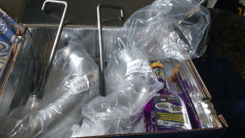

I've ordered some bends so I can ditch the bigbore, Yes they are cheap sta ones but chase/autobend wanted significantly more for theirs. Probably quoted retail but nevermind. I'm planning on redoing the exhaust at some point in the future. All going well my ignition parts should turn up from rock auto this week. and I can then either fix the spare dizzy or this one.

My cheap China bends turned up. Yes they may be bad but I'm going to end up butchering them with a arc anyway. This whole lot delivered was less than one bend from auto bend. IMG_20161207_105322231_zpssncebkaz.jpg
