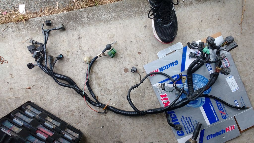

chris r Posted December 6, 2016 Author Posted December 6, 2016 Cleaned up the passengers loom and it's now retained and won't get eaten by the alternator pulley. Engine loom is ready to go in. The body loom that plugs into the engine is a tad long but I'm not going to shorten it and make another potential fault point Quote

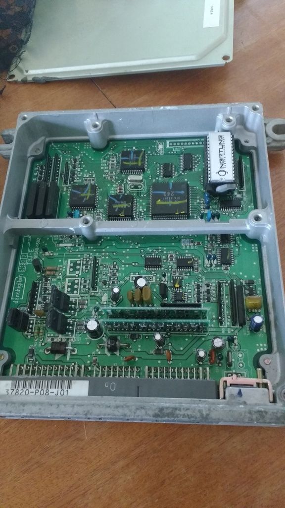

chris r Posted December 7, 2016 Author Posted December 7, 2016 Ecu was dropped off this morning . What a gc. It's even named. It has a standard type r integra tune until I get it to the dyno and we can tune it better. It'll be interesting to see how many killer wasps it has. I'll be disappointed if it has less them my c10. I updated the list with things left to do. Somehow it got longer? Quote

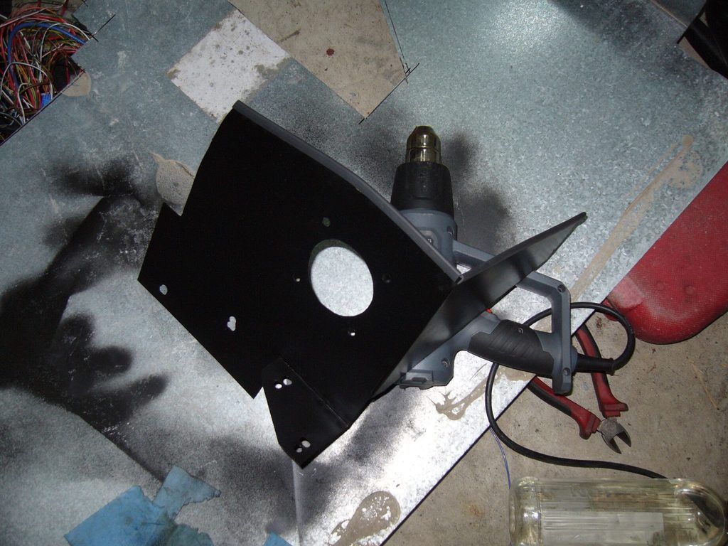

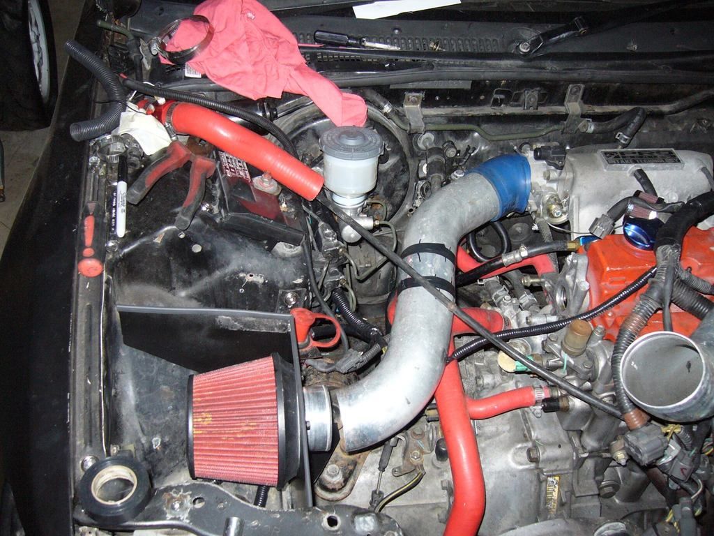

chris r Posted December 12, 2016 Author Posted December 12, 2016 Made a air box for this today, Just need to get intake welded up and make a bracket for the top so it doesn't vibrate. Will get some silicon joiners tomorrow. Did way too much and am in lots of pain/nausea too. Failed miserably at doing the exhaust too. no pics of that Quote

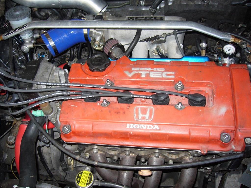

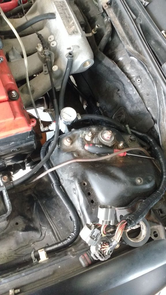

chris r Posted December 14, 2016 Author Posted December 14, 2016 No pictures today but engine loom is mostly in just need to plug a few things in. Cooling system has a new replacement hoses and the heater is correctly plumbed so might actually do something. If my dizzy/parts turn up I'll be able to see if my wiring works Quote
chris r Posted December 17, 2016 Author Posted December 17, 2016 Still no parts. But smashed lots of stuff off the list today. No pics as I was grubby as. Fuel tank is secure, konis are swapped from shuttle to the crx. Shirt shifter and new bushes are in. The engine loom has clips holding it in place the gauges are wired up properly and work. It now cranks off the key and alternator light seems to be behaving. Ive done another earth for the motor so vtec will pop harder and it'll make a million powers. (really the factory earth was shit and I've fixed it on this car before) I still need to sort the rear muffler out and find/make a bracket for one brake line and lots of electrical stuff Quote

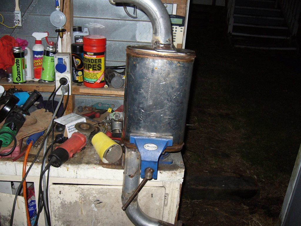

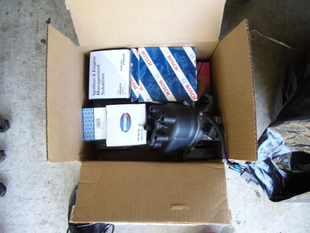

chris r Posted December 21, 2016 Author Posted December 21, 2016 My bits turned up from rock auto and so did the s/h dizzy. I chucked a new coil and rotor in the dizzy along with a s/h ignitor. The cap I ordered was too small so I'll have to go genuine on that but its not too bad. threw the ht leads on and it started second try. Didn't work the first as I forgot to plug some stuff in. warmed it up and no fault codes and the rad fans cycle nicely so I'll call that a win. I've tacked up the muffler/exhaust and given it to a friend who can actually weld so finish it off. Hopefully I actually got it right. I still need to sort out the vss plug and the 02 sensor wire and I can say the engine bay wiring is good enough. still have to sort out the interior Quote
