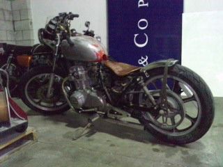

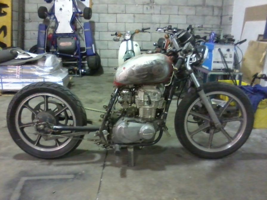

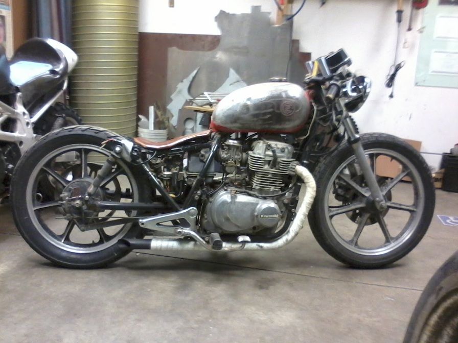

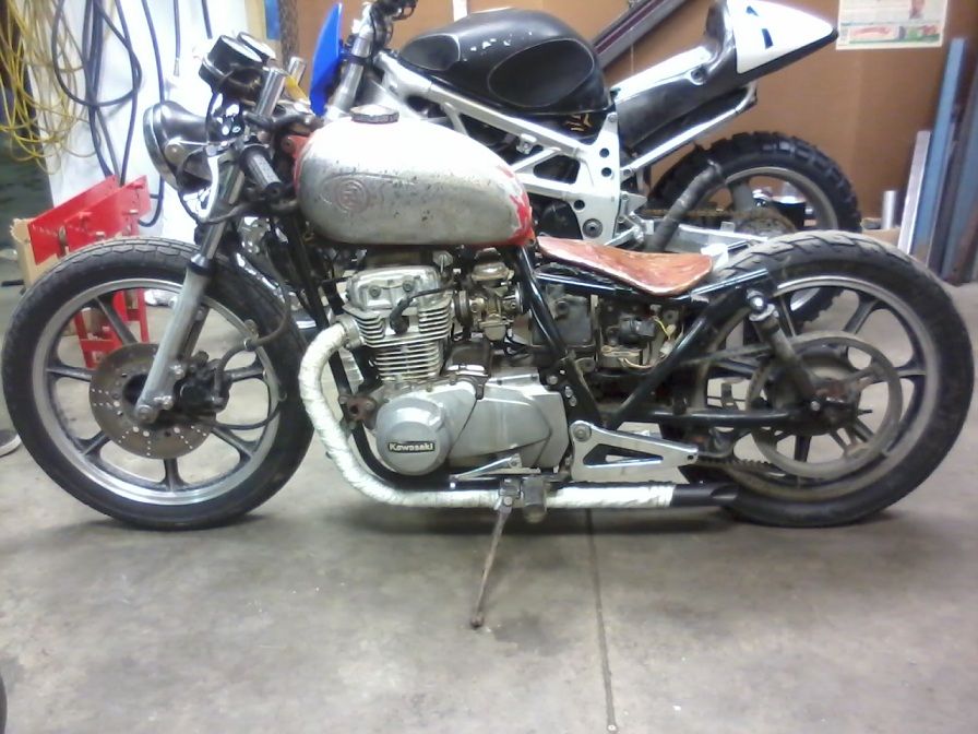

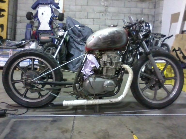

oldnrusty Posted September 3, 2012 Posted September 3, 2012 So ive had this for awhile now, Finally started to do some real work on it, got it off a mate who didnt have any welding skill, so was asking mates for help, never really got it how he wanted it so ive taken it off his hands its a 1980s KZ440, Rego and wof'd, he got it all re vined, changed the bars, new pipes, tank made a seat and did a half arse rear hard tail section then i got my hands on it, brought a new seat (not in photos), and clip on bars to get it lower at the front end now the fun really starts, Finally got some steel yesterday and then cut the rear section, leaving the swing arms to keep everything straight, note; swing arm will be gone once i weld the top section of the rear hard tail in sorry for shitness of the phone photos, lost my SLR battery charger, once i locate that ill take some better pics thats it for the moe cheers Quote

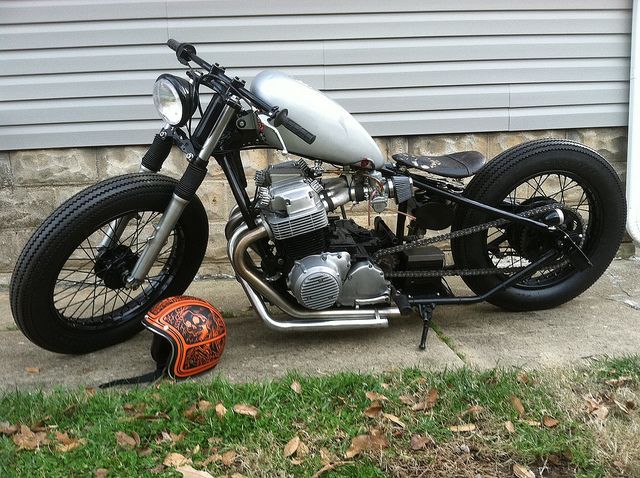

oldnrusty Posted September 3, 2012 Author Posted September 3, 2012 some inspiration, build theme Low and Slammed I cant get enough of this bike and this one IS a KZ Quote

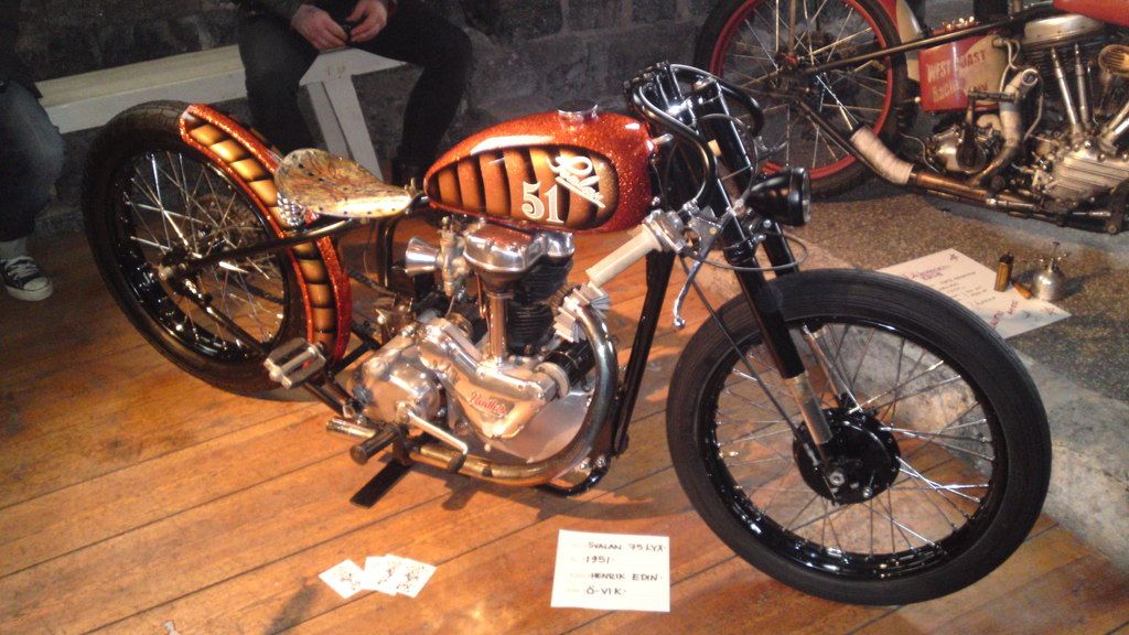

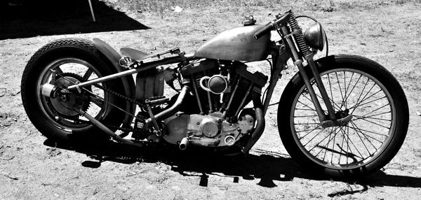

kicker Posted September 3, 2012 Posted September 3, 2012 Well whaddya know, it is factory. Anyhoo back on topic This rules faces I cant get enough of this bike Slam motorcycle version Quote
oldnrusty Posted September 3, 2012 Author Posted September 3, 2012 ^ holly shit! bad arse, yeah i love that bike ay, and im not even that big on bobbered inline 4 cyl aswel stoked i got my hands on a 2 cylinder and yeah later model ones were stock belt drive, kinda dig it ay KZs also can out with a 16 inch rear on the chain drive models, keen to see if the cush drive for the chain is the same on a belt drive but even better is that they came out with wire wheels on the early ones! Quote

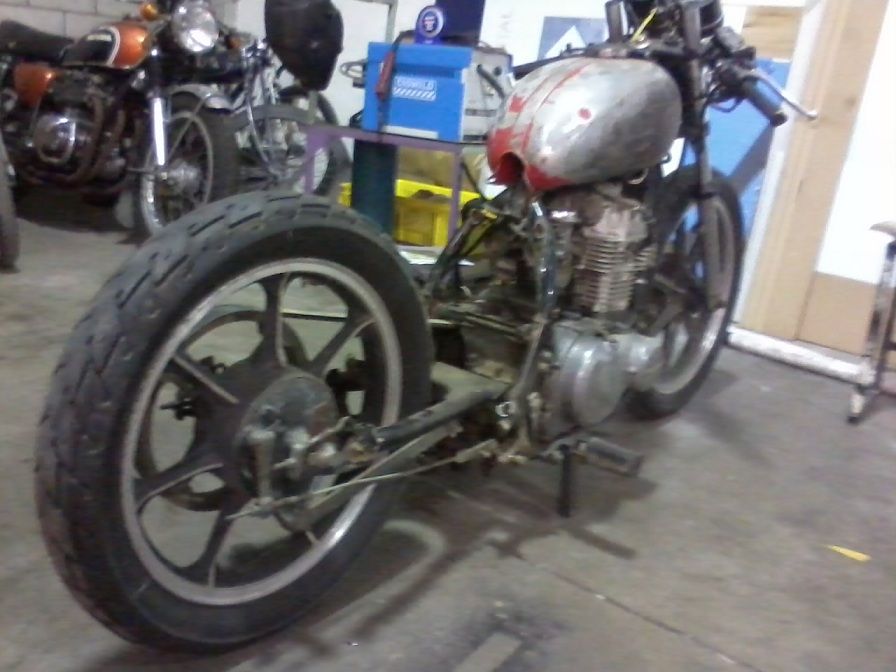

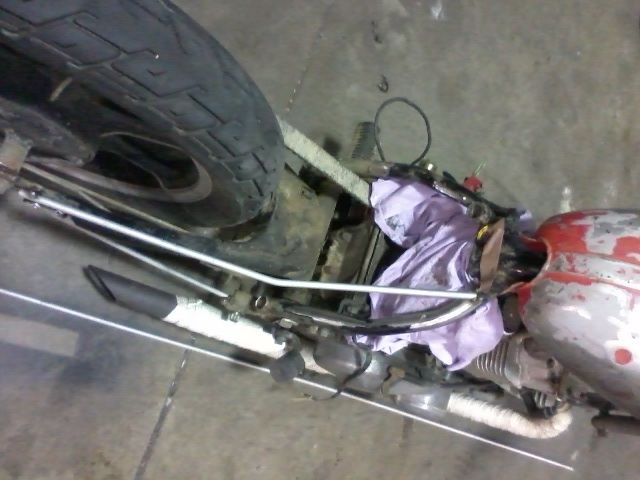

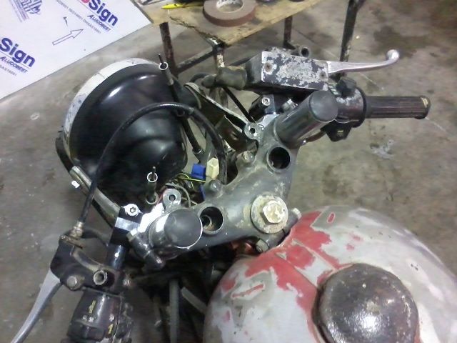

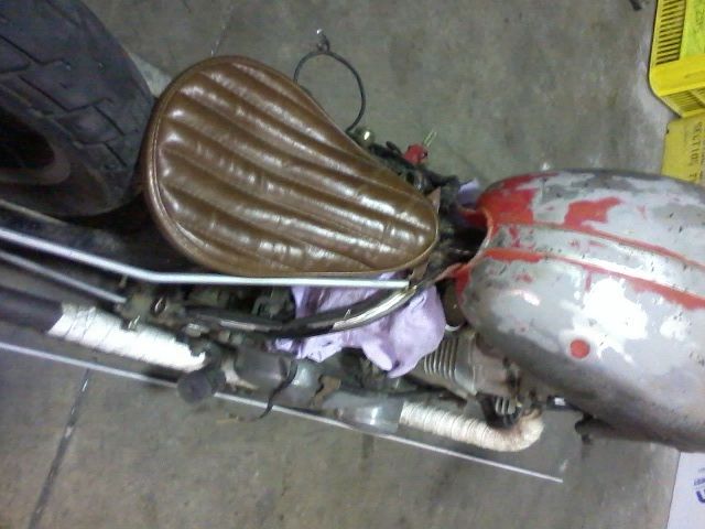

oldnrusty Posted September 5, 2012 Author Posted September 5, 2012 haha yeah man get into it!! Danny and me are doing a bike build off! He's just brought a 1977 Suzuki GS550 on wire wheels! cunt, picks it up this weekend, so ive got a weeks head start on him so last two nights, been bending up some threaded rod to mock up the rear of the frame, those and the tube i got are on there way to the engineers today, getting them mandrel bent. with the saddle on happy with the profile, note: exhaust pipe is just hanging in place, it does run on the same plane as the lower frame rail cleared up the bar cluster fuck aswel Quote
