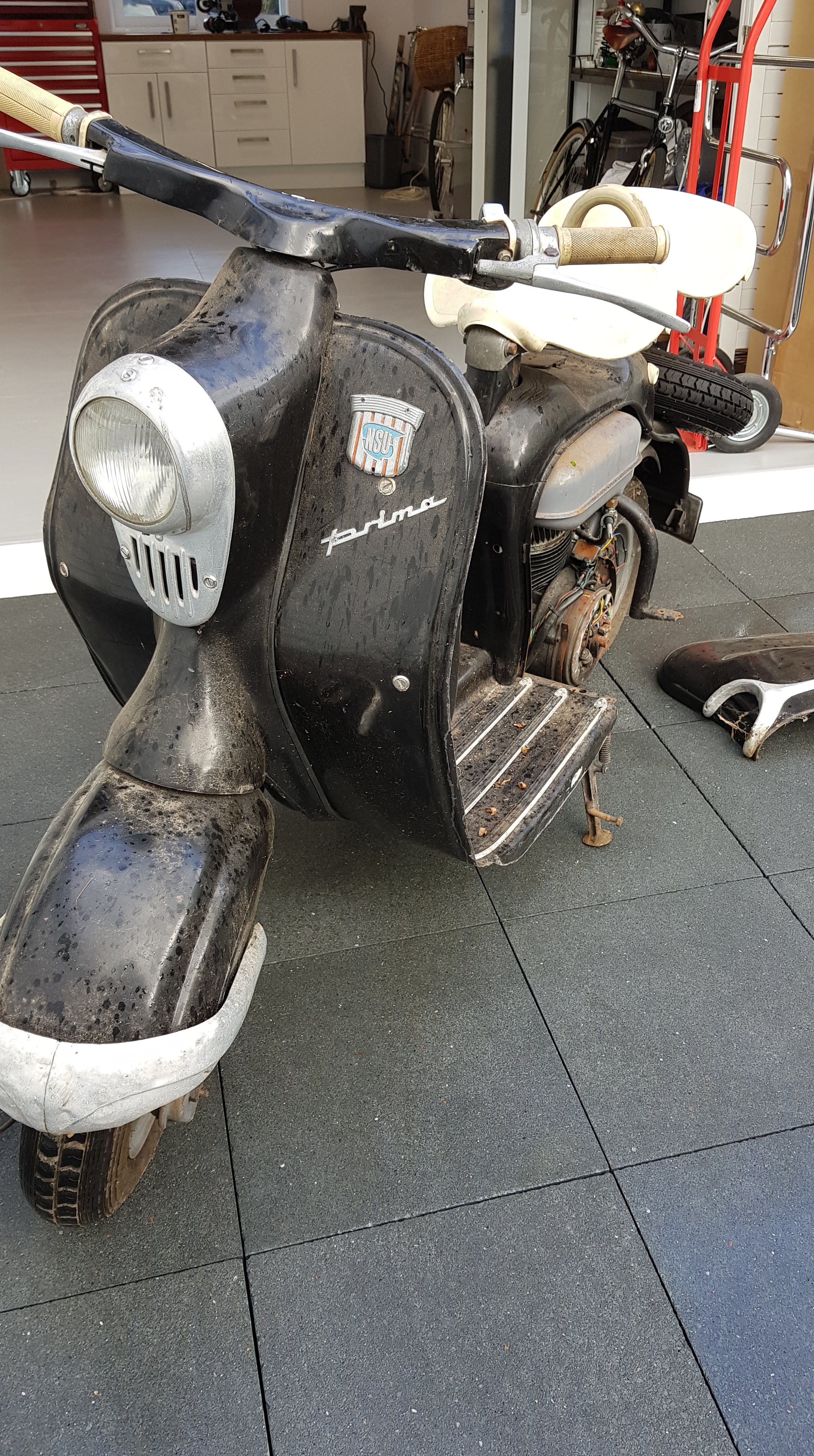

mikey Posted April 19, 2020 Author Posted April 19, 2020 Because Lockdown, I've pulled this out from the pond under the house. It's been there for about 4 years making close friends with some rust and spiders and mold. Last time I was bumbling around with it it had a couple of issues. The biggest one was the Dynastart, which is a dynamo that you can also use as a starter motor. It worked once in a blue moon, so I'd have to crash start it. So that's top of the list. Other things to fix; the front brakes lock-up when the front suspension starts compressing, this is great lols. The timing advance seems beyond repair with rust, I'd like to move to electronic ignition. The wiring/switch gear is pretty ropey. Some dust: More dust: Some rust: YAY Quote

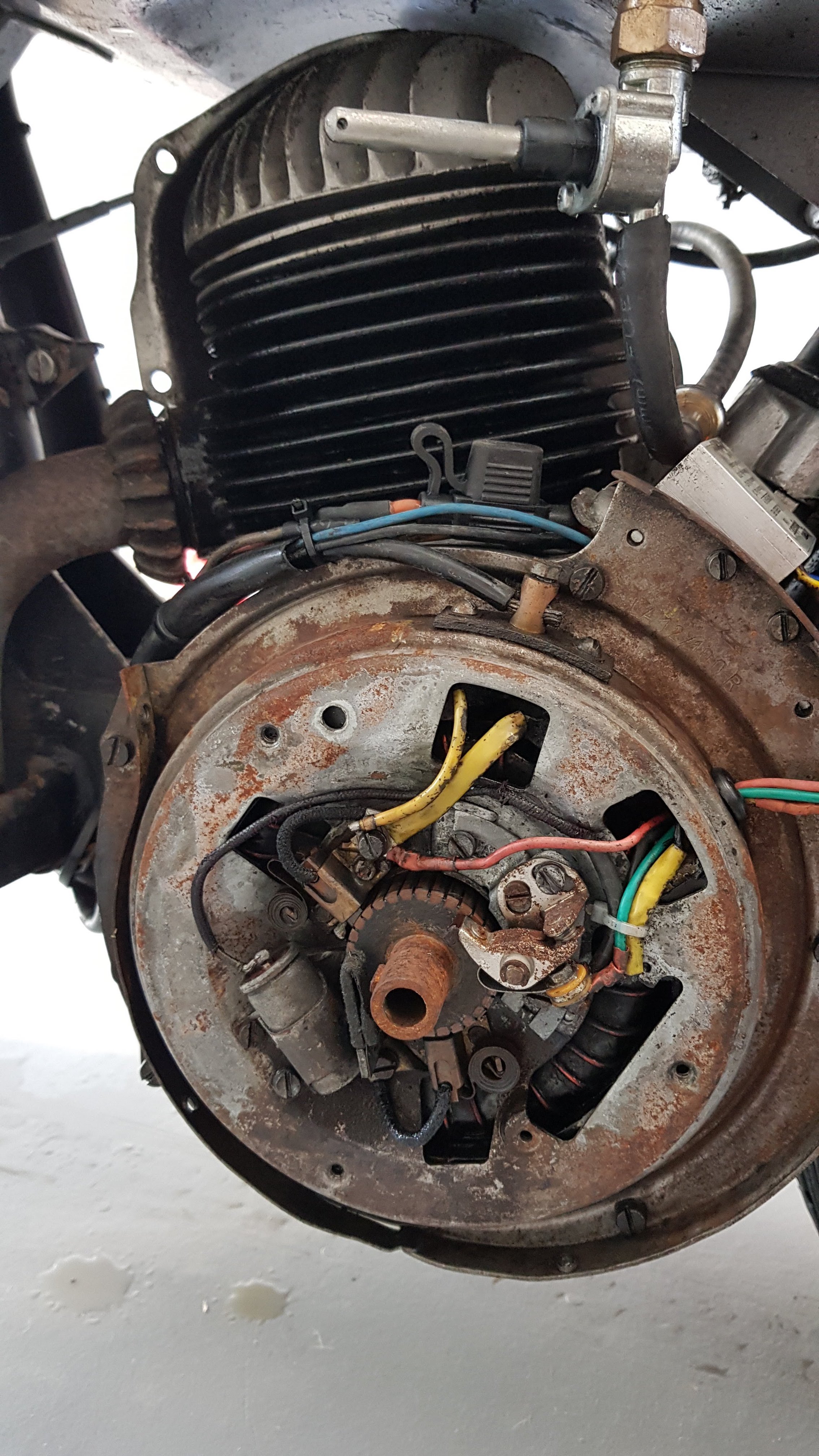

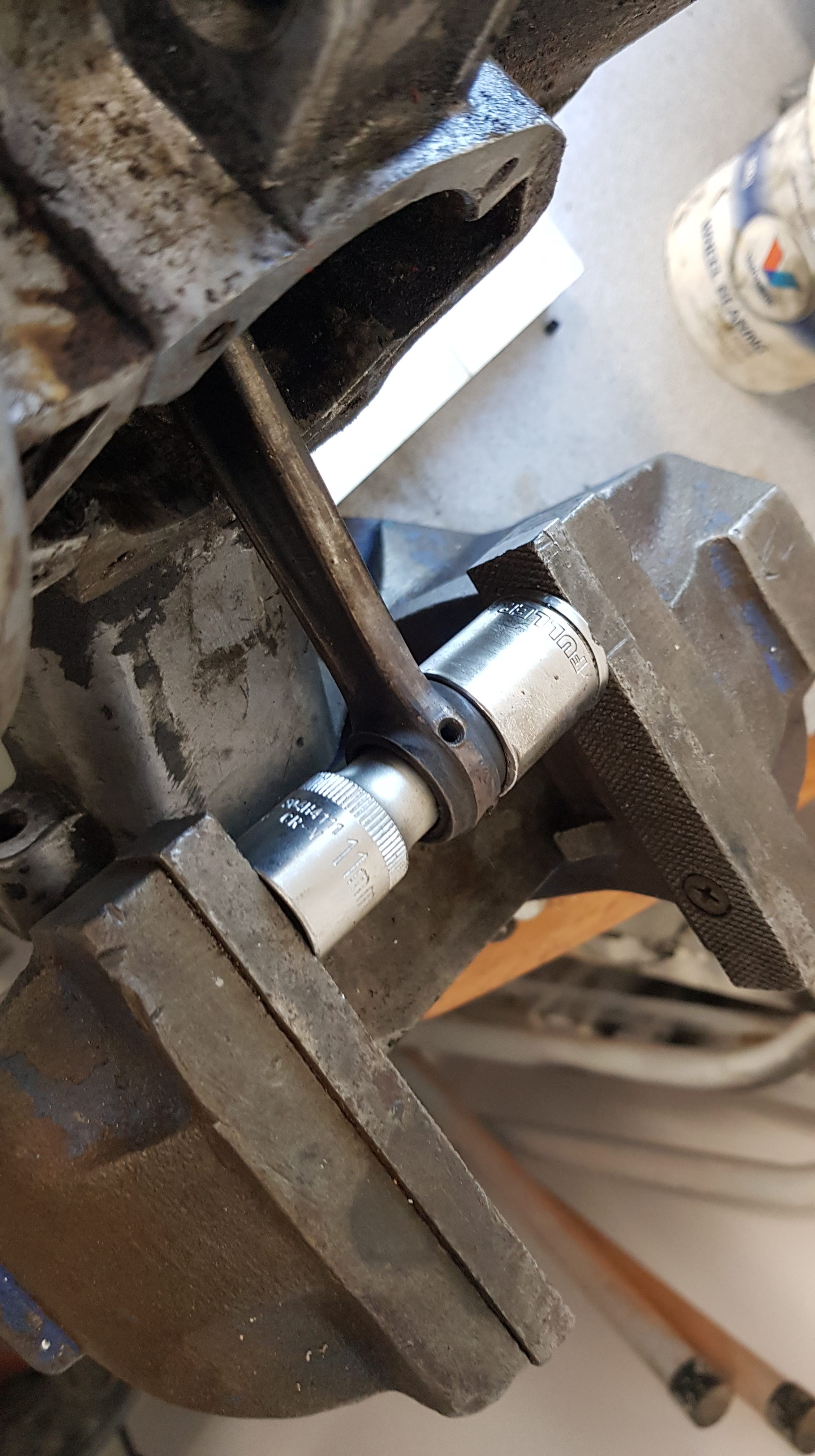

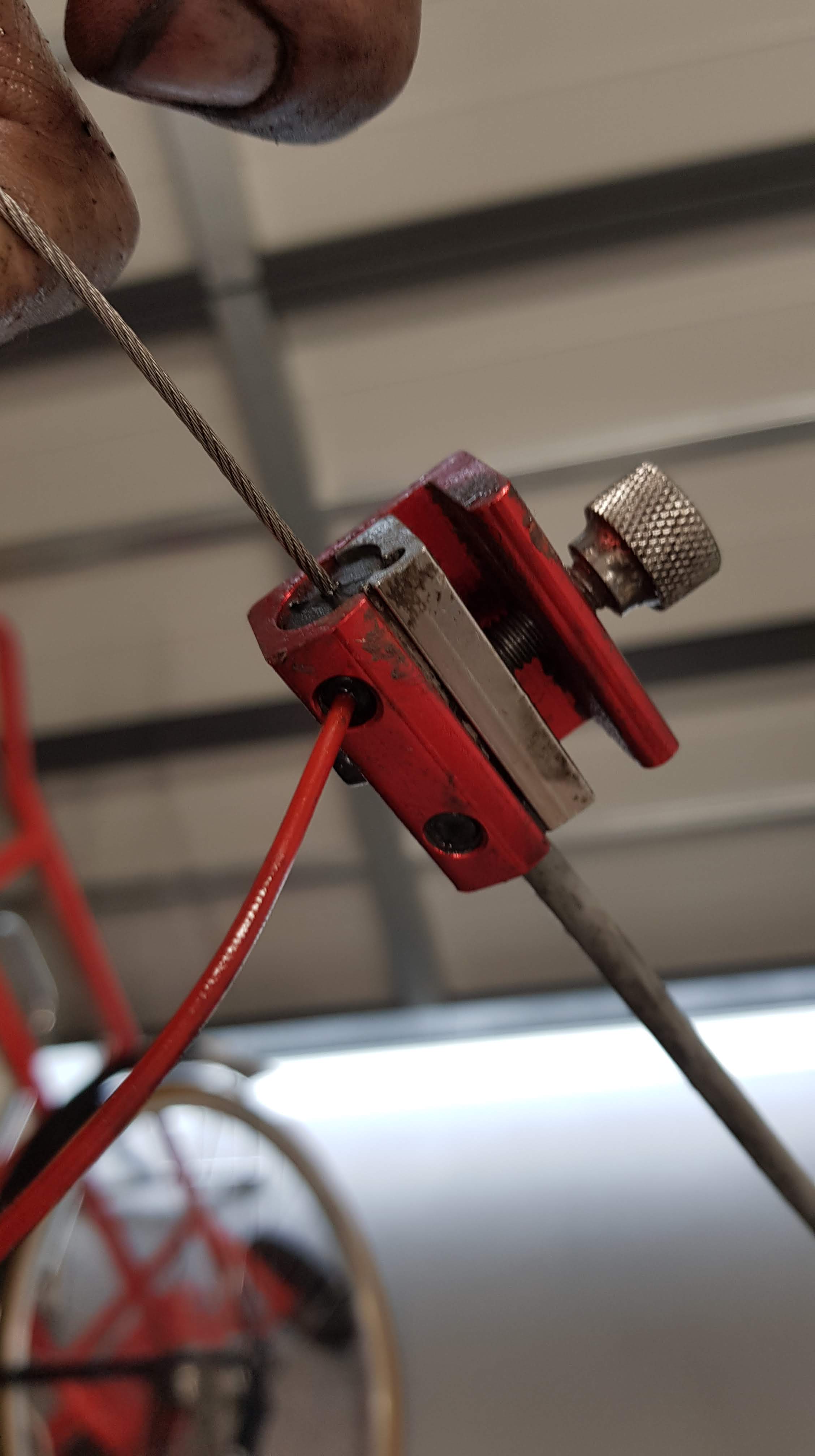

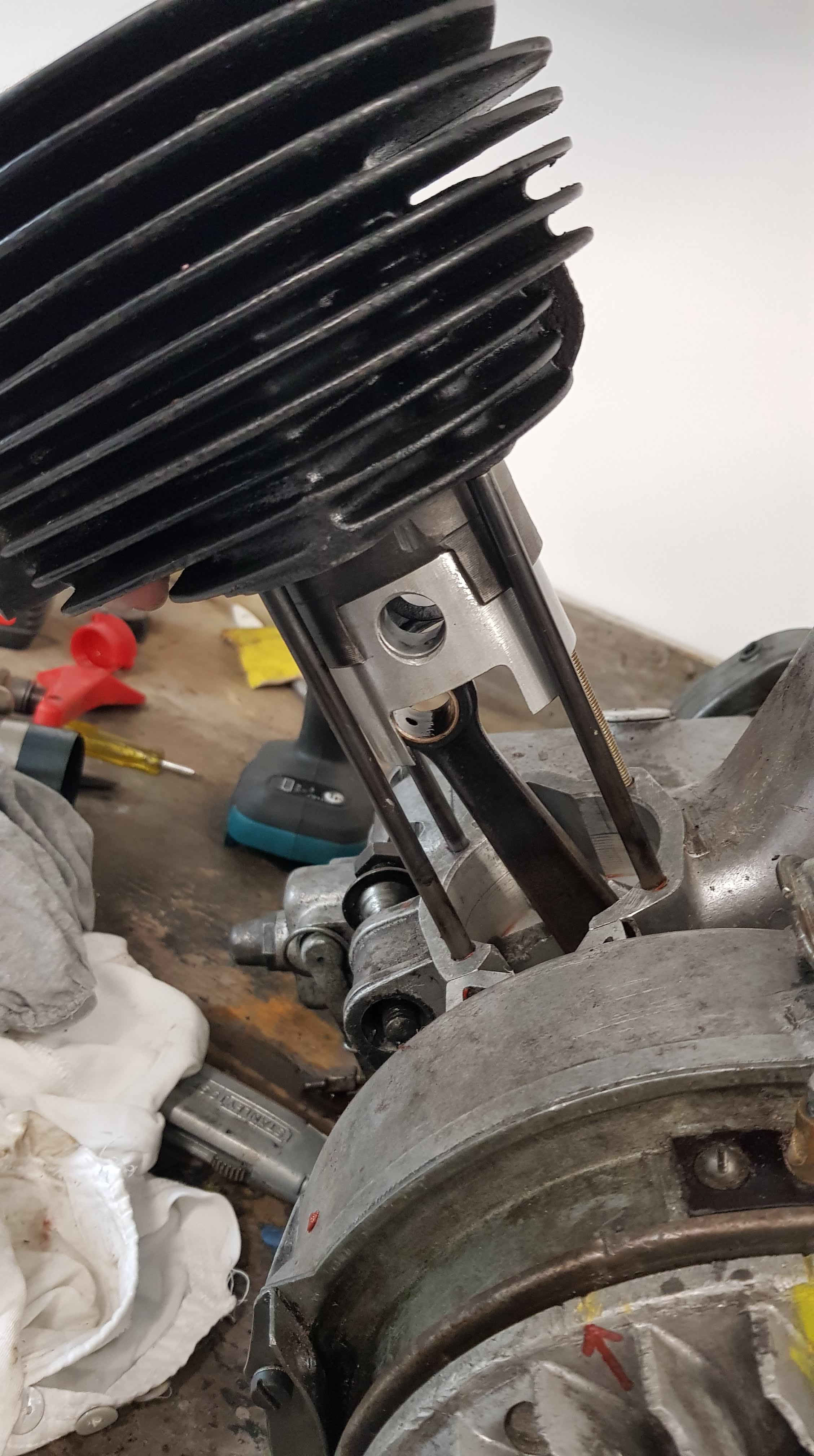

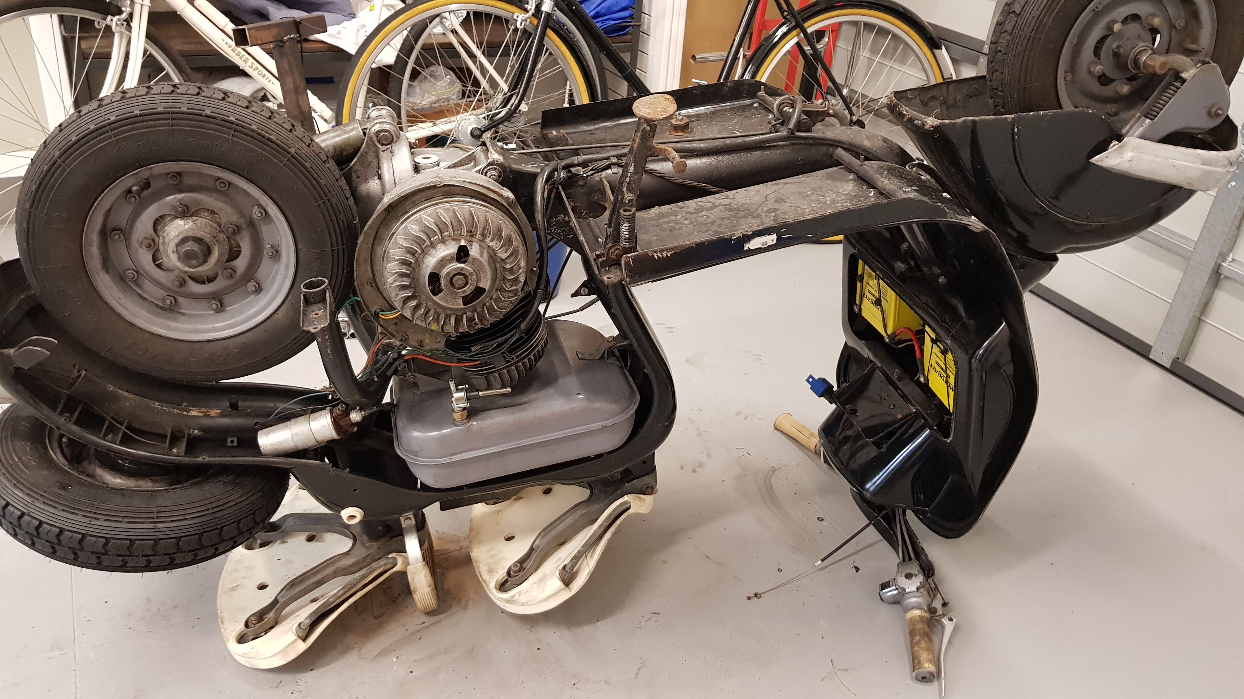

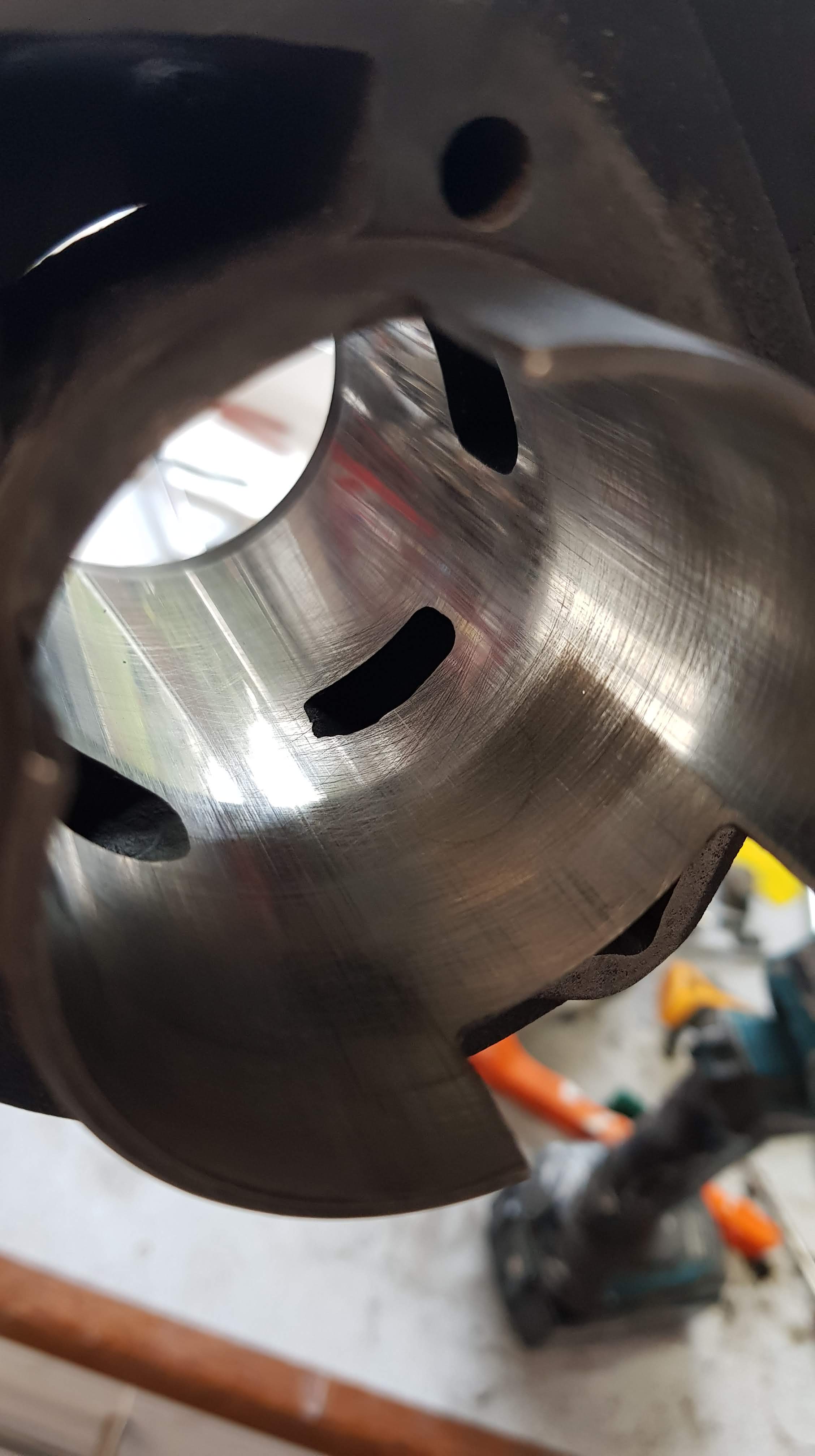

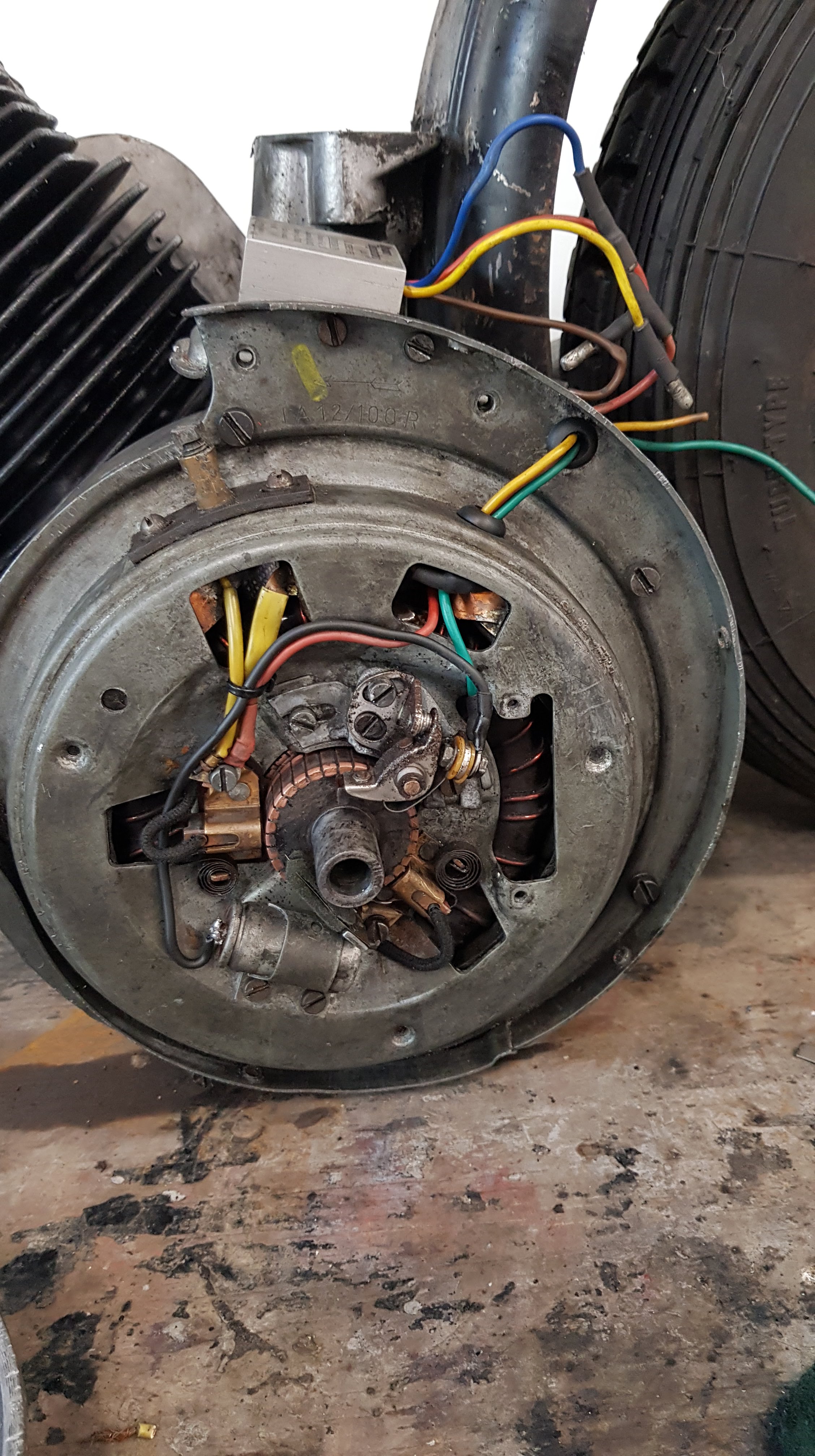

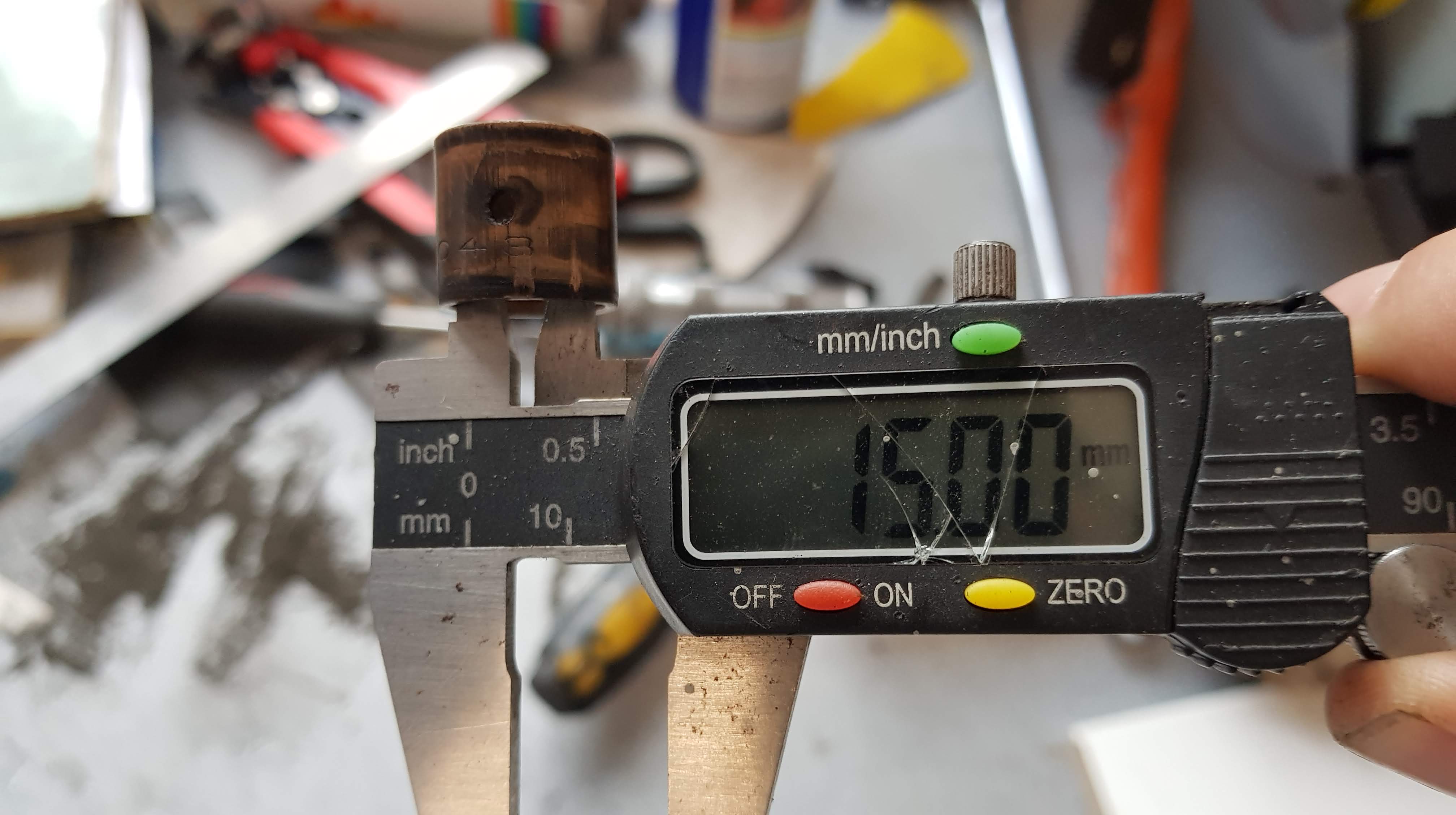

mikey Posted May 5, 2020 Author Posted May 5, 2020 So. Pulled the Dynastart field windings apart and found they were oil soaked & shorting to ground. Tidied up, replaced all wires & bushes & sorted out the rust. The points look a bit shit, but the contacts are basically new. I fixed up the auto-advance too, so will stick with points for now. I could feel a bit of "backlash" in the flywheel, turned out to be a shagged small end bush. Spare parts are hard to come by, but I had a spare engine so recycled the bush out of it which was still in spec. A bit agricultural, oh well. Bore is okay. Getting the engine in is fricken impossible, it weighs a tonne and she's a toight fit. After a lot of sweat and swearing I found doing it upside-down is more doable. Gear change bowden cables were bunged up, lucky I have a luberer Went for a blat round the block and pumped up the tires. The engine feels good. The front brakes are still terrifying. And I can't find third gear, that's always been a tricky one. Will make new cables, but I actually think the mechanism is from a different bike. Quote

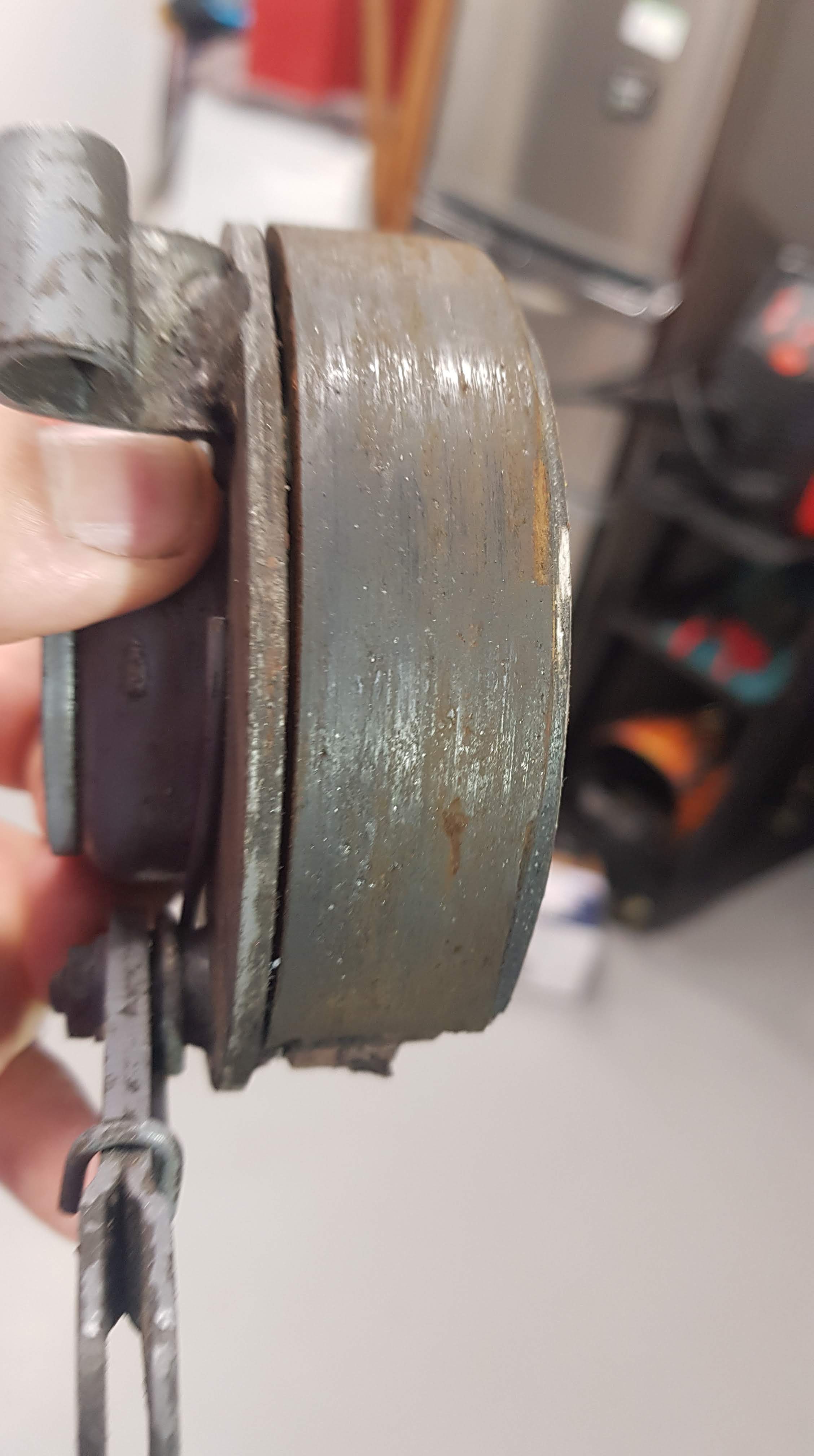

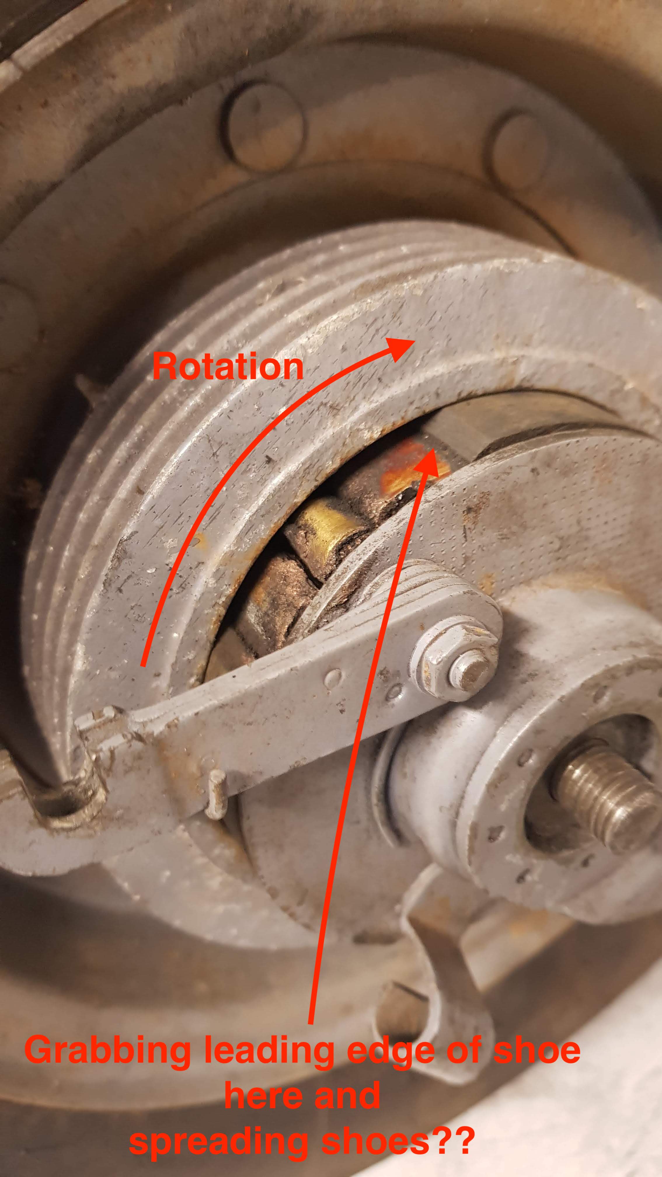

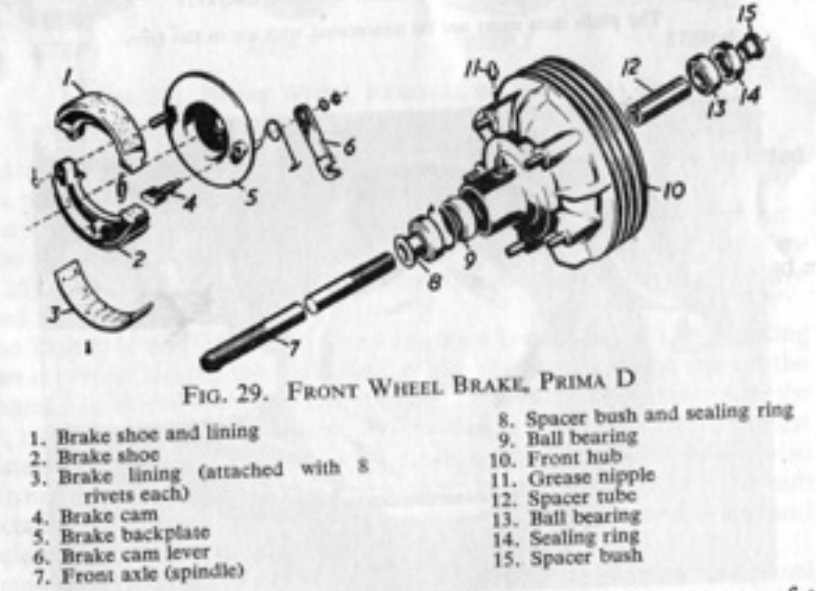

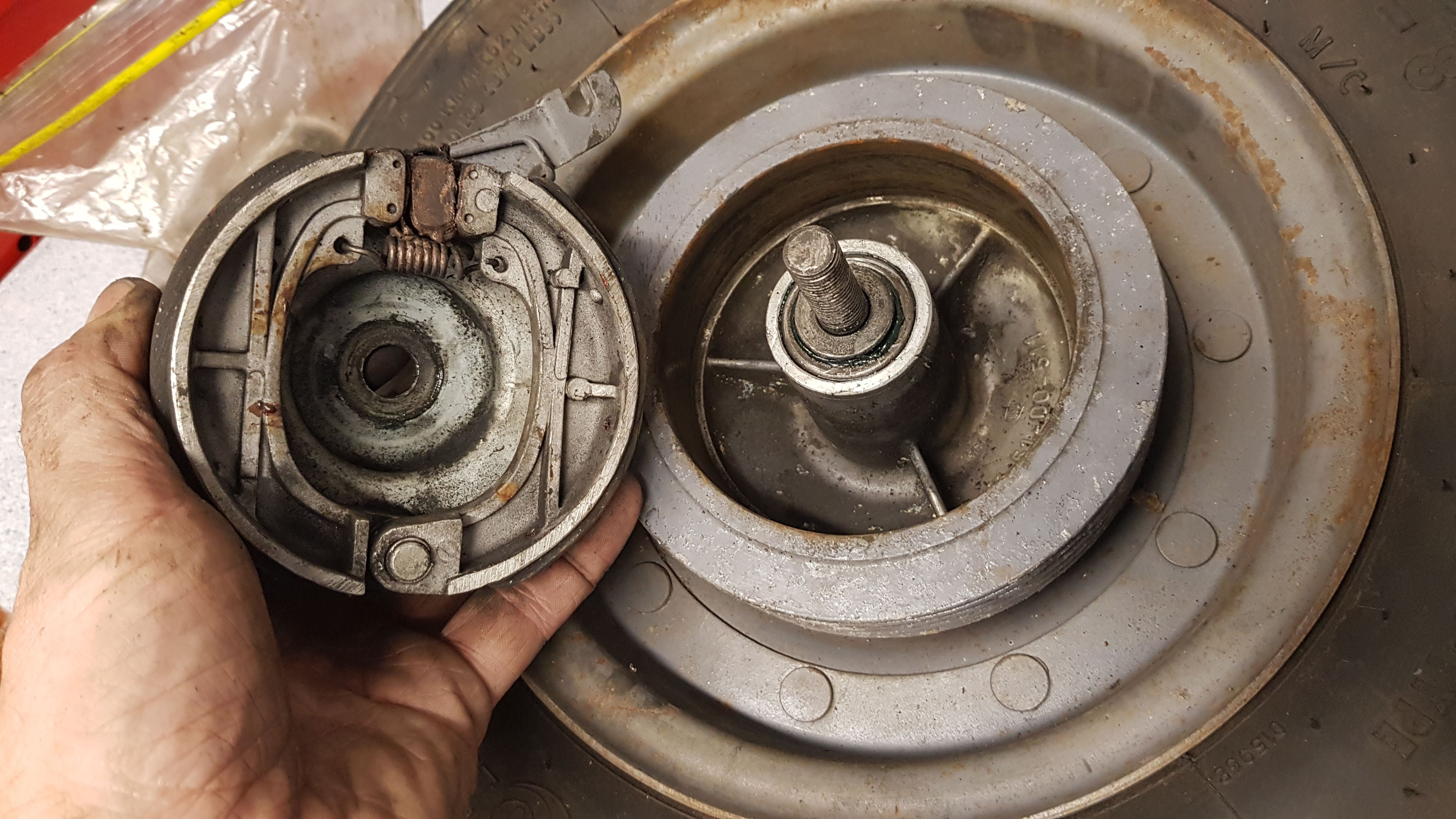

mikey Posted May 7, 2020 Author Posted May 7, 2020 So.... dem brakes. They look simple enough, but something ain't right. With a light touch on the brake lever they grab hard and the front springs bottom-out violently. This is all the tech info I have. I suck at drum brakes. I really really do. HALP!! There's no signs of anything weird from what I can see. All I can think of is that maybe the drum grabs the leading edge of the shoe and spreads the shoes so they grab harder? Quote
mikey Posted May 7, 2020 Author Posted May 7, 2020 Oh, those pads were replacements put on by Sterling Brake & Clutch about 9 years ago. The original ones are riveted, these are bonded. Quote
xsinclairx Posted May 7, 2020 Posted May 7, 2020 I’m thinking the shoes might be as close as possible but not the right ones? Quote
mikey Posted May 8, 2020 Author Posted May 8, 2020 It was as simple as glazed shoes I just hit them with a Scotch Brite pad and brake cleaner and now they feel great What a muppet. I figured glazed shoes would cause the opposite of grabbing, which is why it took me so long to work this out Quote
