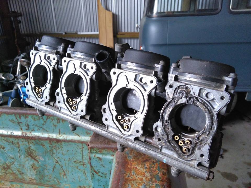

dmulally Posted October 25, 2018 Posted October 25, 2018 Hi All, I have some bike carbs that I want to put on my 1725cc rapier engine for my commer. Basically they are the only thing I can fit under the seats of my commer. I wanted some DCOE's but it looks like too much of a pain to fit them. They are 34mm carbs from a Honda 600. They have a 1.5mm main jet. I'm about to make the manifold and have a question for those who are smarter than me. What angle should I set them at or it doesn't matter? I note on the bike they nearly point up. Also, what are the arrows pointing to in the picture? The big one top center seems to push the black choke things up when I blow on it. No idea what the two are next to it. I'm guessing the two lower ones are fuel lines. Of which I have the fuel pump from the bike. Any help is appreciated. Cheers Damo 1 Quote
peteretep Posted October 25, 2018 Posted October 25, 2018 hey man, 90% sure the big one in the middle is connected to all the carbs, and the area above the slides. On a bike they are connected to the airbox and when that is under vacuum they open up more. For a car, especially a lazy commer motor, your engine wont increase rpm anywhere near as fast as a bike, so that can be blocked off. There will be a small hole on the bottom of the slide that 'sees' the air going past and creates a vacuum which pulls the slide up. If you dont block it off, the slides will likely 'flutter' as the revs increase, wont do much but can look and sound weird For the smaller black lines, I am going to guess and say they are fuel overflow lines, typically they have little hoses that run away from the rear wheel on a bike, they can probably be left in your situation unless they will chuck fuel out onto the exhaust or something I think you are a right with the lower hoses, and that they are fuel inlets, although its a bit weird having 2 inlets, but that could be because of the layout on the bike For setting the angle up, I would aim to have the float needle in the vertical position, this is likely perpendicular to the bowl flange, so keep the bowl flange level and you should be about right, but check the float needle first. It is probably set up steeper on a bike due to the fuel moving backwards when the bike is accelerating which would create a false level I imagine that you will need to jump up a few jet sizes, but a 1.5mm should be OK to run as is for a short time You should get a carb balancer to set them all up, just takes 10 mins, and when setting up the needles, start from the top and keep lowering it until fuel stops visibly dribbling out at idle also, have a look on en.impex-jp.com for spare bits for your carbs, and watch out when undoing the phillips screws not to damage them and be careful with the gaskets 1 1 Quote
dmulally Posted October 25, 2018 Posted October 25, 2018 Thanks buddy. I might see how hard it is to pull them apart and take the sliding choke plates out. I tried to find where to plug so they stay open but nothing obvious was glaring at me. Much appreciated. Quote
