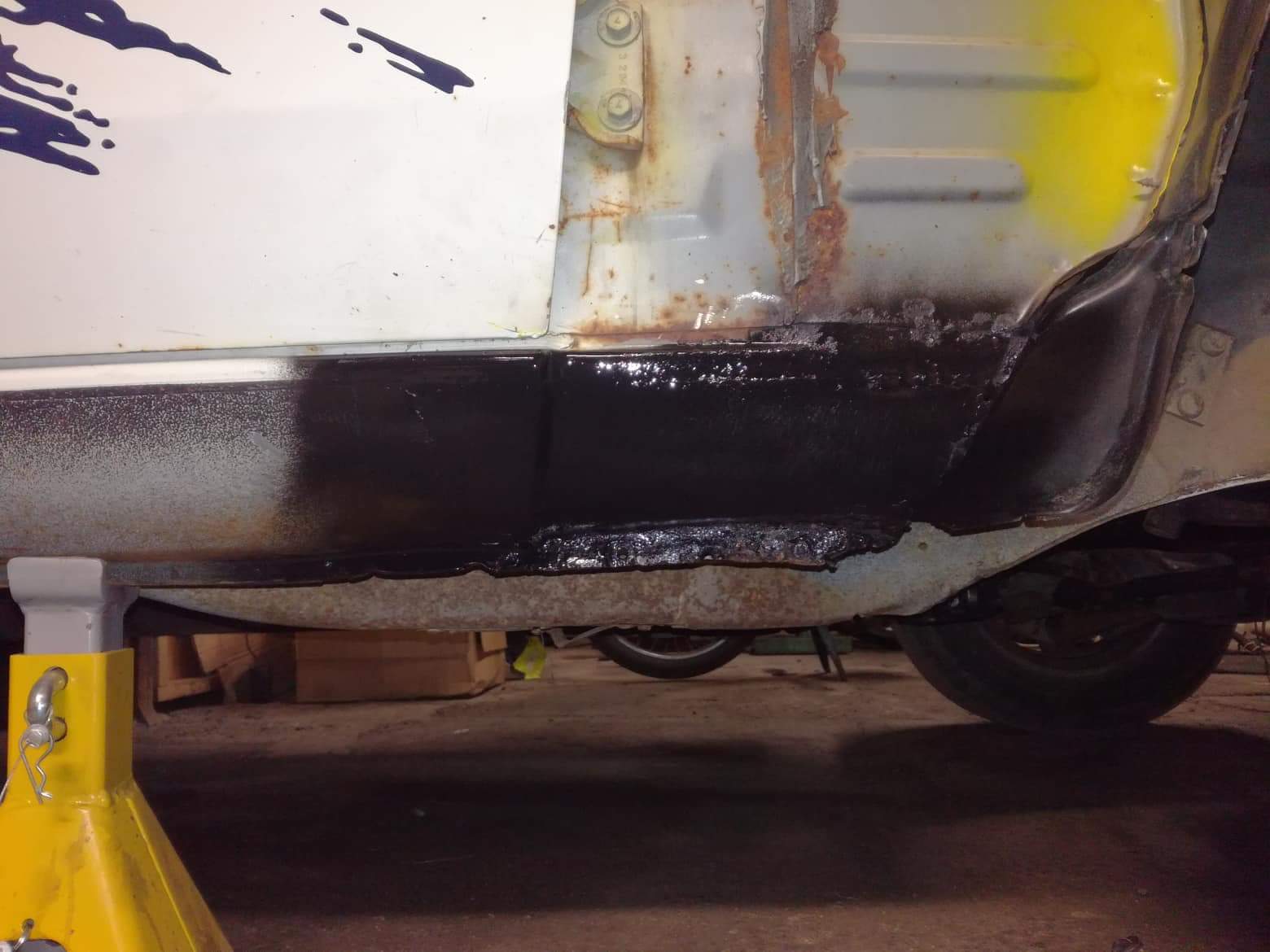

JustHarry Posted August 10, 2018 Posted August 10, 2018 Fixed the driver's side sills this evening Parts car had a rust free boot floor Ready to weld tomorrow  1 Quote
