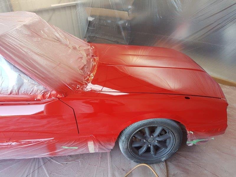

Now the caveat here is that I'm a mechanic, not a body work or paint guy but I think I done gone did alright if I do say so myself Flat sanding and buffing the car didn't quite go so smoothly, I managed to buff through a few spots with the woolen pad(my old man later informs me that he shouldv'e given me the foam (pleb) version instead And from this point is where it all went a little pear shaped (and I stopped taking photos) Because I'd run out of red I needed Dad to get me some more for the touch ups, now I sent him a photo of the label on the paint he had originally got me. He brought out a 250ml tin, took the lid off and checked it against the car "yep thats it" (he was originally an autopainter by trade, so I made the mistake of believing he could still see colour) I prepped all the touch up spots and gave them a lick of colour. Now somehow I managed to pull off spraying all the touch ups perfectly, no runs, no dusting, good coverage, excellent! buuuut after the paint dried I had a some very orangey red spots on an otherwise red car..... Out came the D/A and off came the paint. Now on my second attempt with the correct Red I think the rag I was using to wipe down the car must have had some sort of contamination because nearly all the repairs fish eyed in spots. I've sanded and buffed most of them good now but my motivation at the time was quickly waning. I ended up repainting the entire boot lid twice because the first attempt fish eyed badly and that is pretty much where motivation cease. The bootlid still needs to be rebuffed when I find some CBFs. In binning the Ironmask front from this car I decided to try out the Wagon quad light set up. I had to trim the chrome off the bottom for it to work with the kouki bumper I have since painted the front bar, grill and all the side trims in black as well, I need to find a better facelift rear bar as mines pretty out of shape (anyone?) Oh and @Brdflu lent me his front lip, of which I repaired and made a mould This Is also now black. Anywho, thats enough spamming from me, hopefully I summon some motivation and get back into it, otherwise I'll see you all in 2 years Discussion, advice and suggestions welcomed: https://oldschool.co.nz/index.php?/topic/57362-beaubots-1982-er30-skyline-sedan/

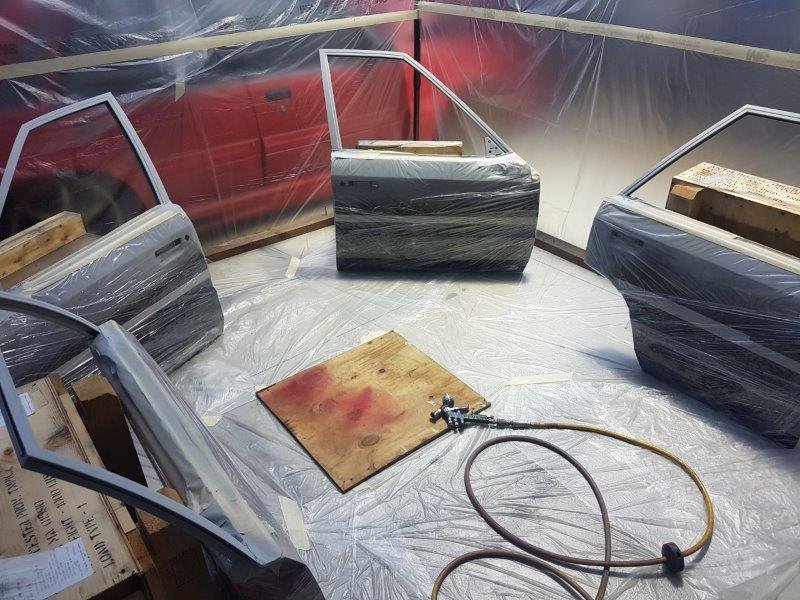

Doors were up next, started with the shuts, gave the lower halves a lick of black along with the window frames. Chuck all the panels back on for a looksee, and a quick sand Next up, I moved everything in the shed and knocked up a makeshift booth using some steel cables and plastic drop sheets and had a crack at the doors and nose cone I didn't mix up quite enough paint to get two full coats on everything, so I had a few dusty spots on the RH doors. On another note nothing attracts bugs like fresh car paint, landed right in the middle of the RHF guard, whats a little more sanding. So for my next trick I went all in, mixed the remainder of the paint and took the gun to the whole car. Discussion, advice and suggestions welcomed: https://oldschool.co.nz/index.php?/topic/57362-beaubots-1982-er30-skyline-sedan/
