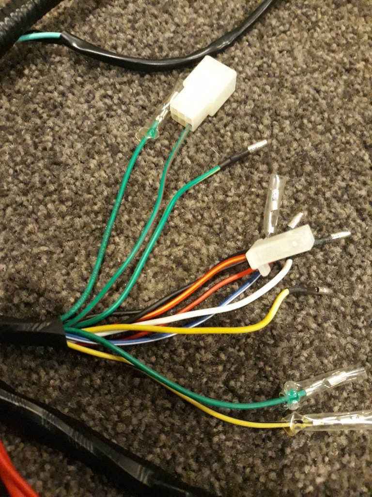

Pics for reference. Loose wires is engine end. Other is CDI module plug.
Evening all. I bought one of those chong lifan engine kits to re power my C50. Its a 110cc auto clutch job. Im well stuck with the wiring though. The motor package came with a loom that looks like its a complete loom off a chinese scooter. Im wondering is there any way I can graft it into the existing C50 loom? The new motor has 6 wires: Red w/black stripe Blue w/white stripe Green White Yellow Turquoise w/red stripe - neutral light? The bike has white, yellow, black & turquoise/red. I have the cdi module & coil but the wires in the lo
