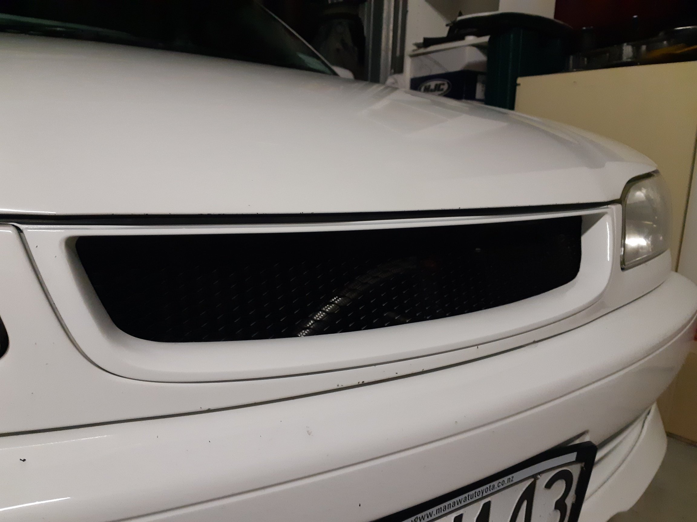

CorollaGT Posted November 20, 2020 Posted November 20, 2020 This was a project from back in April's lockdown. Cut apart a stock grille and fibreglassed it up. Foolishly never took photos of it without filler or paint. 1 1 Quote
